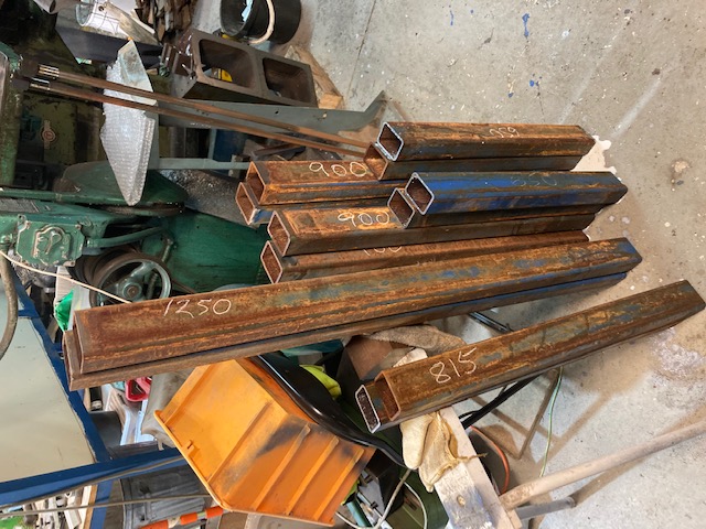

Made a start tonight by getting the steel for the table frame cut to length:
Also had the prox sensors turn up, but I managed to order the 8mm diam ones instead of the 18mm
Is that likely to cause any issues?
Steve

- Posts: 12158
- Thank you received: 4150
08 Jul 2021 10:11 #214018
Replied by rodw on topic Downunder 4x2 build
Ahh, I missed the CNC option. Not one I was familiar with.
I don't think the size of the sensors will matter. I used 12mm ones.
PNP is preferred with Mesa cards...

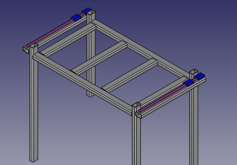

This is what I've got planned for the main frame construction.
I thought about putting the rails on the edge, but looked like alignment would be harder and more likely to get screwed up by any distortion during welding.
I'll fit a sheetmetal cover over the sides to stop crap getting on the rails.
Belts will run under the RHS to protect them.
Steve

- Posts: 12158
08 Jul 2021 12:44 #214025
Looks a good start. And a good layout to keep rails clean. I did devise a way to mount the rails on the side but it cost me about $800 in custom laser cut mounting rails! Yours should mean you have a shorter, stiffer gantry ends too.

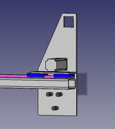

Started tacking up the frame today, but not enough progress to warrant a photo. The 75x50x5 RHS is complete overkill for such a small table, but I guess some mass in the frame won't hurt - and at less than $50 total the price was right
Finished modelling up the gantry supports and drive setup. Apologies - but modeling up the belt was beyond my minimal CAD skills, but it runs over the idlers at the top, then loops down around the drive pulley. 3:1 reduction (20T/60T) between the stepper and drive pulley.
6mm steel for the supports, with the horizontal plate welded on. Thinking that if I bolt them to the linear rail carriages then I should be able to get the gantry beam in place and trued up, then weld it to the supports.
Planning to drill and tap the side plate and bolt the idlers to it with some spacers. Haven't decided on a shaft/bearing arrangement for the drive pulley yet.
Can anyone recommend a good size/style of drag chain for a small table like this? And is there a rule of thumb for how much chain is needed?
Steve

- Posts: 21995
- Thank you received: 7488
09 Jul 2021 14:55 #214115
Replied by tommylight on topic Downunder 4x2 build
20 to 40% more than half of the movement depending on the bend radius.

10 Jul 2021 10:38 #214172
by OxxAndBert
Replied by OxxAndBert on topic Downunder 4x2 build
Thanks Tommy.
Glad I asked as I was thinking it would be a bit more than the full length of movement. Obviously a newbie here!
I've ordered a couple of 1m lengths of 25x77 size.
Got the table frame welded together today.
Haven't added the supports for the rails yet as I'm thinking it might be better to bolt them on to make initial alignment easier, then tack them in place to prevent any further movement.
I looked around the shop for some 6mm steel for the gantry side supports, but only have 5mm and 12mm. The 5mm should be stiff enough - I can always add some gussets later if it does flex.
Steve
