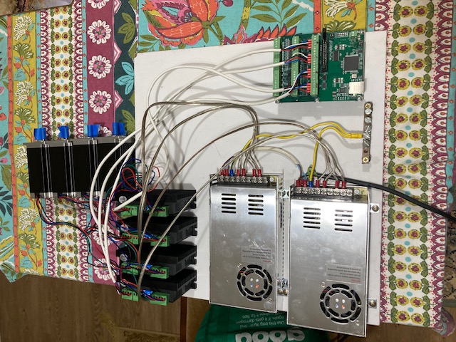

13 Jul 2021 11:53 - 13 Jul 2021 11:54 #214556
by OxxAndBert
Replied by OxxAndBert on topic Downunder 4x2 build
Thanks Tommy - that was my line of thinking too.
Bit more progress tonight...
Dragged out the old PC that I installed LinuxCNC (Debian10) from LiveCD about 6 months ago.
Connected it up to the 7i96, powered on, configured the network interface and can ping the Mesa card.
Powered up the drive power supplies - all green LED's and no smoke.
Looking good so far
Ran PncConf, flicked through a couple of the pages - and decided I have no idea where to go next!
Time for some more reading I think.....
Steve

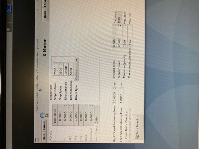

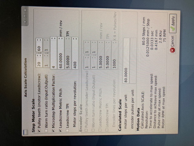

Done LOTS of reading, watched a few videos, run an AXIS simulation, run PncConf to configure a tandem Y axis, and X/Z.
Even ran the "LinuxCNC" file and got my steppers to move, but they were moving sooooooo slowly that I didn't even notice at first that they were moving at all.
Tried to set the axis config to more reasonable values, but now its not moving at all and I can't work out how to replicate what I had earlier!
I'm a complete newbie to steppers, microstepping etc, and not getting my head around how it all hangs together and what I need to set in the PncConf wizard.
Anyone give me a sanity check on these values:
Drivers are DM566T
From the wiki page on stepper drive timing:
StepTime:2500 StepSpace:2500 DirectionHold:10000 DirectionSetup:5000 StepsOn:Rising Edge
Out of the box the dip switches are set at 1600 pulse/rev
In the axis scale calculator I have set:
Pulley Teeth 20:60
Leadscrew metric pitch 60mm/rev (20T gear and HDT-3M belt)
Motor steps per rev 400
Microstep multiplication factor 4
Steve

- Posts: 21880
- Thank you received: 7461
14 Jul 2021 14:54 #214750
Replied by tommylight on topic Downunder 4x2 build
Second picture, set step to 5000 both and dir to 20000 both .

15 Jul 2021 09:52 - 15 Jul 2021 09:53 #214830
by OxxAndBert
That's worked, and I now have steppers that do a few turns
Thanks so much Tommy - you're a legend!!
Were those numbers just from experience or should I have been able to work them out somehow?
I've realised I miscalculated somewhat, as I was planning to run my prox sensors off the same 36v power supply as the steppers - but overlooked that the 7i96 can only handle 24v for TB3 inputs. I should have bought the 5v version of the sensors and I could have used the one 5v power supply for both the board and the sensors/switches. I'll have to dig out an old PC power supply with both 5 and 12v I think...
It seems a bit pointless connecting up all the sensors etc on the bench before they are mounted to the machine, so unless there's something else worthwhile at this point I'll just make sure I've saved that working stepper config and get back onto the physical build ??
Steve

15 Jul 2021 12:11 #214853
Those values are about the minimum for making sure the drives are working properly, they can be changed later but i would leave it as is. The values given by some drive manufacturers are mostly off by a lot.
Old laptop power supplies are very good and very cheap, i use them a lot as i can get them for 15 Euro each. See if you have one...
You should connect one sensor and make sure the wiring is OK, also helps later a lot knowing what goes where and how to set them up.
