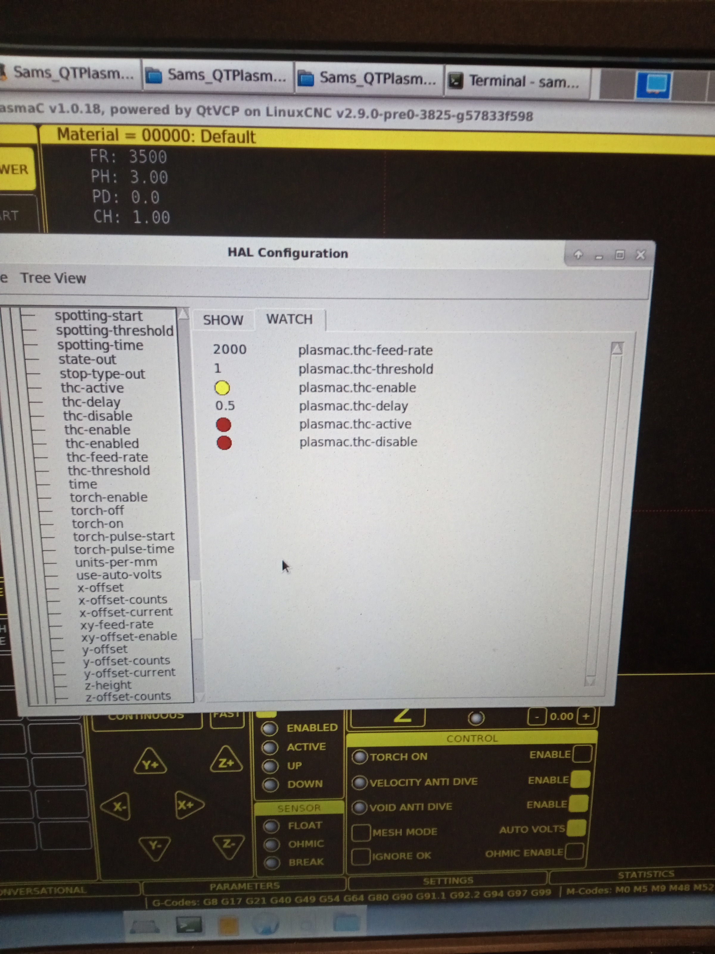

can you check the value of:
plasmac.thc-feed-rate
- samforsey12345
- Posts: 29
- Thank you received: 12
01 Feb 2022 23:02 - 01 Feb 2022 23:02 #233756
by samforsey12345
Replied by samforsey12345 on topic THC - out of ideas
Hi Tommy these are the plasmac.thc values.
I'll try and see if it enables when doing a cut if that would help at all.
Thanks folks
Sam
Thanks folks
Sam
Last edit: 01 Feb 2022 23:02 by samforsey12345.
- Posts: 21985
- Thank you received: 7484
01 Feb 2022 23:13 #233758
Replied by tommylight on topic THC - out of ideas
That is perfectly fine.
Now monitor the:
plasmac.thc-active
during a cut, see if it does turn on.
Now monitor the:
plasmac.thc-active
