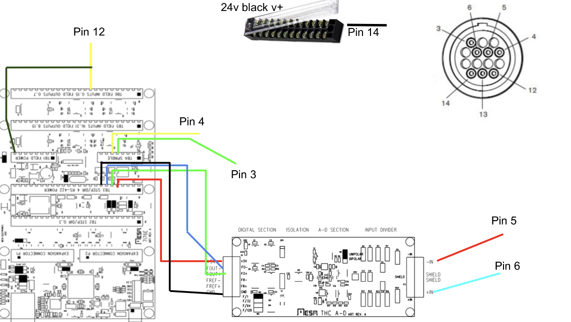

7i76e. I don’t have any of the hardware yet. I am trying to make sure I have absolutely everything right with my wiring and my configuration. Since this side of the machine doesn’t come naturally to me I don’t want to do what I’ve done in the past and wing it when I get the materials.

For Mesa 7i76E, pin 14 to +24V, pin 12 to input.
No need for resistor.

The use of a pullup resistor is discussed int he qtplasmac docs.
The current passing through the 7i76e (from an input to ground) is way below the minimum current of the internal Hypertherm relay so not using the resistor could see oxidisation build up on the relay contacts and result in intermittent operation over time which will prevent you from cutting.
The resistor allows some current to bypass the 7i76e to ensure that the minimum current of the relay is respected.

This is bad advice. Read up on it in the qtplasmac docs and follow one of the recommendationsNo need for resistor.

It is bad advice becasue it does not reference the documentation. There is a chapter about this issue.
linuxcnc.org/docs/devel/html/plasma/qtpl...html#qt-contact-load
Let the user make up his mind.
There have been enough people caught with this issue on the forum to add a component costing a few cents for a defensive circuit design.
Sure, he may never have an issue if its left out but its a very painful place to be if it bites.

The thing is plasma machines don't last forever so you might have several cutters on your table over the years. I've had 2 and will probably be running a third shortly. These machines might have different characteristics so for the sake of 10c, why not do the job properly? By the time you need it you will probably have forgotten the possible cause is the shortcut you took years ago..
Its nothing about the table you build or how many you've built. its the plasma cutter you use.
