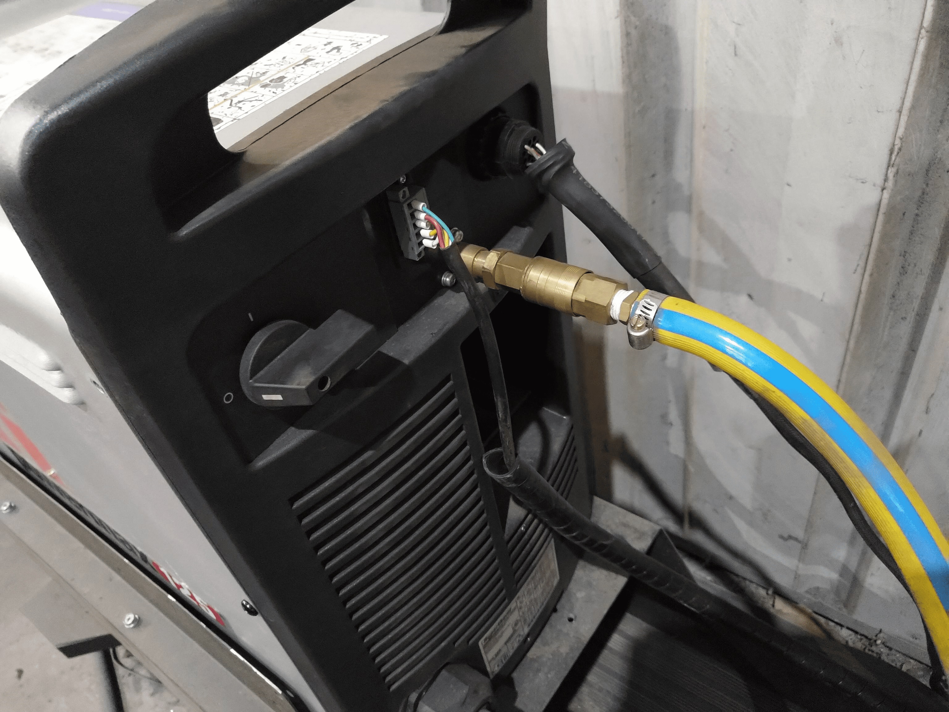

The Hypertherm RS485 interface will come with a connecter for the machine. You need a a 5 core cable and a RS485 card for your PC. I tried using a USB to RS485 adapter with little luck. You might have better luck if you decide to go that way.
For me it was plug and play once I had my wiring correct and had the correct port selected. Phil developed a tool for me to test the comms and I used that to find the correct port.
Replied by thefabricator03 on topic RS485 For Hypertherms
I see on the plasmac update that is a Powermax communication. When we will see a how to manual for beginners? It will be very useful. I have a Powermax 45 and i intend to buy a rs485 comunication interface from Hypertherm. Is any other method to manufacturing an rs485 communication card for Hypertherm ?

Phil, When I get a minute I will post my wiring diagram for the RS485 cable and if you could include in your manual to help others with their cable wiring.
The wiring was the hardest part of of getting the RS485 to work.

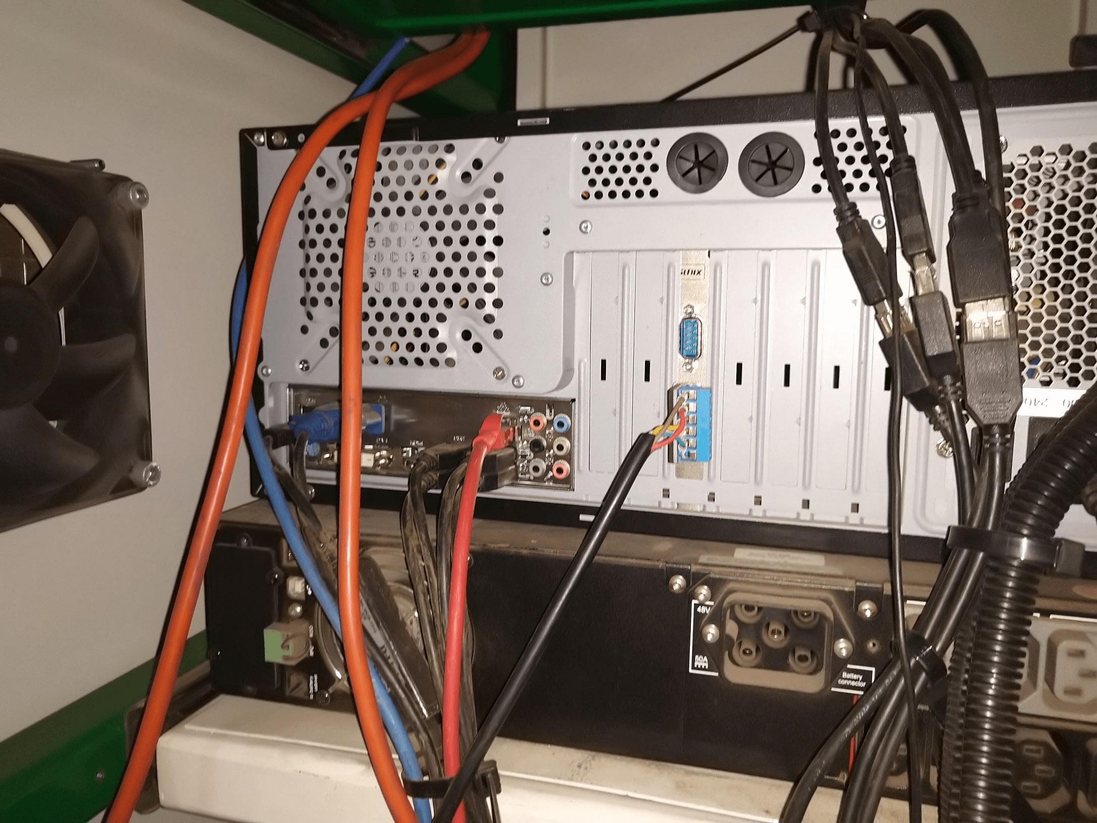

The card I am using is actually a RS232 card. I had it laying around and thought I would try to see if it would work. Linux Mint recognized it without having to install any drivers.
I had the plug from the usb to RS485 adapter I brought and it plugged into the RS232 port.
This was the USB to RS485 adapter I was trying to use but could not get to work properly, It should give you a idea of the plug needed,
www.jaycar.com.au/usb-port-to-rs-485-422...4136r&utm_medium=web
I just made sure that the wiring matched what was in the manual and once I configured the port, it worked straight away in PlasmaC.
I would say any card that can be used with the version of Linux you are using will work without a drama.
This is the card I am using, www.sunix.com/en/product_detail.php?cid=1&kid=2&gid=4&pid=902
