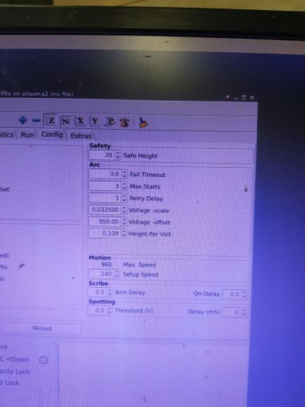

I made the comunication with an usb to rs485 from Icp-con 7561. It is working but i want to verify something. In material table i define a material with 45a and 128v. I start the process , everything if fine but in the voltage field in Plasmac i see only 60v. How can i verify where is the problem? I let the voltage divider on Powermax at 1:20, i made some test with a adjustable power source on the thc and seems to be fine...in this case if the voltage is not real in Plasmac, the thc is not working in real condition i think.

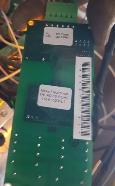

31 Mar 2020 16:13 #162299
Replied by rodw on topic RS485 For Hypertherms
It can be your scaling resistor or your config settings.
Can you advise your THCAD Model (-5, -10, -300)
The calibration data on the sticker on your THCAD
The value of any scaling resistor you have added
\provide a screen dump of your cut settngs that show the scaling data you have used in Plasmac
If your plasma supports it, I wold recommend a 30:1 divider setting, no scaling resistor and a THCAD-10. This will give a 300 volt full scale.

01 Apr 2020 02:39 - 01 Apr 2020 02:49 #162333
by alexandrub
Thcad is -10
sticker attach picture
I dont have any resistor attached
I attach a picture with scaling data
If I need I will change the Powermax divider to 1:30
