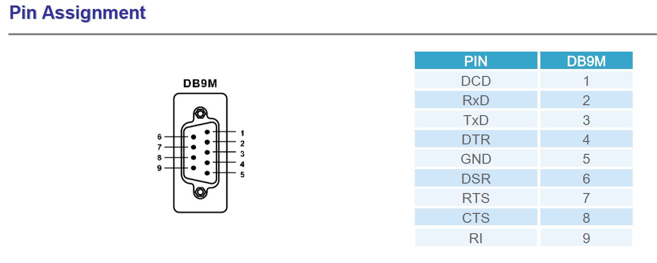

Really interesting. It'll be neat to see the pinout from the Break out Board there. From what I can tell, Stefan is just using a RS-232 card and a Break out Board. The converter part of what is posted above would be from USB to RS-485. Also, further adding to the interest is that the data sheets for that PCI card make no mention of RS-485. So I am really intrigued as to how it's working LOL.
Their data sheet did have a pinout specific to that card. I thought I would post it here even though we still need the BoB pinout to maybe try to reproduce this without the converter.
Lastly, I realized last night that my motherboard had a header on it for Serial Comms. I have it working without the card now (one less thing to vibrate loose), but I did not try it without the converter.

Some users have reported success with a Sunix P/N: SER5037A PCI RS2322 card a generic XC4136 RS232 to RS485 converter (which may sometimes include a USB cable as well).
I think you may have quoted your part number once before so I stole it!
