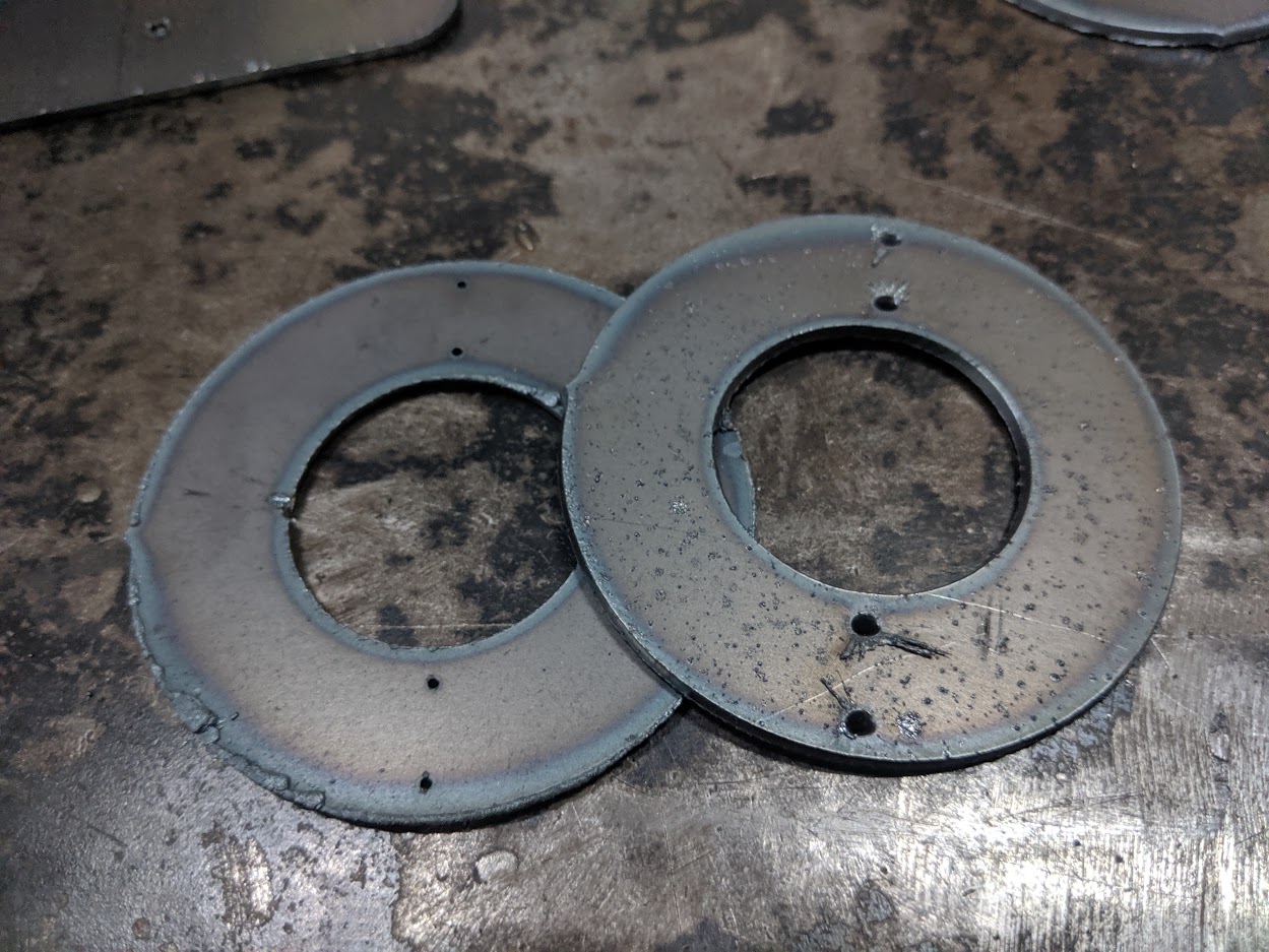

I have my setting in plasmac set at 400 milliseconds.
- thefabricator03
- Visitor
12 Sep 2019 07:18 #144929
by thefabricator03
Exact same behavior. Ill check the relay.
Replied by thefabricator03 on topic Center Spot Sheetcam Post
Was the behaviour the same, do #1 & #3 miss #2 & #4.
It doesn't make any sense to me.
Does your relay have a light to show it is doing something? (although the pulse is probably a bit quick)

Must be something with my plasma then. Is all you changed was the torch on time?
- Posts: 12094
- Thank you received: 4132
12 Sep 2019 07:21 #144932
What happens at 999?
Replied by rodw on topic Center Spot Sheetcam Post

Phill,
Relay turns on when it should but Plasma not.

Do you have a replacement relay, i think some solid state relays only indicate that they have an input.

Yes, thats all I played with. the 45XP manual says to dimple at 50 ms so we are on the right track I think but the time delay between firing the torch and the arc starting is likely quite variable between cuts so I think the count down needs to happen after the THCAD voltage confirms we are > 0 volts. Then the plasma won't know we tricked it!.

Ok tried 999 and G4 P10, works
999 G4 P3 works but the P10 created a better mark.
