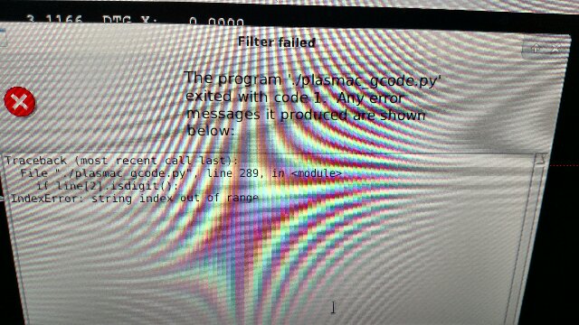

30 Oct 2019 17:54 #149197 by MakingStuff
Replied by MakingStuff on topic More Z-Axis Issues
I used my edited post processor that does not generate z-axis codes and also names the file with .ngc extension. I get the error shown in the attachment when loading the g-code into LinuxCNC. Sorry it's not good quality. I had to snap the picture with my phone.
Since the .ngc file would not load, I renamed the file back to .tap so it would bypass the parser and ran it in LinuxCNC without any z-axis code. It still loses the arc signal at the end of some cuts and definitely does not resume after hitting the pause button. The only way to continue is to right click the next line of g-code and select Run From Here. It did not crash the z-axis this time, I have not run many parts to see if the omission of the z-axis codes will keep the z-axis from crashing but that part seems to be working so far.
30 Oct 2019 22:02 #149225 by phillc54
Replied by phillc54 on topic More Z-Axis Issues
Yes, having no Z motion should stop the Z crashes. PlasmaC needs to do all the Z moves, if you have any coded Z moves then it will get confused as you have seen.
Can you post the ngc file you got that error on and could you zip your config and post that as well.
