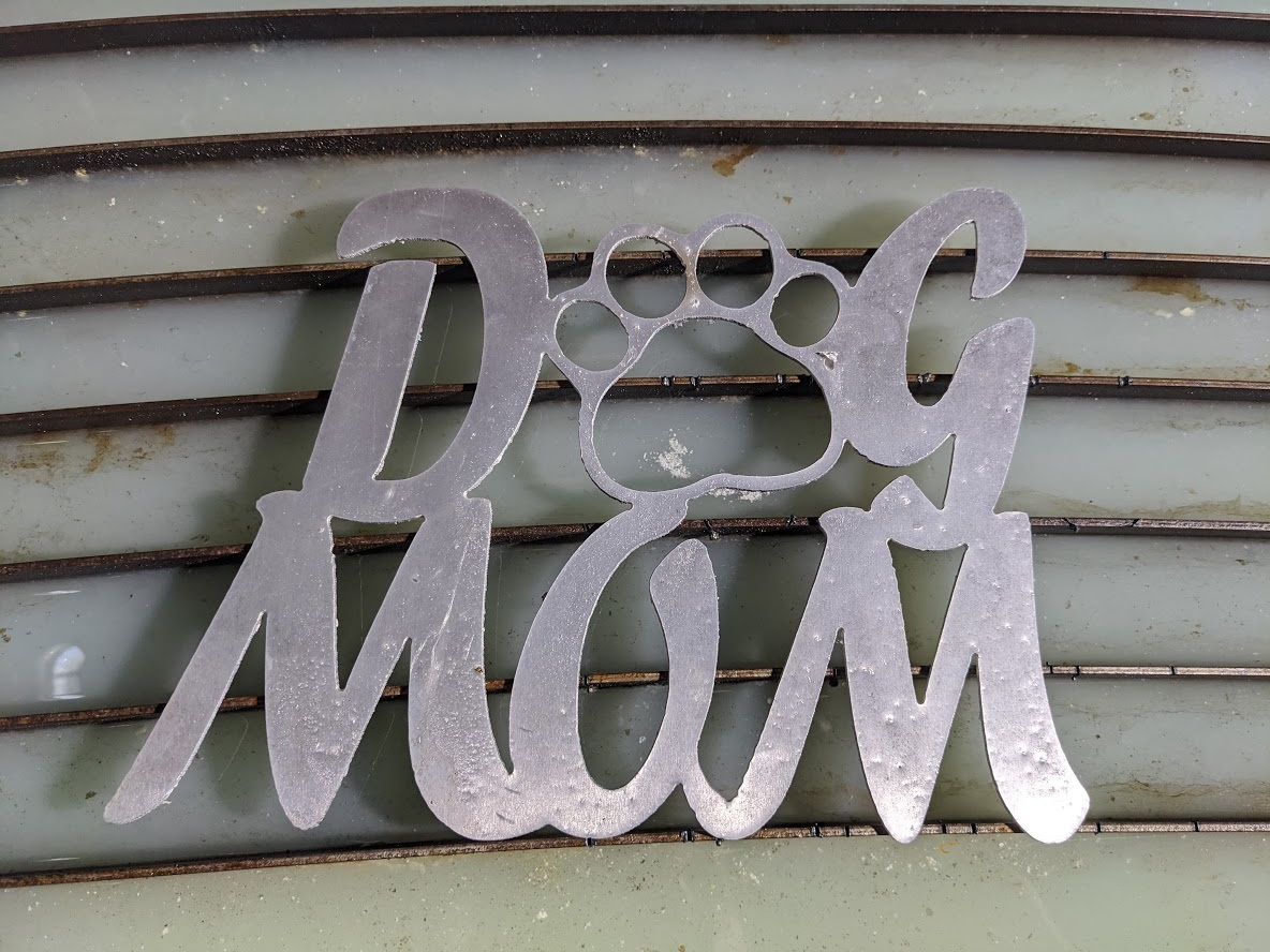

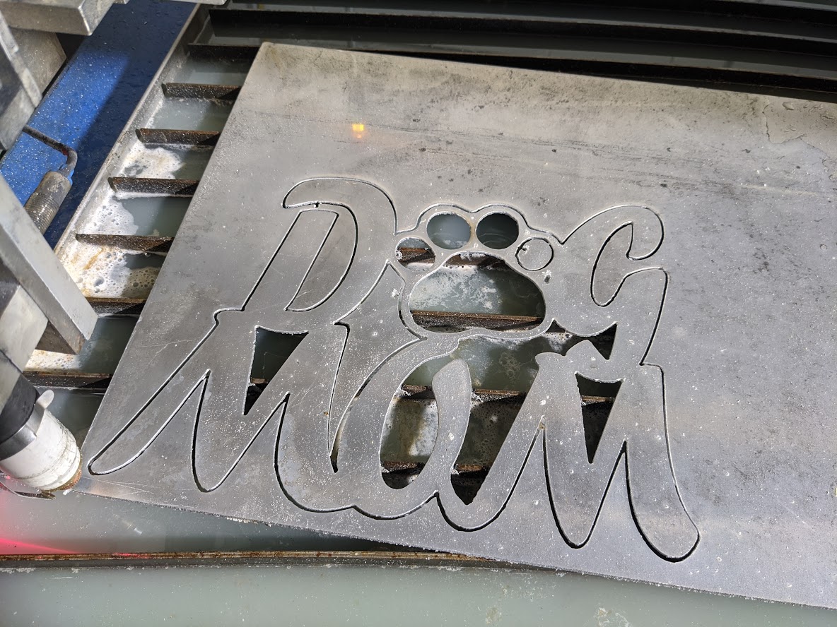

04 Nov 2019 01:39 - 04 Nov 2019 01:41 #149517 by MakingStuff
Replied by MakingStuff on topic More Z-Axis Issues
Did you have a feed rate value set in the Cut Parameters of the Run Panel?
No of course not:) You even told me to set it. I had it set to zero for g-code value. It worked when I set it in the run panel. However your post processor does the same thing. When it fails LinuxCNC won't resume.
I have noticed something. I have now cut 4 of the Dog Mom signs testing this problem. It always fails on the same piece each time. Both your post processor and mine, it fails and the piece always falls in the water too. Other parts fall in the water and they do not cause the error. I'm wondering if there is something in the g-code like you mentioned earlier. The last line right before M5 is where it always stops.

04 Nov 2019 02:11 #149518 by rodw
Replied by rodw on topic More Z-Axis Issues
Question:
Do you have a leadout programmed in Sheetcam? Tommy mentioned this early but if there was a leadout into a part that dropped away, you would loose the arc when it falls.
I would recommend that you save your Sheetcam toolset and import it into plasmac using Phill's materialverter script.
Maybe share your DXF file and somebody might give it a try.
04 Nov 2019 02:16 #149519 by phillc54
Replied by phillc54 on topic More Z-Axis Issues
Rod, there is no leadout so I thought it may be because the last cut which was an arc may be really short but the last bit of code posted showed the last arc as 0.3772" (9.58mm) although the next to last is 0.0408" (1.04mm).
It has me perplexed...

04 Nov 2019 02:35 #149523 by rodw
I kinda think something outside of the gcode is causing this. eg. What if acceleration was too slow and the feeedrate slowed as it comes up to the final stop and the material burnt away and the arc was lost?
I also noticed the feed override was set at 120%
What thickness is your material? (in inches or mm would be good as I find Gauge confusing)
What plasma cutter?
What hardware? eg Mesa/Thoma etc.
It would be good to share your DXF. (And I don't even drink bourbon!) It would be interesting to cut it on a known good machine with a known good post processor (mine is different to Phill's)

04 Nov 2019 03:13 #149524 by MakingStuff
What plasma cutter?
I turned the feed rate up to 120% to see if if would stop the part from falling in the water.
Material is 16ga steel.
Harbor Freight Plasma cutter set to 40amps.
I have a Mesa 7i96 and a Proma Compact 150 THC.
I don't mind sharing the .dxf. I showed the Jack Daniels in the video but the Dog Mom has consistently lost the arc in the same spot. I have it attached.
04 Nov 2019 04:35 #149527 by rodw
As I suspected, its not a G code issue.
This is 1.6mm aluminium (I make that 16 ga) @ 3490 mm/min (137.4 inches per min), 40 amps
More likely to be an acceleration issue causing a flameout as I guessed earlier. I would use halscope to observe the current velocity (motion.current−vel) with torch disabled and observe how much it slows on those tight corners.
You may need to fine tune your acceleration (as fast as you can get) or play around with cut height.
Also applying a fillet on those sharp corners or relaxing the G64 parameters might help reduce the slow down on corners
I've attached my post processor. I'm not saying its perfect but I know it works.
