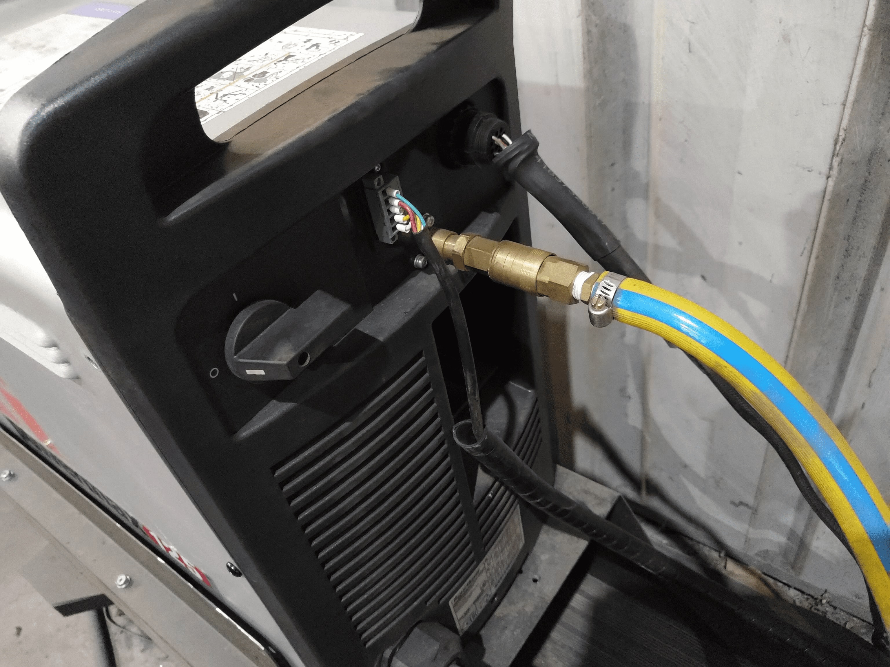

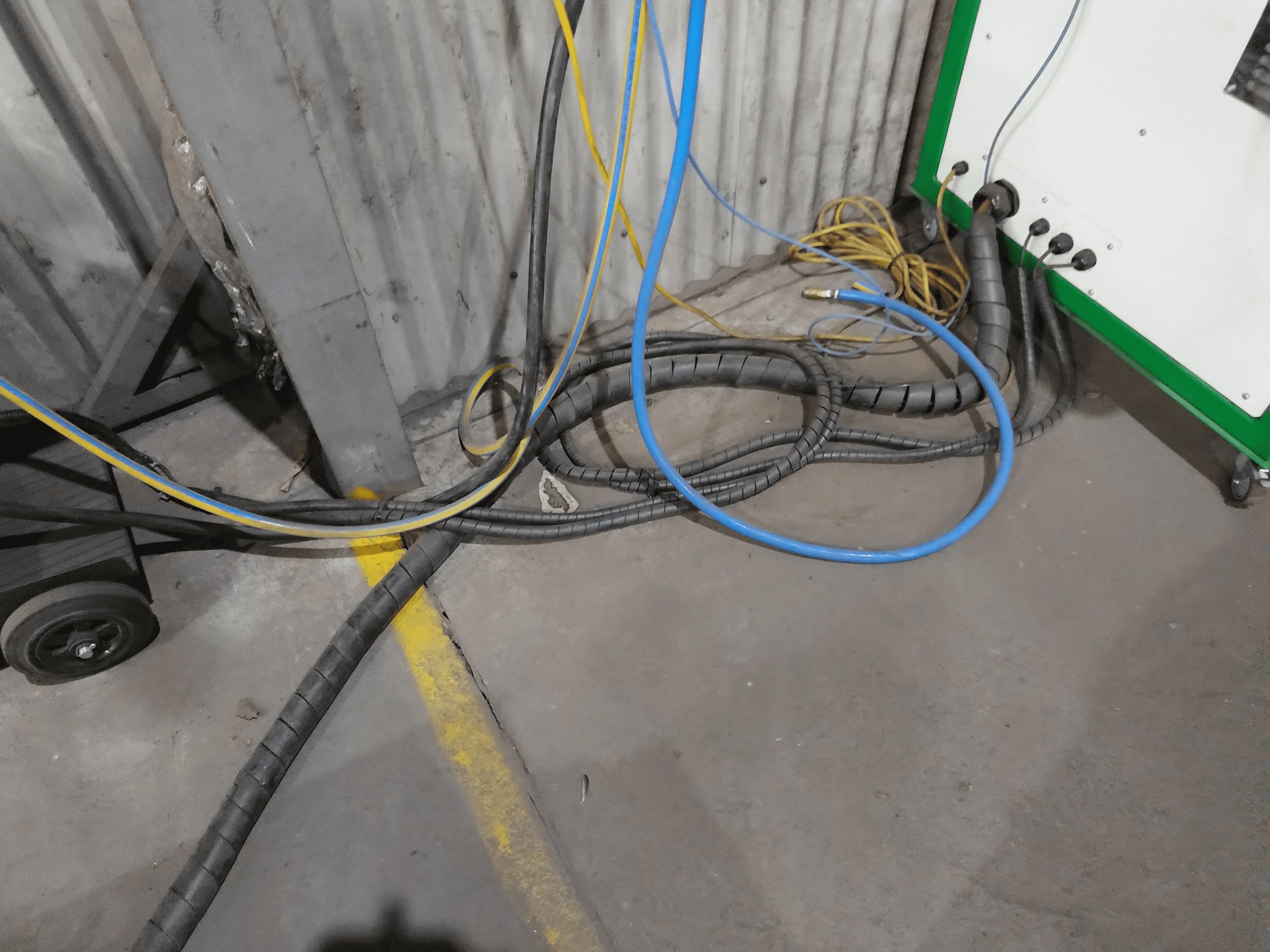

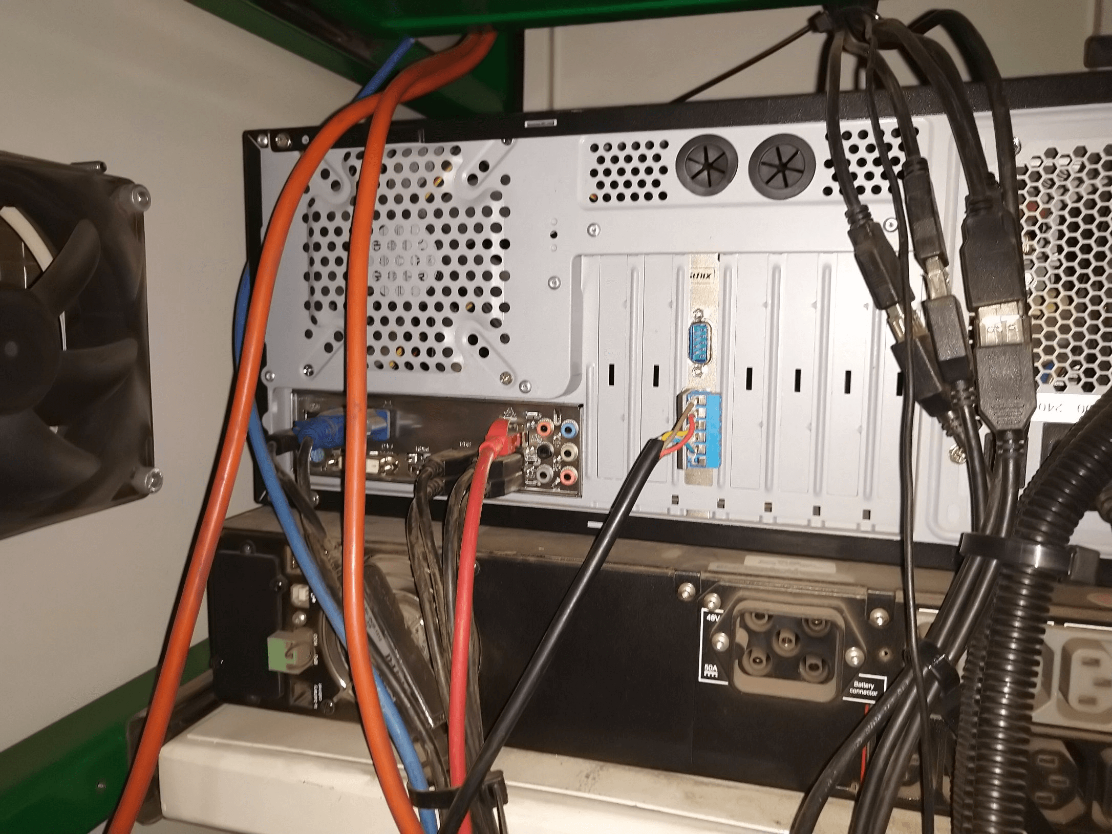

21 Feb 2020 06:54 - 21 Feb 2020 06:59 #158089 by thefabricator03
Replied by thefabricator03 on topic Plasmac install.... Windows convert from start to finish
So Stefan what has your cable from the plasma to your new controller cost this time around?
So roughly
5 core cable from machine to controller - $40 for a 10 meter roll but I use about 5 meters,
Connectors - Plasma unit came with connector for unit and I used a connector to PCI card from the failed USB to RS485 unit I tried,
$ ~ 10
Boot lace crimps - $3.00 a pack
Most people wont need to do this but I used hydraulic spiral wrap on my cables that are on the floor in my industrial workshop $40 for 5 meters.
PCI RS232 card - $40 from ebay.
So for about $133 AUD I have a quality RS485 link between my Hypertherm plasma and controller running PlasmaC. The CandCNC setup cost near $900 AUD with shipping.
