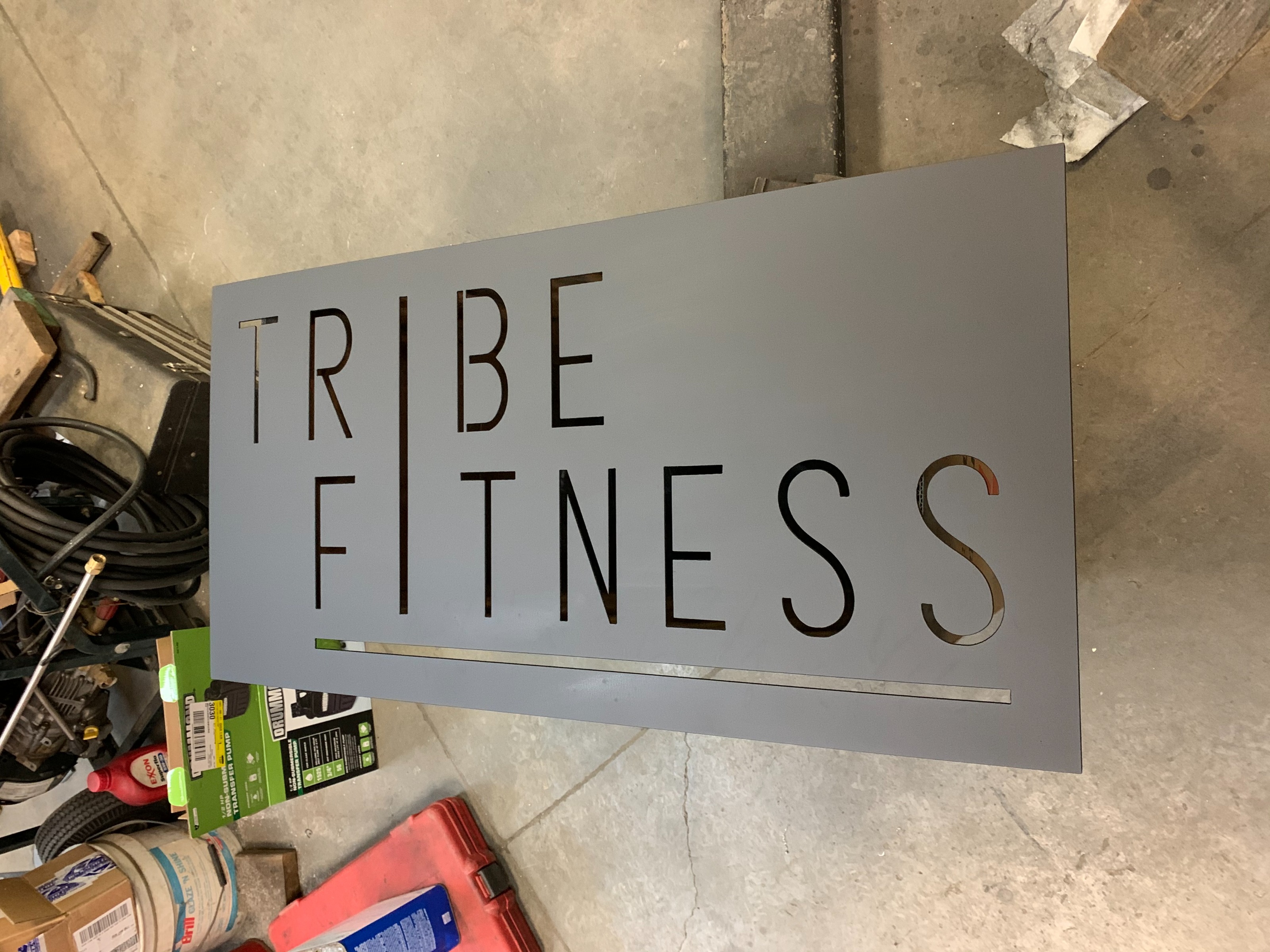

15 Jun 2020 10:31 #171733

- bbsr_5a
- Posts: 544
- Thank you received: 106
15 Jun 2020 10:51 #171737
by bbsr_5a
Replied by bbsr_5a on topic Photos
looks almost like a laserCut

- snowgoer540
- Posts: 2580
- Thank you received: 907
15 Jun 2020 14:54 #171748
by snowgoer540
Thank you!
Replied by snowgoer540 on topic Photos
Thank you!

15 Jun 2020 20:12 #171768
by thefabricator03
Replied by thefabricator03 on topic Photos
Powder coated?
- snowgoer540
- Posts: 2580
15 Jun 2020 23:22 #171786
by snowgoer540
I wish I had an oven big enough for that... I rattle canned it
Powder coated?
- thefabricator03
- Visitor
15 Jun 2020 23:28 #171788
by thefabricator03
Yeah I have had success with rattle canning things Ive cut as well. They come up surprisingly better then expected.
Gloss on the left, Matt on the right. Ended up Matting both of them as the gloss showed up all the grinder touch ups.
