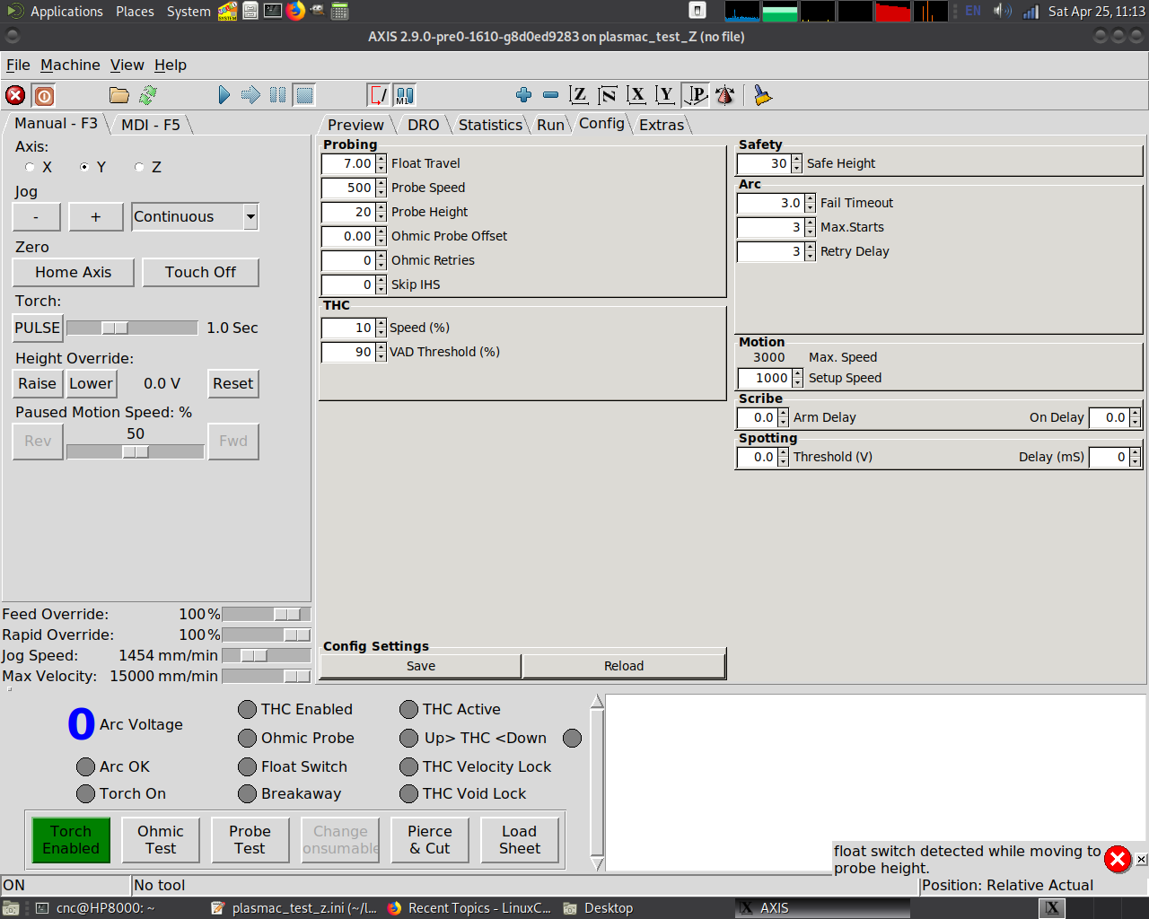

Linuxcnc 2.9 build 1610 :
No touch off !
Z axis ini settings: -20mm
Config panel settings: Probe height = 20 , safe height = 30
Result = Error on probe test.
Same ini, config settings changed to: probe height = 30, safe height = 45
Result with 3mm thick material = no error.
Result with 10mm thick material = error on probe.
Same ini, config settings changed to: probe height = 40, safe height = 50
Result with 10mm thick material = no error, safe traverse height has been reduced.

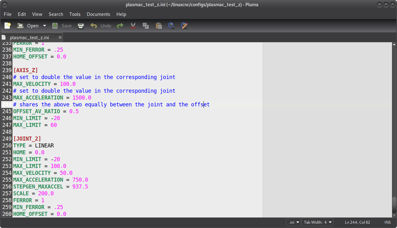

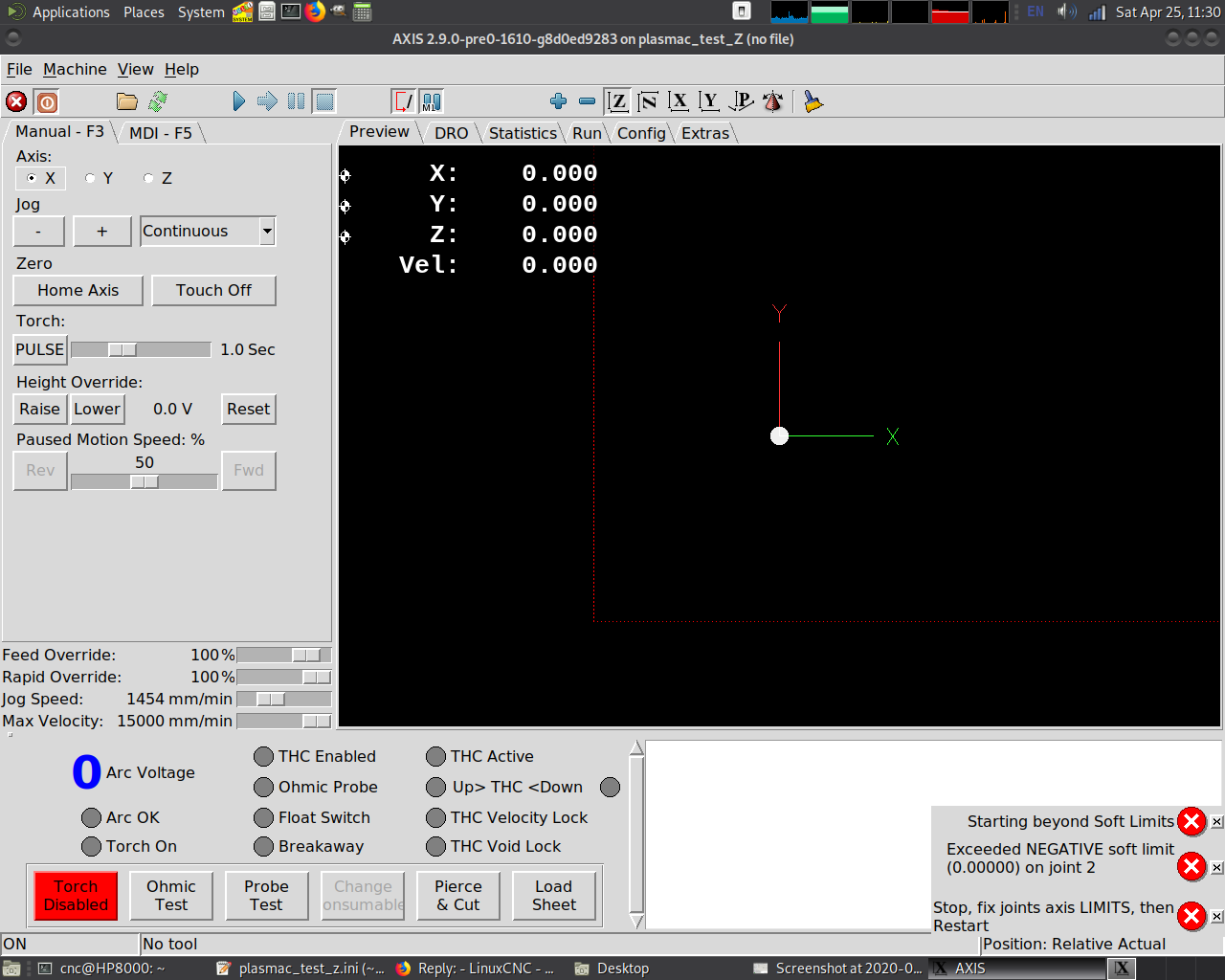

Set the min_limit to 0 for the Z axis, go to slats to home, press home, error :
To recover, press F1, then again F1 and F2.
If by any chance it gets to 0 value on the Z axis during jogging, it will trip limit error, notify about fixing limits and restart, so not motion is possible, a restart of Linuxcnc is required.
With touch off just above the 3mm material, ini min_limit at 0, config probe height at 20 and safe height at 35 = works OK.
With touch off just above the 10mm material, ini min_limit at 0, config probe height at 20 and safe height at 35 = works OK.
Unfortunately i can not reproduce an error i got twice last night where is would stop all motion, error out ( do not recall the exact error ) and a restart of Linuxcnc would be required.

A quick look at the ini shows different values for the axis and joint max limits, I don't know if that causes any problems.

I am aware, it does not get to 60mm ever while testing.A quick look at the ini shows different values for the axis and joint max limits, I don't know if that causes any problems.

When you had z minimum at -20 do you know where the torch was in relation to the slats when you jogged z fully down.
I don't suppose you know what he original g54 offset was before you did the touchoff.
Did you jog Z down for this.Set the min_limit to 0 for the Z axis, go to slats to home, press home, error :

Just a bit under the top of the slats, or table in this case, about 3mm.When you had z minimum at -20 do you know where the torch was in relation to the slats when you jogged z fully down.
Yes.Did you jog Z down for this.
No offset, machine 0 at G54 0.I don't suppose you know what he original g54 offset was before you did the touchoff.
