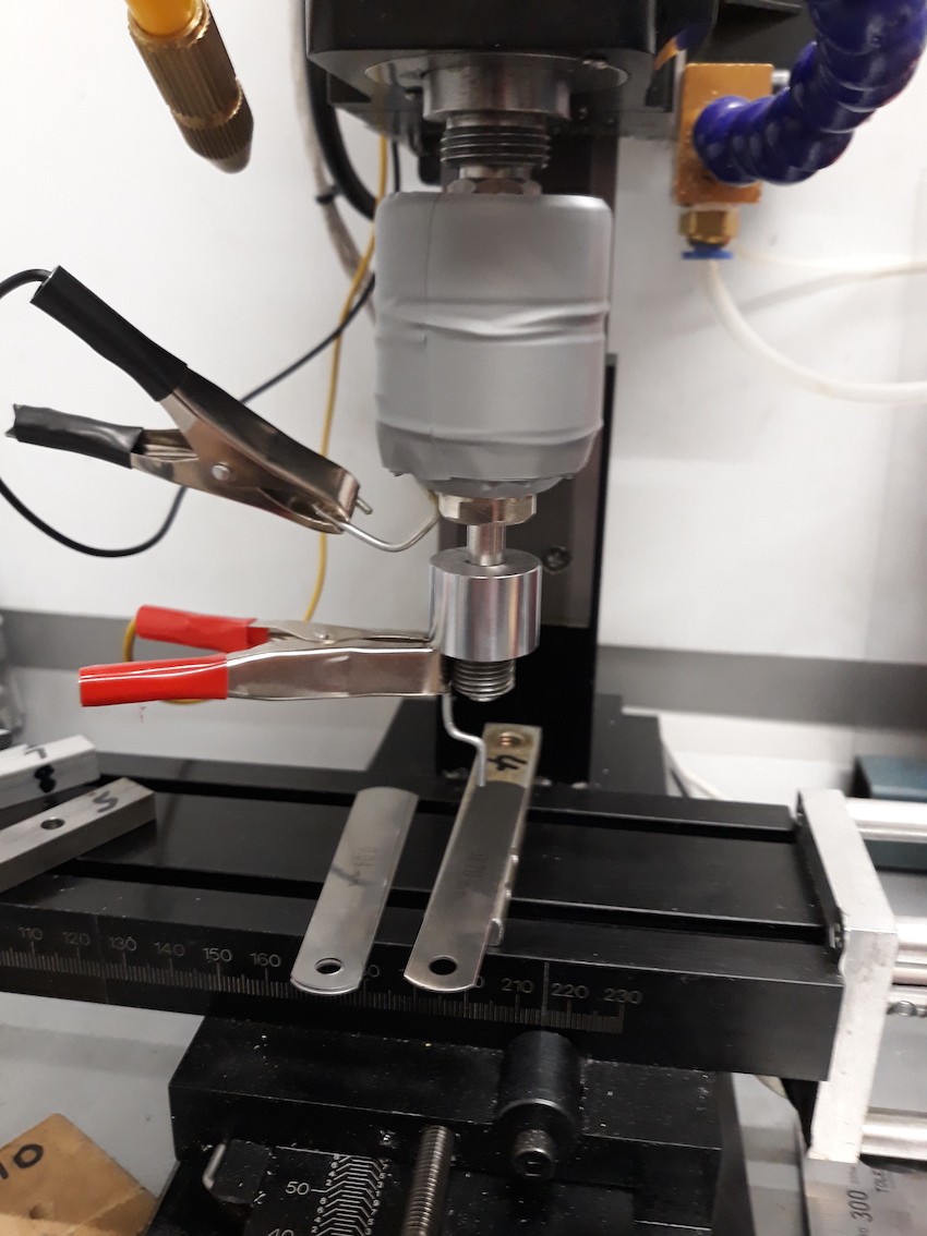

I have been probing this morning at 1200mm/min with no issues. I setup some feeler gauges and I can have a 0.01mm difference between a probe being successful or hitting the lower limit and it has consistently worked as intended.
This is so frustrating, would you believe the actual float travel I ended up with is 6.66mm. An apt number for these circumstances...
I thought I show my hi tech float switch on the little sherline mill.
The following user(s) said Thank You: tommylight, Clive S
29 Apr 2020 03:03 #166053 by phillc54
Replied by phillc54 on topic For PhillC regarding PlasmaC and Z axis stuff
Some minor adjusting has got it where I can hit the bottom limit and activate the probe at the same time.
It shows the plasmac error "bottom limit reached while probe testing" then times out and recovers which is the expected behaviour.

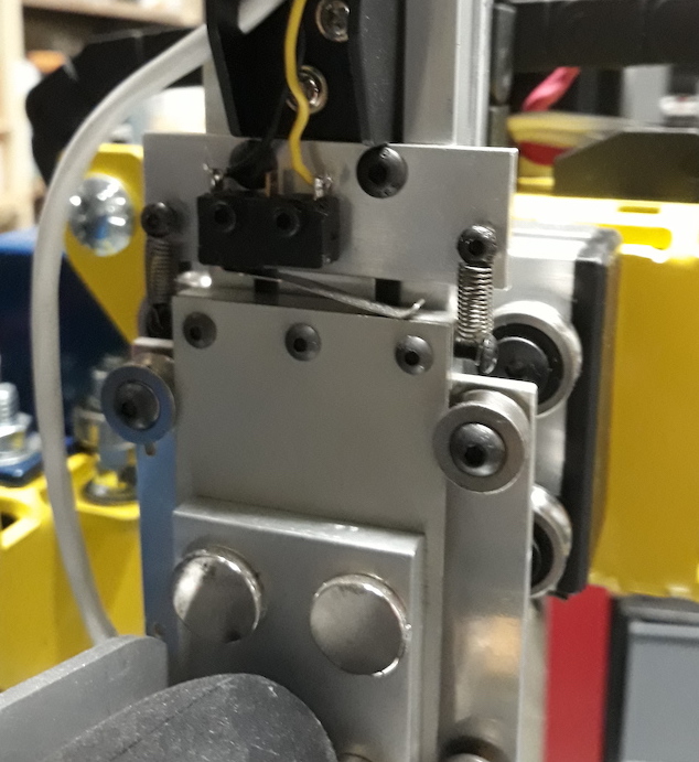

The amount of Z motion up to turn the switch off should only be the switch hysteresis plus overrun.
I use a mechanical microswitch and it is somewhere around 0.25mm so about a quarter of a second of Z travel.
I see your Z accelleration is 750 and your probe speed is 500 so your overrun should be around 0.05mm, that is .05 seconds of Z travel.

The issues i was having with Z stemmed form high velocity, as sometimes the axis would move past the limits set in ini, error and report, advise to fix limits and restart Linuxcnc, Any attempt to move any axis after this would bring another prompt saying "starting form beyond limits" but will not move any axis without restating Linuxcnc. Had the same issues with other axis while tuning stuff.
I am using a different float setup on new machines, so the float has to travel 7mm to trip the switch + 2mm of overrun, them move up the full length plus pierce height, so that makes 12mm of retract travel on every probe. That can be clearly seen here:
forum.linuxcnc.org/show-your-stuff/38547...uild?start=60#167665
I can shorten the bolts that hold the floating part to about half, halving the probe time, without the need to slow down the Z axis.
