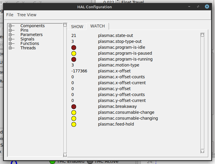

Okie dokie. Not sure how much feedback you're looking for here since I know you said you still had work to do. But here's my findings anyhow:
1. Change consumables doesnt work during the first rapid. Resuming (by pressing unpause) does work during the first rapid.
2. Pausing during the first G3 line (G3 line highlighted, not sure if that is the current line or next line to be honest), cant change consumables. Cant resume cut (pressing unpause does nothing). Cut Recovery button is greyed out. I attached a screen shot of the state if it helps you:
2(continued). Consumable Change pin stays lit after stopping the program.
3. It actually doesnt matter when I pause, it wont change consumables, and wont resume cutting, and Cut-recovery stays grey.
May be worth noting that even with the x-offset not being 0 after stopping the program, it didnt crash into anything.
Let me know if you need anything else, the day is getting away from me, I have a few things to finish before the lady returns from work.

Thanks, I haven't checked through the code yet but could you try changing your ini file BUTTON_3_CODE to X0 Y0 F160 I am not sure if it requires both axes.
Well, that seems to work much better! In the short time I've been testing, I can't get it to do any of the stuff I have been complaining about for the past 3 nights. So I guess I have two questions then:
1. Is that how we want it to work? I could see how just moving to the left side of the table is enough. The torch doesn't necessarily have to go to the X0 Y0 position. Further, are these in machine coordinates, or job coordinates? Should probably be machine coordinates.
2. Why was my ini missing the Y0? I am pretty relatively sure I never changed that. In fact I double checked Cody's ini file, and it is the same way (that's from a new config).
Looks like you disabled consumable change and cut-recovery if paused during the first rapid.
Looks like you disabled cut-recovery during any rapid.
Only potential issue I see, is the torch doesnt go to the top of Z travel before going to change consumables. Probably hard for me to make a case for this if you are changing consumables, but there could be a scenario where there's a tip up, or you're cutting in box tube, or something where you'd want to retract Z before moving to change the consumables. Thoughts?
No, that is an error, I think it should substitute zero for a missing axis or at least show an error popup.
They are machine coordinates.
Only you can answer that. :)
Yes and Yes
