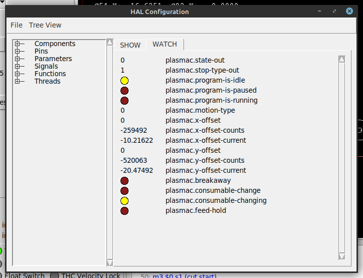

29 Jul 2020 20:31 #176407 by snowgoer540
Replied by snowgoer540 on topic Feature Request
So there are a few lingering things:
1. I tried taking out the Y0 of the ini, it still goes to X0 Y0. Maybe this is by design?
2. The shutter is back. I did confirm that it is not JUST the Y axis (as I had previously thought), it is for sure X and Y. It was harder for me to notice the X axis since it's lighter weight and only one stepper motor. Z may do it too, but I am using a ball screw, and it's extremely difficult to notice any shutter via that. I did watch the coupler for the Z axis very closely, and if it shutters, I can't notice it. I'd be reasonably confident saying it's only X and Y. Also, I confirmed that it does it at both ends of the soft limit travel for each axis. Exact steps to reproduce:
  • Home table
  • Load the job.ngc file I posted previously
  • Start the job from home position
  • Pause during the first M3 probe
  • Click change consumables
  • Press stop once the torch reaches the X0 Y0 position
  • Move Y axis off of soft limits with Up arrow key
  • Jog into the soft limits with down arrow key (not rapid)
I replicated this several times with the above method. Each time I restart LinxCNC, it's gone. Doing the above brings it back.
I should note for clarity that it does this with and without Y0 removed from the ini (the shutter had cropped up during the session in which I removed Y0 from the ini file, so I added it back to rule that possibility out).
Here is a picture of the hal watch when the shutter is present:
Here is some videographic evidence :):
Normal bump against soft limits
Soft limit bump after table had too many cups of coffee
I think everything else seemed good to go otherwise.

29 Jul 2020 23:41 #176422 by phillc54
Replied by phillc54 on topic Feature Request
Yes, a missing axis in the parameters will default to zero.
Would it be preferable to make it the current axis position?
Home table
This behaviour is expected with that workflow...
When you press stop, PlasmaC loses control of the axes and as your pic shows the offsets are still current. I am sure LinuxCNC doesn't take these offsets into account when it is detecting soft limits so your axis are really in an unknown position.
I will need to do some investigation into how we can get around this. We can't just reset the offsets to zero as the macine will then unexpectedly rapid move to where it should be.
29 Jul 2020 23:57 #176425 by phillc54
I pushed a fix (I think)

30 Jul 2020 00:25 #176426 by snowgoer540
Yes, that's an excellent idea! From a safety standpoint, I'd think leaving an axis out of the ini should result in that axis not moving as it may be unexpected. I think setting it to the current position for the missing axis is a perfect solution!
Interesting, it makes me feel better though that it's not just me. I can imagine though that someone at some point might decide to stop the program for whatever reason in a chance consumable position.
I'll run down and give it a go quick.
