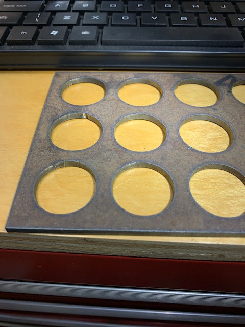

Penguin Phill (the lady says hi :lol:), Holy Crap! This works AWESOME! Honestly, all of the testing and fidgeting with getting everything just right was well worth it. I think people are going to be blown away at this. I just did a bunch of circles, because I figured they would highlight the differences, and I think the pictures speak for themselves. I'll focus on the three holes in the bottom left corner. I am going to attach a picture of them, a picture of the screen showing all the places I used the CR to bump the torch around, and then a picture showing the edge cut where I tried CR.
Three holes:
Warning: Spoiler!
So here's what you're looking at:
  • the middle hole on the left side was paused mid-way through the cut, and then just a regular resume without bumping the torch around
  • the bottom left hole was a cut recovery hole, I jogged the torch around before resuming, you can barely notice that there was a re-fire.
  • the 2nd hole from the left on the bottom row is a regular no pauses hole
The takeaway is how large the dimple is from the regular paused-motion-resume. Now compare that to the CR dimple. I know you cant see it in person, but it's almost non-existent. In fact, without the screen shot of everywhere I used CR, it's difficult for me to tell a CR hole from an uninterrupted hole.

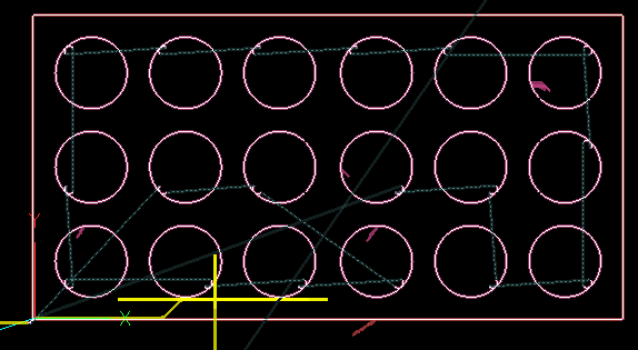

Here's the screen grab of all the places I used CR:

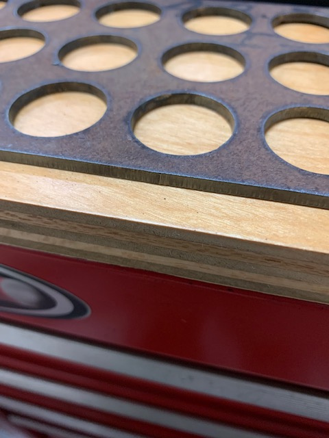

And here's the edge where I used CR. I should have done a non-CR pause here, but I didn't think of it in time.
Warning: Spoiler!
I'm happy to do more testing if you'd like, but really I think this is ready for main stream. Seems pretty stable and well worth the effort to me.
I will word smith the doc addition a little in a bit.
Thanks again for all the hard work!
