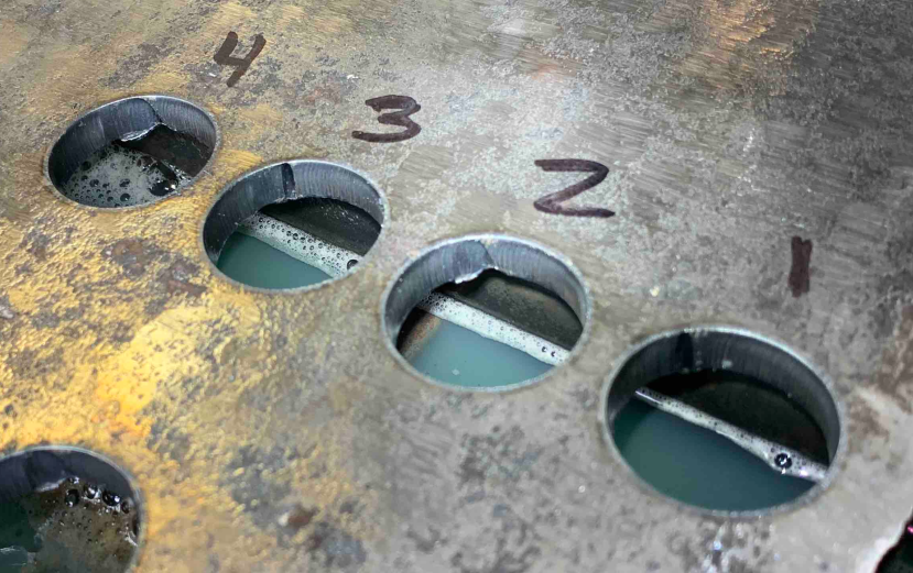

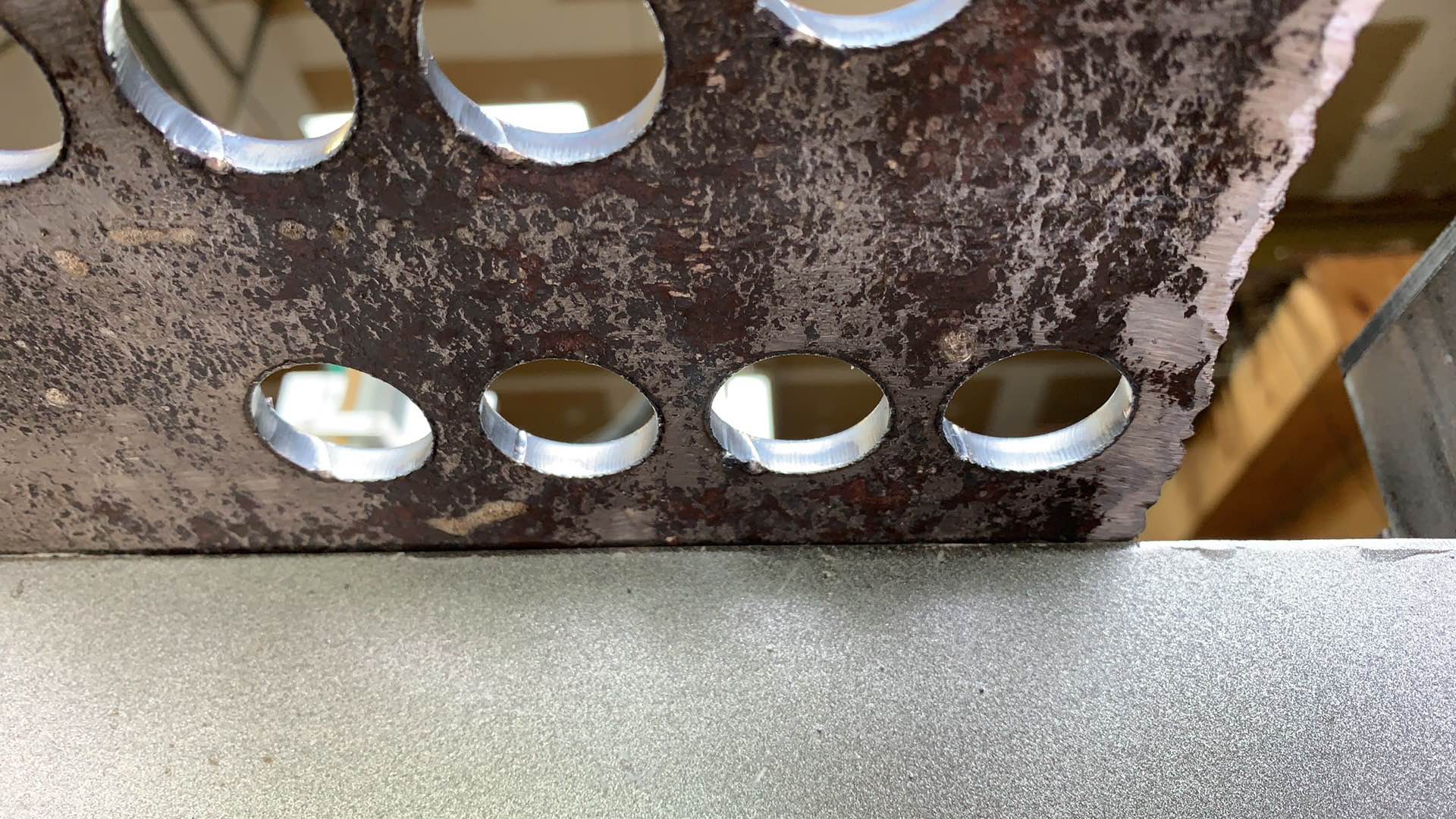

16 Aug 2020 21:00 #178428 by snowgoer540
Replied by snowgoer540 on topic Feature Request
Ok, so I got to some cutting/testing today. I'll start with the good in this post...
M62 P1 works great!
I spent some time doing experimental cuts on 1/4" thick steel, cutting a 1" circle. Here were the scenarios:
Hole #1: Perpendicular lead in (.1"), no lead out
Hole #2: Perpendicular lead in (.1"), arc lead out (.25") - This required M62 P1 before the lead out arc to prevent a pause due to lost arc
Hole #3: Arc Lead in (.25"), no lead out
Hole #4: Arc Lead in (.25"), arc lead out (.25") - This required M62 P1 before the lead out arc to prevent a pause due to lost arc
Results:
Top of plate:
Bottom of plate:
It may be hard to tell it in the pictures, but Hole #4 is probably the best quality. At any rate, I didnt try cutting an overcut at all, maybe that would yield better results. Also, this wouldnt be possible in a non-interrupted fashion without being able to ignore the arc-ok via g-code. I intend to fine tune further. I remembered at my last job we ran a big HD plasma table, and the company insisted on arcs on both the lead ins and lead outs. I guess their controller must have a way to tell they are cutting an area that has already been cut and to ignore any flame-outs, but now we can do the same thing. So I think this is mission accomplished. Thanks again Phill!
