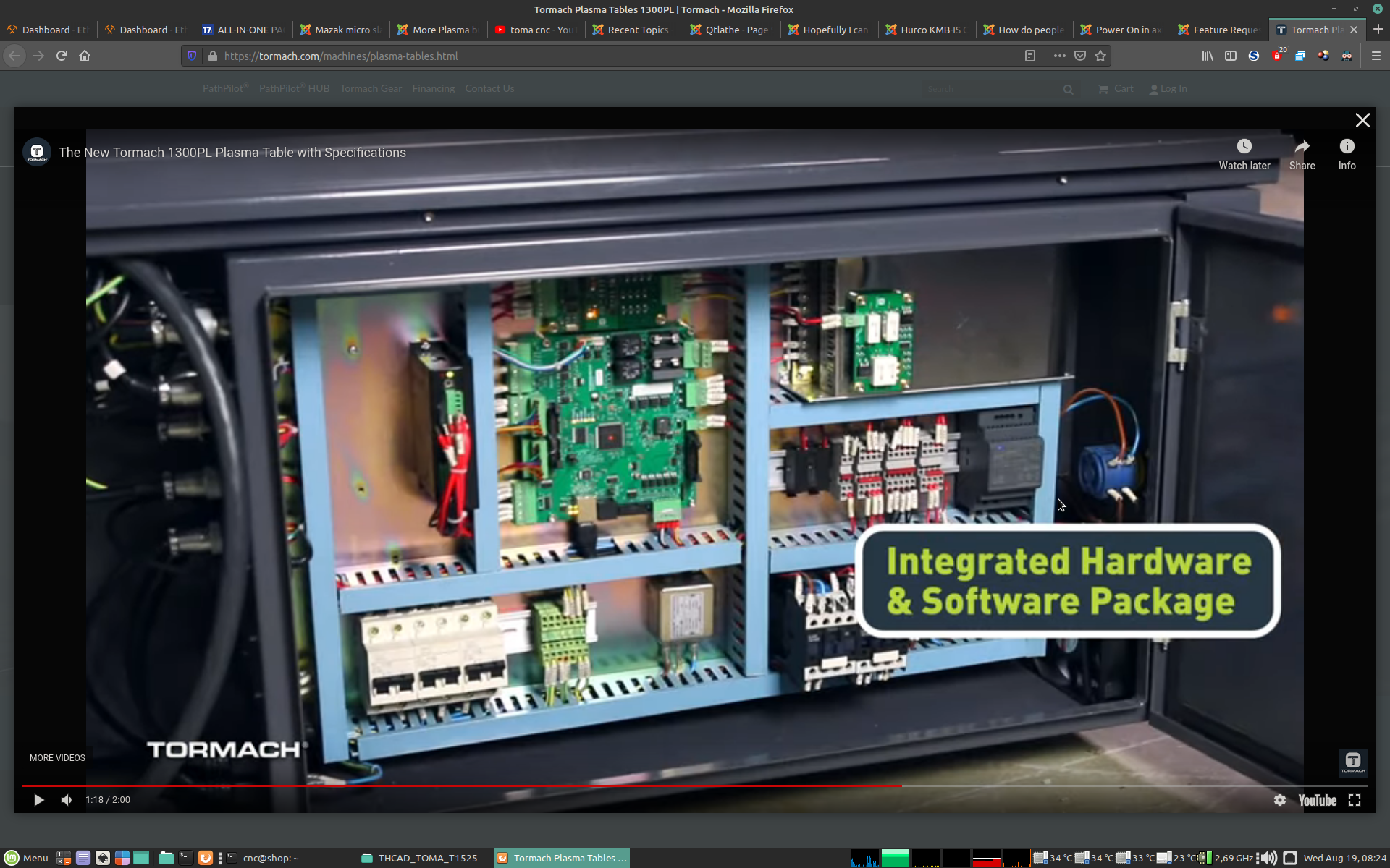

19 Aug 2020 06:26 #178679 by tommylight
Replied by tommylight on topic Feature Request
In all seriousness, I wonder if they are using @PCW's THCAD. It seems they use his hardware (in a modified to suite Tormach's needs) everywhere else, it wouldnt surprise me. Also, I wonder what they are doing for ohmic sensing.
See if you can spot it :

19 Aug 2020 09:51 - 30 Aug 2020 22:17 #178692 by snowgoer540
Replied by snowgoer540 on topic Feature Request
Dang, good eye man! Guess that's an ohmic card all the way to the right... looks to be of their own creation.

19 Aug 2020 14:53 #178714 by tommylight
I can make out a MosFet, a voltage regulator (5pin one) and 2 power resistors, and only 2 wires, so i have no clue.

19 Aug 2020 15:01 #178716 by snowgoer540
Doesnt seem far off from what I see there.
