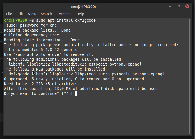

21 Aug 2020 21:19 #178957 by hermann1976
Replied by hermann1976 on topic Beginner Plasmac Questions
do you have linux or windows as operating system where you want to install dxf2gcode?
I installed it on Linux, the same PC where LinuxCNC is running.
I have to admit it's a bit tricky.
Please follow the installing instruction. Also be sure that you have all the nesessary runtime dependencies for Unix mashines.
sourceforge.net/p/dxf2gcode/wiki/Installation/
File to download:
sourceforge.net/projects/dxf2gcode/files...0191025.zip/download

22 Aug 2020 21:06 #179036 by tommylight
Replied by tommylight on topic Beginner Plasmac Questions
File to download:
Just gave it a try and it is disappointing to put it mildly ! It was a nice single py file to double click on and it would run, now errors galore !
Oh wait, tried this and it works !
An older version, but better than nothing.

23 Aug 2020 06:52 #179073 by tommylight
The screenshot is from a Linux Mint 20 box, it runs.
