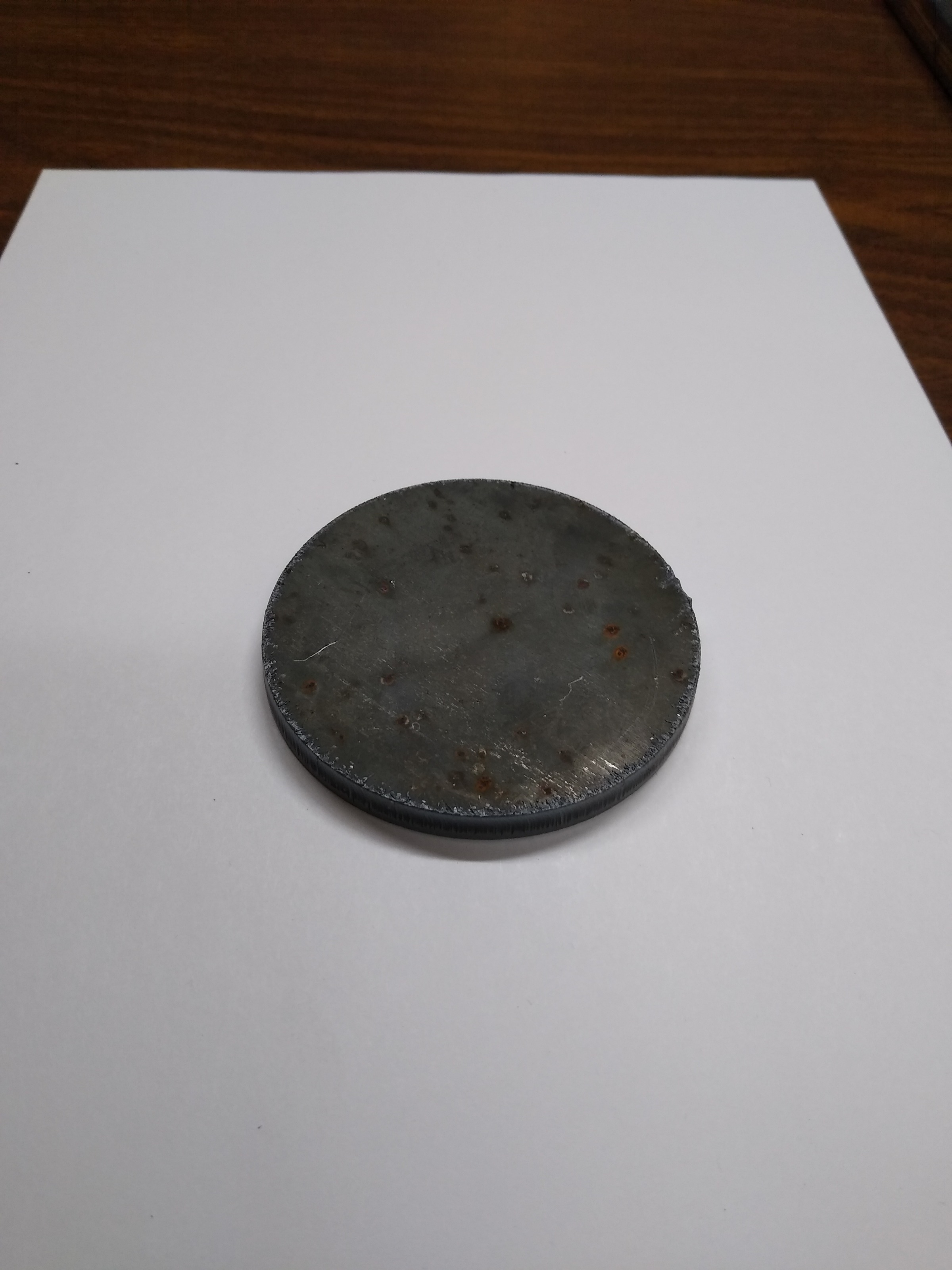

23 Aug 2020 17:31 #179121 by AgentWD40
Replied by AgentWD40 on topic Beginner Plasmac Questions
I'm trying to run a single cut from the Run tab, when I click start cut the z travels to it's soft max limit then stops and then does nothing. My buttons are greyed out and I have turn machine off and on again to get back control. I assume this has something to do with the fact that I don't have any z limit switches yet. Am I missing something or is it something I can get around until my z limits are installed?

23 Aug 2020 23:00 #179153 by phillc54
Replied by phillc54 on topic Beginner Plasmac Questions
Does the machine Pause or Stop.
If you run LinuxCNC from a terminal do you get any error messages.
Also, does the "probe test" automatically set the probe travel or is the probe travel something I have to do manually?
Probe test uses the probe parameters from the Config panel. It will probe at the current X/Y coordinates. The only variable to set in the ini file is the probe time, see Probe Test here:
linuxcnc.org/docs/2.8/html/plasma/plasma...de.html#_button_code

24 Aug 2020 14:11 - 24 Aug 2020 15:10 #179244 by AgentWD40
Well I came back to it this morning and I have no idea why but it just worked... So yay!
First test cut using the extras panel attached below.
How do I get these parts to start at where I jog the torch to? When I hit run the machine insisted on starting from machine coord 0,0. I tried G92 X0 Y0 but that didn't work.
[EDIT]
Nevermind, I figured it out. Touchoff for x and y. For some reason I was just thinking the touchoff button was for z.
