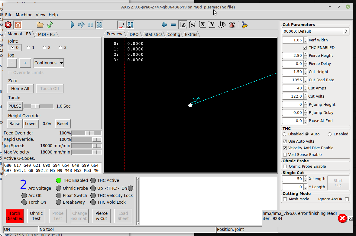

I think I've comprehensively broken the software, otherwise I don't know what to think. I was briefly on 2.9/master but after getting the attached communications problem (error finishing read, and also joint following problems) I rolled back to 2.8 for troubleshooting. It's still showing as PlasmaC v0.170 (which I'm not sure if it should on 2.8), but I also get the error on the non-PlasmaC config.
Pinging the 7i96 looks reasonable (~0.2-0.4ms). Should I just clean install Mint 19.2 using BeagleBrainz's ISO?
Edit: I timeshifted back to this morning (Mint 19.1 / LinuxCNC 2.8.0 / PlasmaC 0.139), and hopefully it stays stable. I shouldn't have had this little 'adventure' on a Friday!

04 Sep 2020 16:00 #180696
Replied by tommylight on topic Linux Mint - PlasmaC upgrade confusion
Change the kernel to 4.9, it has better latency.

04 Sep 2020 16:47 #180708
by Mud
Replied by Mud on topic Linux Mint - PlasmaC upgrade confusion
I've just tried 4.9 with the previous 19.3 / 2.8.0 and I still get communications-related errors (joint following error).

04 Sep 2020 16:57 #180710
Do you get one or the other, they are not the same thing.I still get communications-related errors (joint following error).

04 Sep 2020 17:05 #180711
by Mud
The joint following error and the error finishing read. I am now thinking I was borderline before, and maybe the change of version has made it more apparent (to the point it errors even whilst doing nothing) - so consider it a possible red herring. I googled it and people were saying these both point back to communications with the 7i96.

- Posts: 18099
- Thank you received: 5326
04 Sep 2020 17:08 #180712
Replied by PCW on topic Linux Mint - PlasmaC upgrade confusion
What are the ping times to the 7I96?
What host hardware do you have?
Joint following errors and "error finishing read" errors point to Ethernet latency issues

04 Sep 2020 17:12 #180713
by Mud
0.2-0.4ms pinging from the terminal. The PC is a Dell OptiPlex 980.

04 Sep 2020 17:19 - 04 Sep 2020 17:23 #180716
OK that's fairly terrible...
That PC uses a Intel MAC, have you disabled IRQ coalescing? That's a requirement
Also that PC supports Intel AMT, that also needs to be disabled in the BIOS
