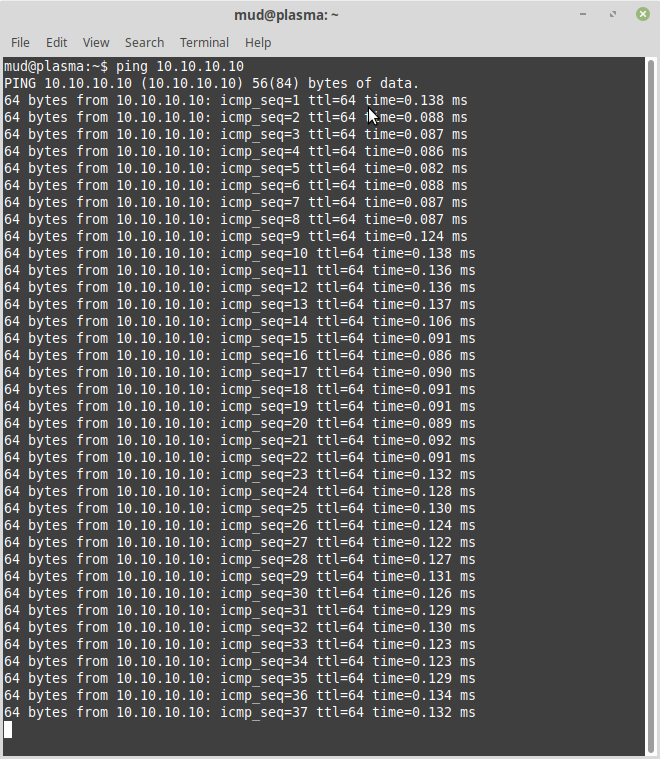

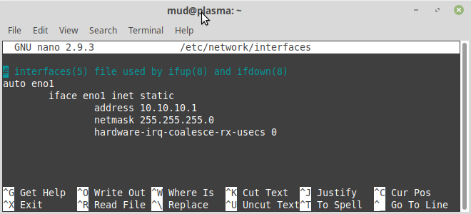

I disabled everything I could, and currently on Mint 19.1 with the 4.9 kernel the ping is around 0.13ms (pic attached). I'm still getting joint errors though. I've attached a grab of interfaces for an idiot-check.
I also have a Realtek NIC in a PCI bay - is it worth swapping over the NICs?

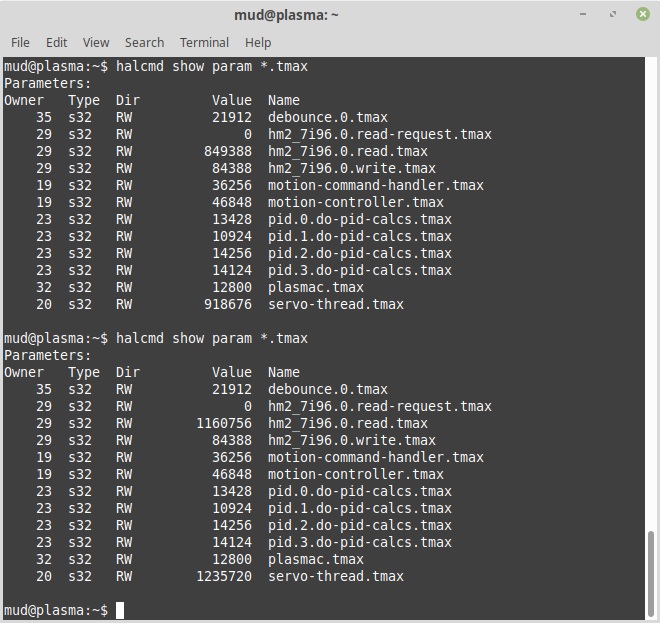

04 Sep 2020 19:12 - 04 Sep 2020 19:18 #180736
Replied by PCW on topic Linux Mint - PlasmaC upgrade confusion
I mean after your changes
BTW you can get some information on whether this is a latency
related issue by looking at the maximum times of all the functions:
halcmd show param *.tmax
Last edit: 04 Sep 2020 19:18 by PCW.

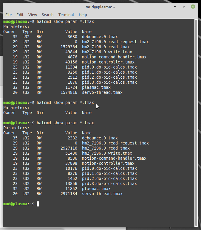

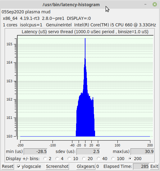

05 Sep 2020 06:56 #180783
by Mud
I ran the latency histogram (admittedly could have given it more stick/time), but it appears solid. Halcmd is pointing the finger at hm2_7i96.0.read and servo-thread (second table is after it threw a joint 3 following error).
I'm tempted to use the 19.2 ISO for a known clean foundation, unless you have any ideas

06 Sep 2020 03:54 - 06 Sep 2020 03:55 #180892
Unless you can find the source of the long Ethernet read times you may have to run at a 500 Hz
(2 ms) servo thread rate. My first guess of the cause is that AMT is not disabled

06 Sep 2020 09:26 #180919
by Mud
I tried this, but it didn't make a difference.
I did disable MEBx (which took some faffing), so I think AMT is off.
I tried a 2ms servo and if anything it seemed worse (attached)...perhaps just because it got to bigger values before erroring out. I initially doubled the P values but this would make it trip immediately. With P at 1000 it seemed fine homing and jogging, but I was getting some other error where it wouldn't run g code (apologies for not noting this error...red mist descending at that point and additional unknowns of newer software).
I'm trying to clean install the known Mint 19.2 now...just struggling with old PC problems (no USB boot, no PS2 keyboards around, incompatibility with thumb drives, no DVD-Rs around...gah...).
