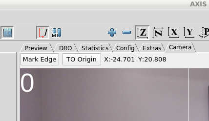

I have been messing around with this and I got rid off the SET Origin button which leaves the Mark button and TO Origin button.
It works like before:
jog to an edge, in either the X or Y direction from the origin corner
press Mark
jog to the origin corner
press Mark
thats it, all done.
To reset the rotation to zero:
press Mark
press Mark
thats it, all done.
To move torch to origin position:
press TO Origin
thats it, all done.
The one thing I am not sure about is when resetting the rotation should it:
1. leave the origin coordinate where it is and just set the roation to zero
2. move the origin point to the current torch position and reset the origin to zero
My preference would be 2
press Mark
press Mark
thats it, all done.
press Mark
press Mark
thats it, all done.
press TO Origin
thats it, all done.

Replied by rodw on topic Camera For Touchoff
Sounds great.
My thought would be option 1.
I think that if you are clearing the rotation, that sheet is cut so the next button to be pressed is probably load sheet.
eg. in a busy environment, you'd plonk a sheet down, align, it, cut it out, then load another sheet. You would not want to waste unnecessary time moving to the origin again. Which then raises a question, should load sheet also clear the rotation?
I wonder what the others think?

19 Sep 2020 04:26 #182705
by phillc54
Replied by phillc54 on topic Camera For Touchoff
My thinking was that you would only need to clear the rotation when you want to set up a sheet that you know is square (or close enough for the new job) then all you do is move to the origin of the material and press the "Mark" button twice.
If you load a sheet that is not square then you need to do a correct jog, Mark, jog, Mark sequence regardless of what the rotation value is.
Like everything, probably comes down to personal choice. At least this way it is touchscreen friendly.

Replied by tommylight on topic Camera For Touchoff
2.
I also get the reasoning from Rod, so whatever you decide i am good with it.
Maybe I can make it either.
When I first did it I had #1 but afer playing with it on my table I ended up with #2 and that felt more comfortable for me.
