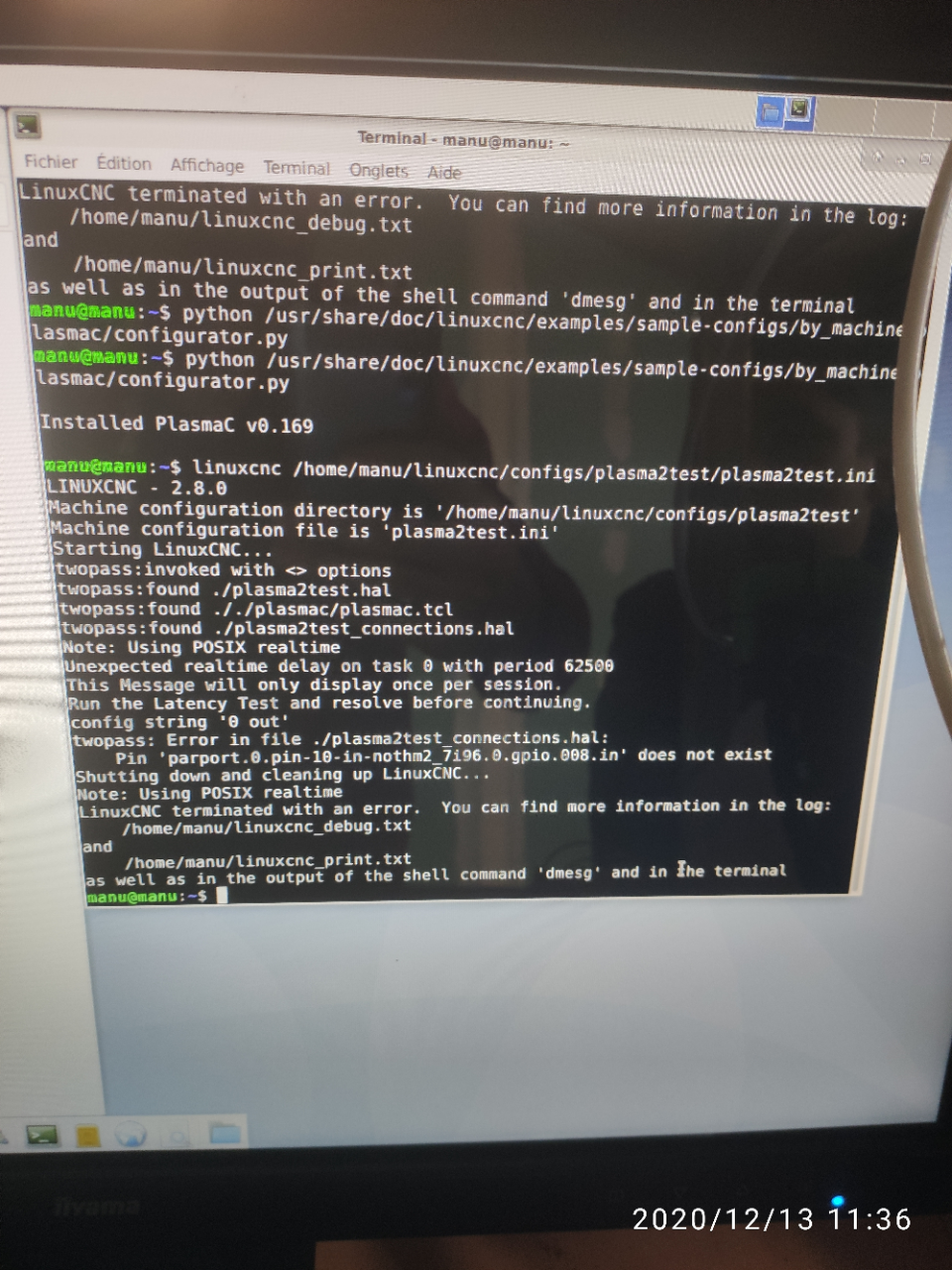

hello
i'm trying to configure plasmac but i can't do it there is an error message

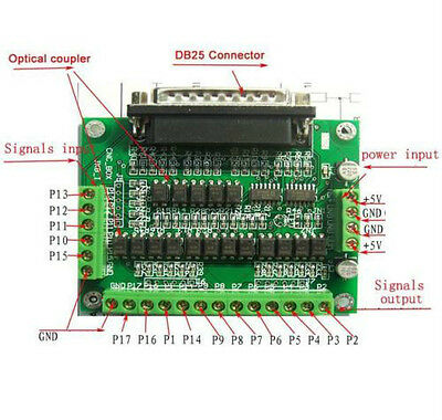

I use a parallel port card as in the photo below
Thanks for your help

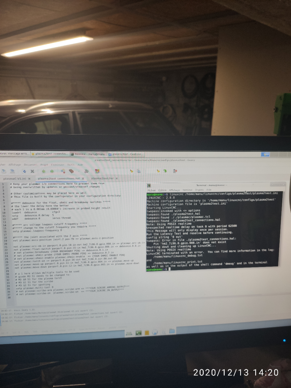

You have two lines together in the plasmac_connections hal file.
Separate those lines.

That wont work, you have the same pins used for parallel port AND a Mesa 7i96 ?????
Make a new config, use stepconf, NOT pncconf.
After you get that running and tuned properly, make a copy and use the configurator for PlasmaC

I will update the user manual to make the parallel vs mesa examples stand out a bit more to make this a bit more clear
