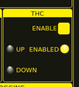

What is the state of the enabled switch and LED on the THC frame on the MAIN tab?
Do the up/down LEDs on the THC frame on the MAIN tab change state while cutting.
Can you post the file made from the BACKUP CONFIG button on the SETTINGS tab.

hello the switch is activated, the up and down LEDs do not change state during cutting

It would be helpful to see a video of the screen while cutting like Tom asked. Also could you monitor the HAL pins plasmac.move-up and plasmac.move-down while cutting.

I found, you must not check ignore arc ok otherwise the thc does not work
I set the step db arc-ok delay to 5000 otherwise I had arc ok lost
The THC adjustment is not linear, rather sawtooth, what do I need to adjust?

21 Nov 2023 01:42 #286133 by phillc54
Replied by phillc54 on topic plasmac message error
Yes, that is correct.
That seems to be quite a large value, have you tried doing it this way.
The only adjustment for external THC's from within QtPlasmaC is THC Speed%.
