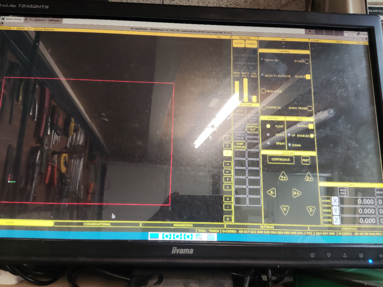

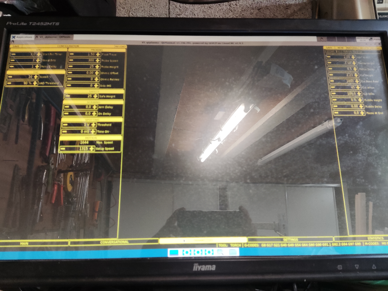

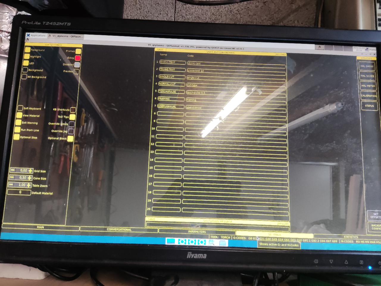

- beauxnez
- Posts: 149
- Thank you received: 10
17 Nov 2023 19:30 #285769
by beauxnez
Replied by beauxnez on topic plasmac message error
- beauxnez
- Posts: 149
18 Nov 2023 17:19 #285843
by beauxnez
on this video the indicator light changes state, but during cutting the z axis does not move
youtube.com/shorts/GhhmnHPuJrc?si=JU2VTkRjP1UefgUK
youtube.com/shorts/ulZATeGu84Y?si=AgfooD_-yY2tWkUS
youtube.com/shorts/3ReyuTtqHe8?si=Bk5GRRqgwnAMhiPl
