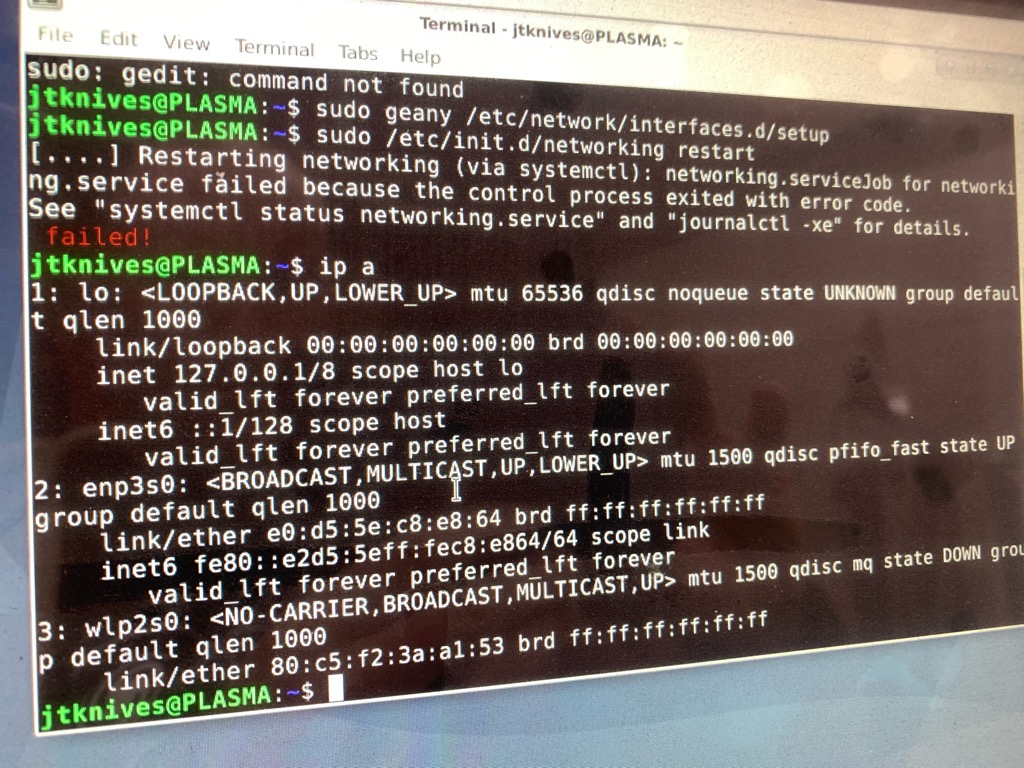

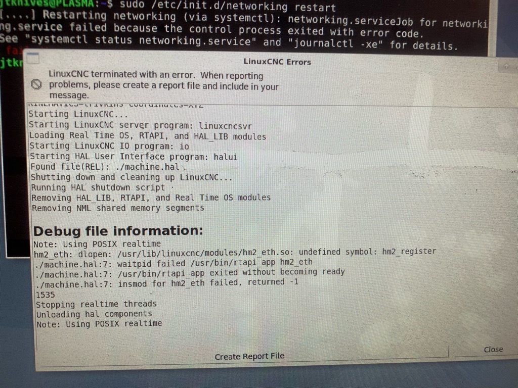

well I thought I got it all switched over correctly but something is wrong. I blasted through the pncconf to set up the files. then looked at my old ini and hal files and made the changes to the new files. But like I said something is wrong and I'm guessing its because I transferred something over that's not longer supported. here are my new files that I'm trying to get to work. in the next post I will post my old files from my working set up. it said something about a spindle var not found so i removed that from the file and retried but then it gave me another error. I also will attach both error reports. thank you

First report something with network not OK.
The second report with 1 in the name, missing Spindle entry in the TRAJ section of the ini file.

To echo what Tommy said, your new .ini is missing a spindles line in the [TRAJ] section.
Adding the following line to the [TRAJ] section of the new ini ought to do it: SPINDLES = 3
To help you understand why your old machine works and this one doesnt, your old machine .ini doesnt have the spindles line either, but ti doesnt fault old because your old hal file does not mention spindles in this line:
your new one has spindles in that line:
Make sense?
loadrt [EMCMOT]EMCMOT servo_period_nsec=[EMCMOT]SERVO_PERIOD num_joints=[KINS]JOINTSyour new one has spindles in that line:
loadrt [EMCMOT]EMCMOT servo_period_nsec=[EMCMOT]SERVO_PERIOD num_joints=[KINS]JOINTS num_spindles=[TRAJ]SPINDLESMake sense?

If these are your based machine files then you don't need num_spindles=[TRAJ]SPINDLES in the Hal file, it will be put in by the Configurator.

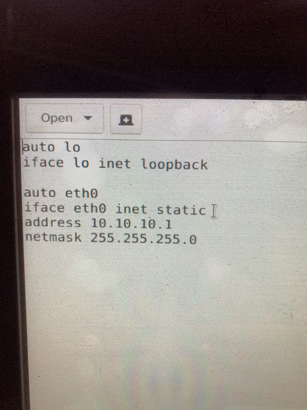

The reason there are 2 error files is when it gave me the spindle error I removed the spindle and retried and it game me the network error. My board is set to 10.10.10.10 and it’s correct in the files but I completely forgot to set it to that using a terminal. So that would explain my network issue. Thanks guys
