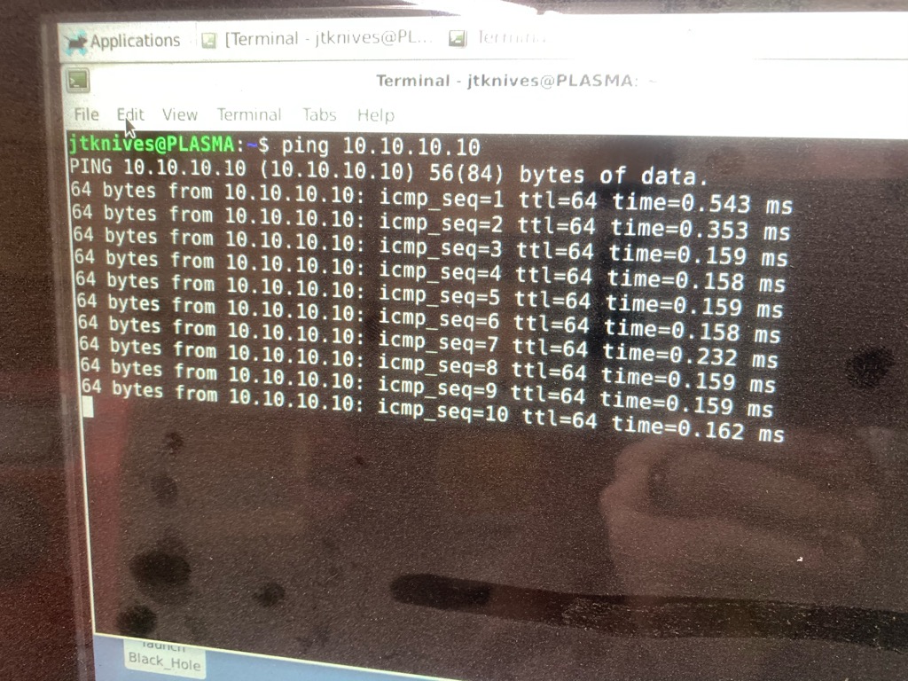

Can you type ping from a terminal. ping 10.10.10.10 to see if you get a response from the card

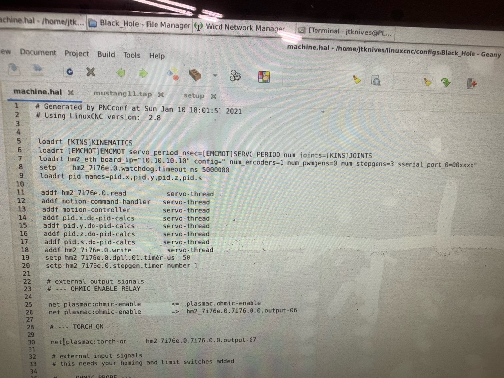

The error seems to show line 7 of the hal file.
So post your ini and hal files.

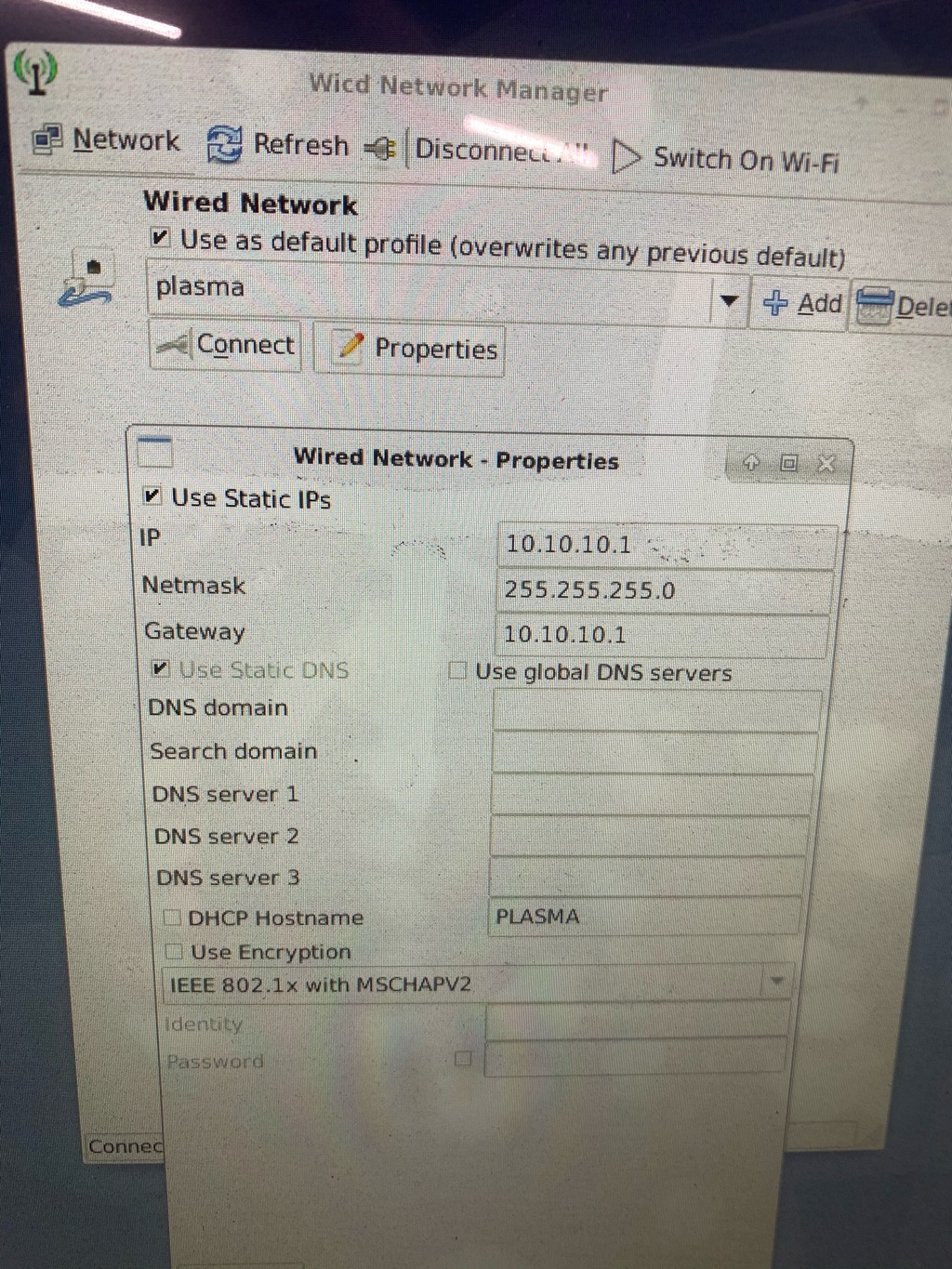

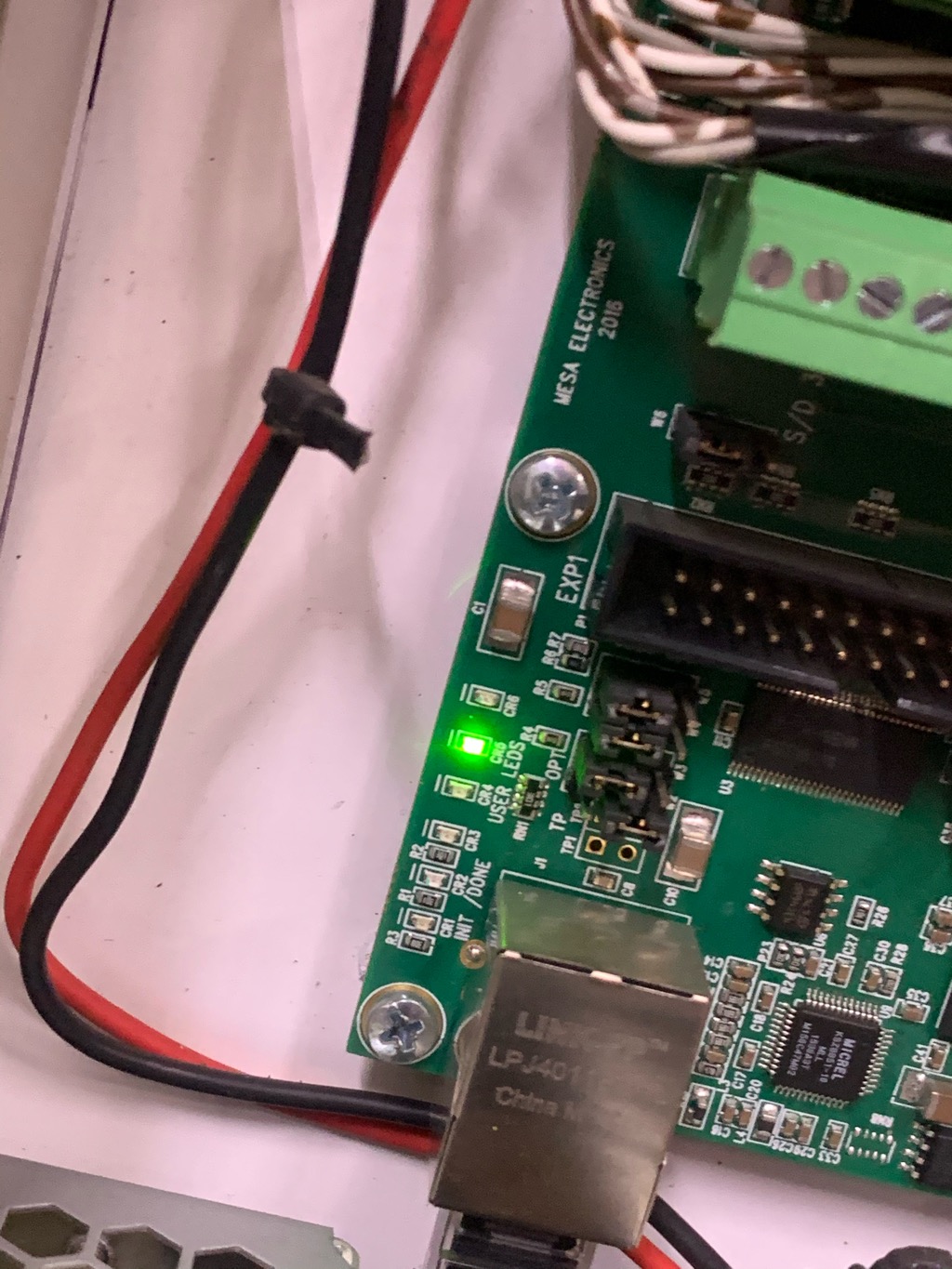

So I messed around with it again today and was able to get it to ping the board after a bit of playing with the network stuff. but still get that same error for line 7. Here is my hal file and a few pictures to show what i did to get a solid ping.

12 Jan 2021 20:39 #195116
by JTknives
Replied by JTknives on topic I’m lost and way behind on updates

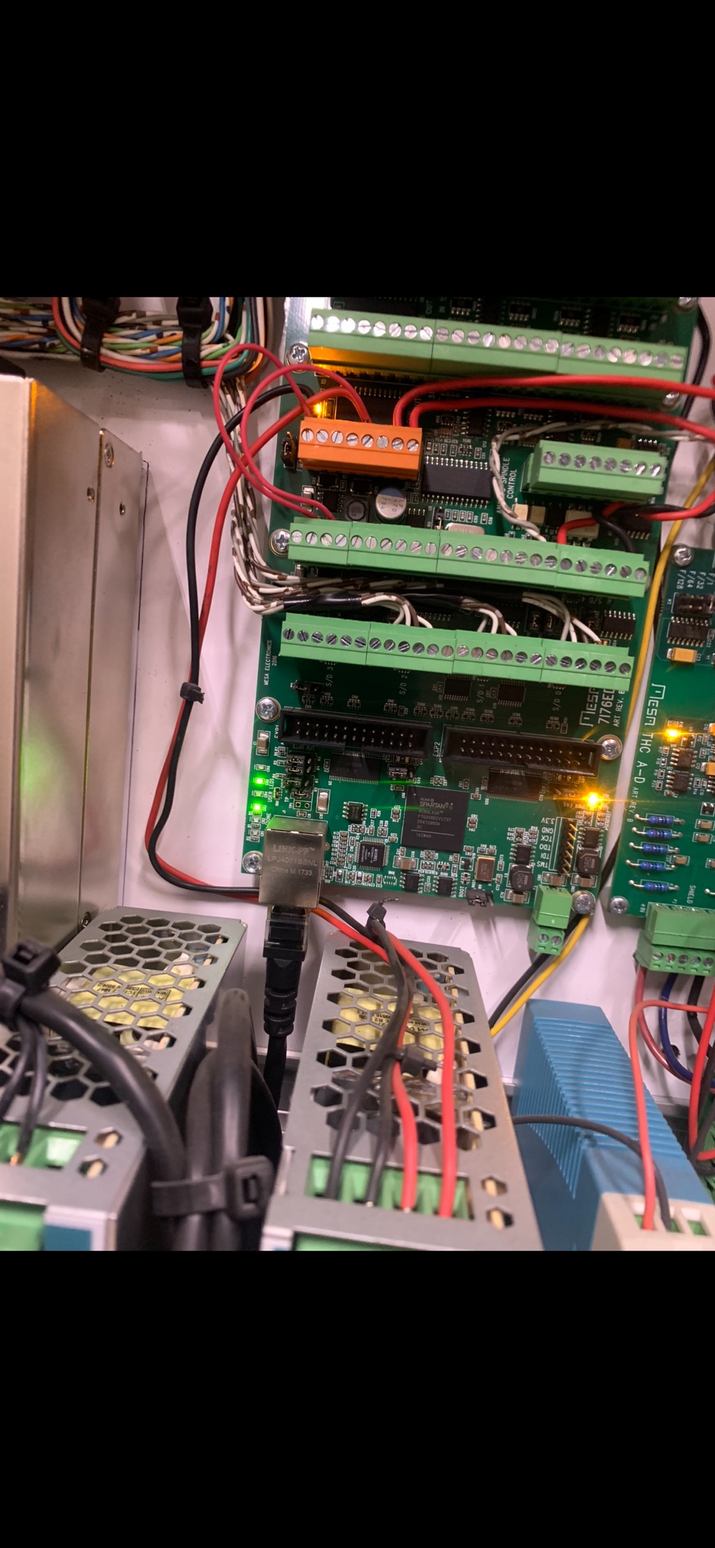

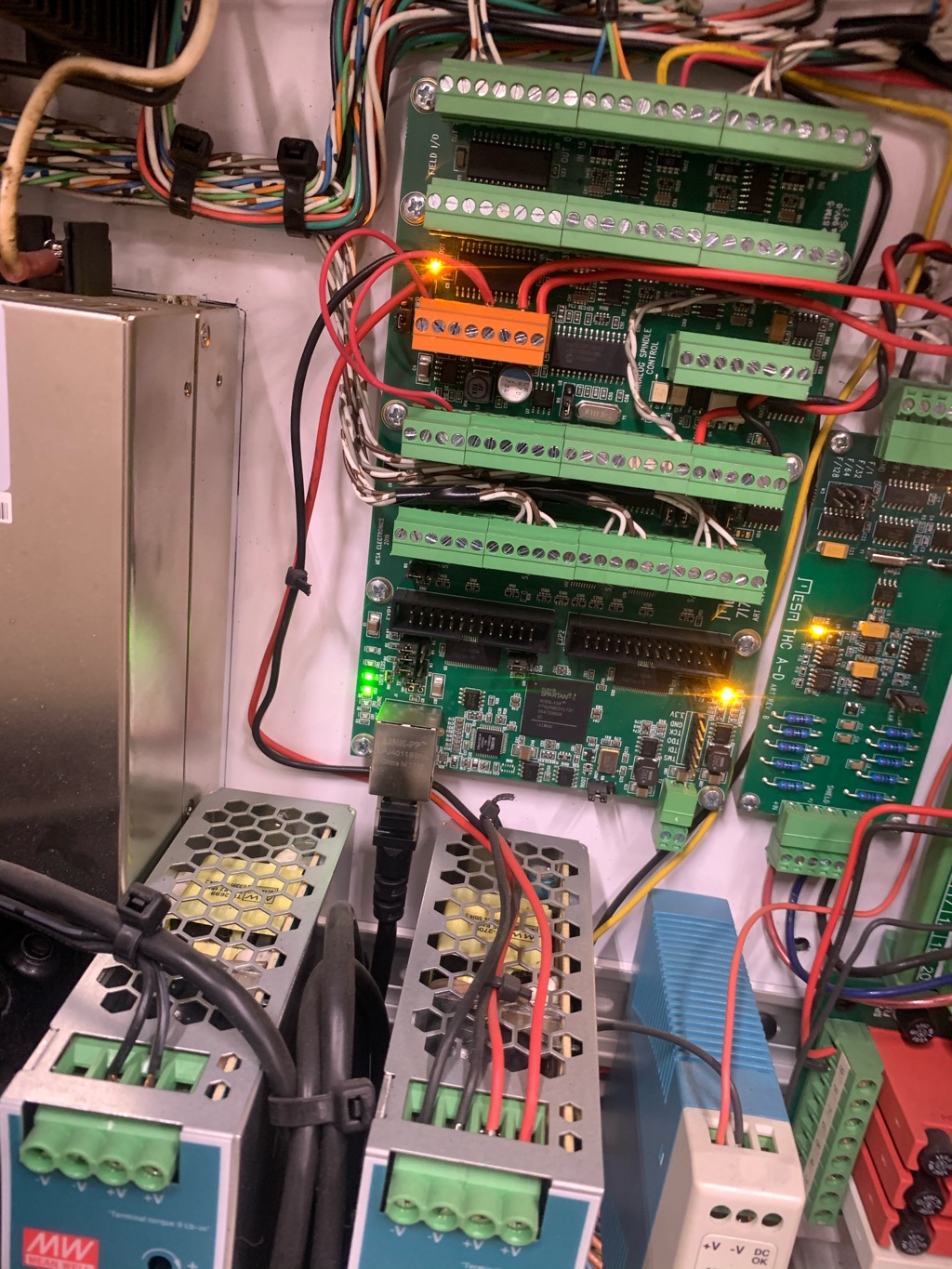

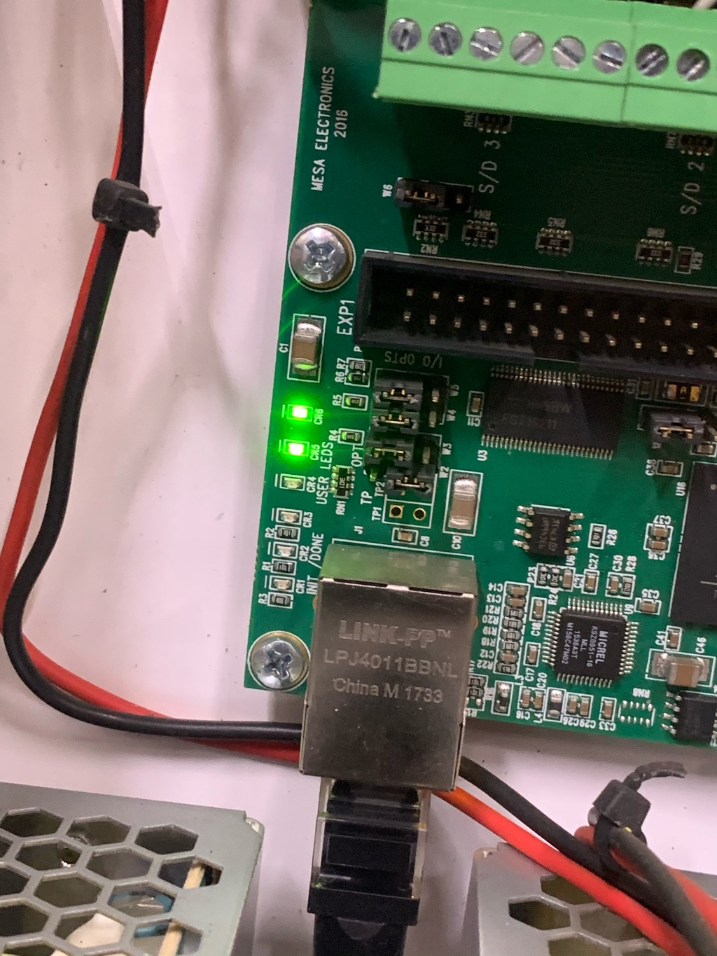

Here are the images of what I did

- Posts: 21944
- Thank you received: 7471
12 Jan 2021 22:01 #195131
Replied by tommylight on topic I’m lost and way behind on updates
Change the IP to
10.10.10.11
and what is the error now as i've lost track ?
10.10.10.11

Something with
„Unknown character“ with hm2_eth in line 7

I have seen PCW mentioning the graphical network tool wicd you are using is useless and he suggested installing another graphical network manager. I will say this was so simple in Mint the other day.
This thread appeared with a search for wicd
forum.linuxcnc.org/27-driver-boards/4102...-doing-wrong?start=0
