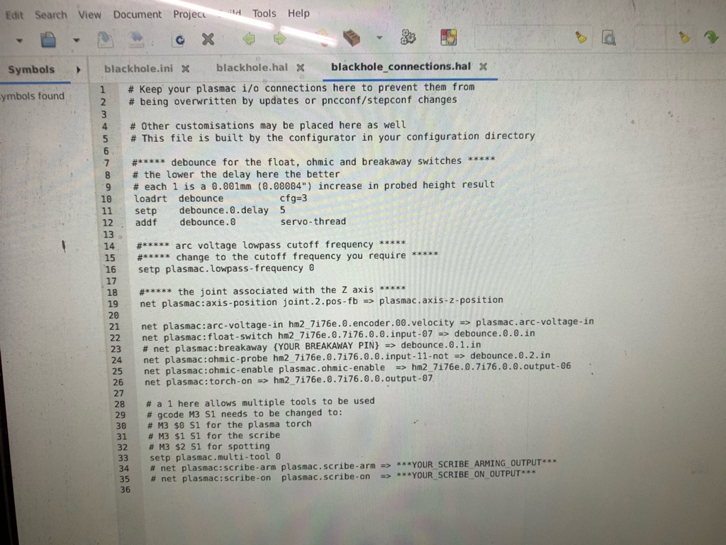

I started up my good hard drive and yep no connections file. I looked in my machine.hal and all my pins are in there. I then started up the other hard drive and in the origanial installation there is a connections file. So I opened that up to make changes to it but it’s missing pin call outs and I’m not sure how to start the program to just change this file.

If you are starting with a fresh hal and ini file from pncconf then use the configurator. Follow the install procedure from the user guide.

Ok that was way easier then the first time i set it up. I just started over and went step by step and presto it worked. I did not start out that way because the first time i installed this a few years ago a lot of stuff had to be entered manually. but now its crazy simple as long as you know all your pins and ratios going into it.
I have one final weirdness that is causing a head scratcher. Everything works as it should except its not reading any voltage. When I test fire the torch I get nothing showing up on my voltage. I set my Arc voltage in the configurator to
hm2_7i76e.0.encoder.00.velocity
and my voltage scale to .011526 & offset to 3644.0 (the new calculator says it should be 0.00757845 & 3,643.7500
I tried to run a file and it started the arc and just sat there till it timed out because it could not see the voltage. My plasma is a 45 XP set to 20 devider and my thcad is 0v=116.6Khz 10v 961.1Khz

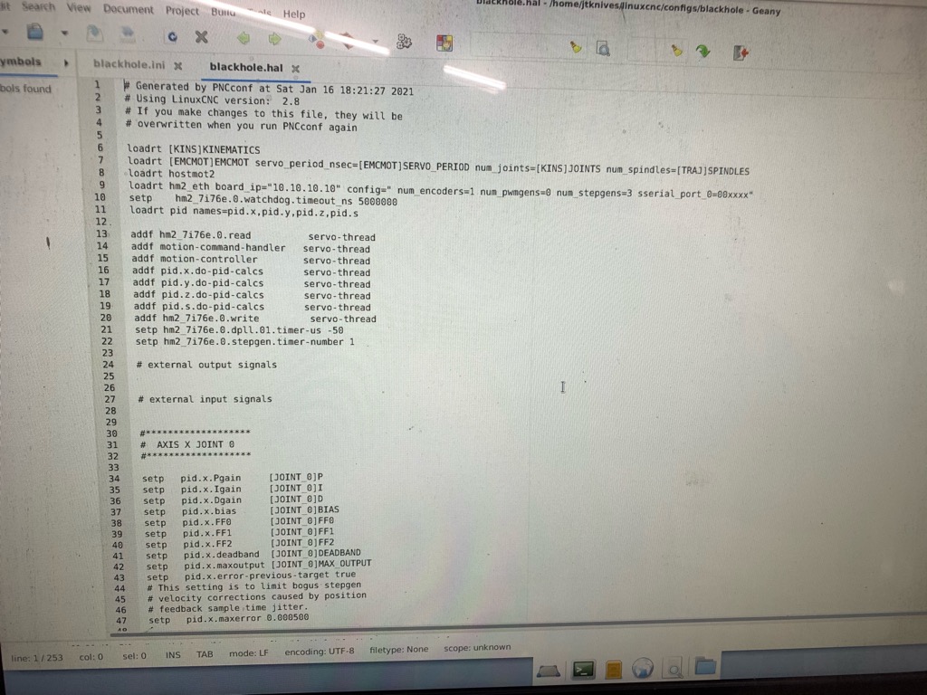

17 Jan 2021 07:41 #195636 by phillc54
Replied by phillc54 on topic I’m lost and way behind on updates
Did you add these in your hal file?
setp  hm2_7i76e.0.encoder.00.scale -1
setp  hm2_7i76e.0.encoder.00.filter 1
setp  hm2_7i76e.0.encoder.00.counter-mode 1

17 Jan 2021 08:01 - 17 Jan 2021 08:02 #195637 by JTknives
Replied by JTknives on topic I’m lost and way behind on updates
I did see that my old working hal file had that code but I was a little gun shy after butchering the Hal hand job the first go around lol.

17 Jan 2021 08:10 #195638 by phillc54
Haha, it gets like that...
You do need them, they set up the encoder.
