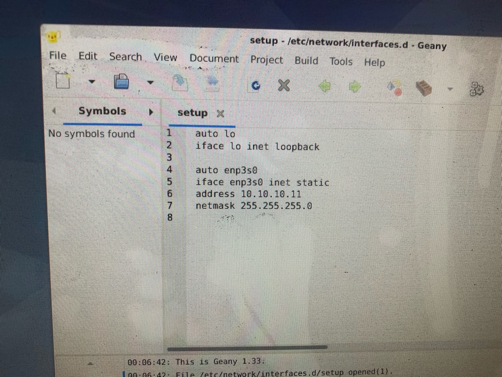

13 Jan 2021 13:38 #195218 by tommylight
Replied by tommylight on topic I’m lost and way behind on updates
Wicd is ok, the Mesa card can be accesed.

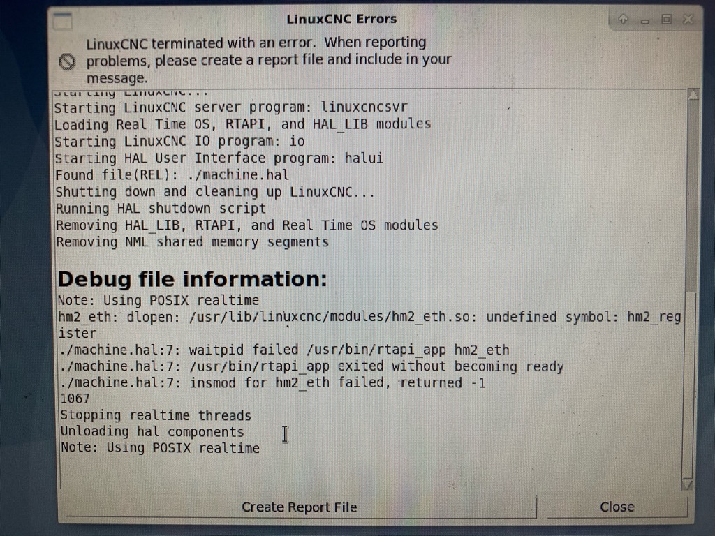

14 Jan 2021 04:43 #195283 by JTknives
Replied by JTknives on topic I’m lost and way behind on updates
Yeah I’m scratching my head and have no idea what’s going on. Probably going to have to ditch the Nice updates and go back to my vintage plasmaC.
14 Jan 2021 05:20 #195286 by phillc54
Replied by phillc54 on topic I’m lost and way behind on updates
What are the error messges in the terminal now?

14 Jan 2021 07:05 #195291 by JTknives
After I changed the IP address to the 10.10.10.11 it’s still the same. Something about unrecognized hm2 character and something about line 7 in my Hal file.

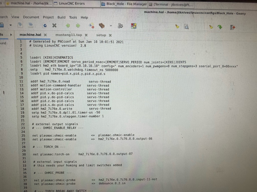

14 Jan 2021 07:07 #195292 by JTknives
Could it be the extra s on serial_port?
14 Jan 2021 08:08 #195294 by phillc54
That looks correct, this is mine:
loadrt hm2_eth board_ip="10.10.10.10" config="num_encoders=1 num_pwmgens=0 num_stepgens=5 sserial_port_0=00xxxx"
The only difference I see is the space before num_encoders
Can you look at the hal file in geany and turn on view line endings and whitespace and see if there is anything odd in there.
It also may be worth asking on this forum section: forum.linuxcnc.org/27-driver-boards

14 Jan 2021 08:40 #195295 by JTknives
I figured it out, I was missing
loadrt hostmot2
facepalm
So now everything try's to connect but I get pin errors now. Are pins called out differently now in the new update? I attached my hal and ini files as well. I'm

14 Jan 2021 08:47 #195296 by phillc54
This looks like it is your base machine before running the plasmac configurator.
There should be no plasmac related pins yet, they will be put in the <machine>_connections.hal file by the configurator.

14 Jan 2021 10:03 #195299 by JTknives
So thy are no longer in the machine.hal? That’s where thy where in my original set up.
14 Jan 2021 10:08 #195300 by phillc54
That is not normal. In a standard PlasmaC install they are in <machine>_connections.hal. It had always been this way. Your originals must have been hand edited.
