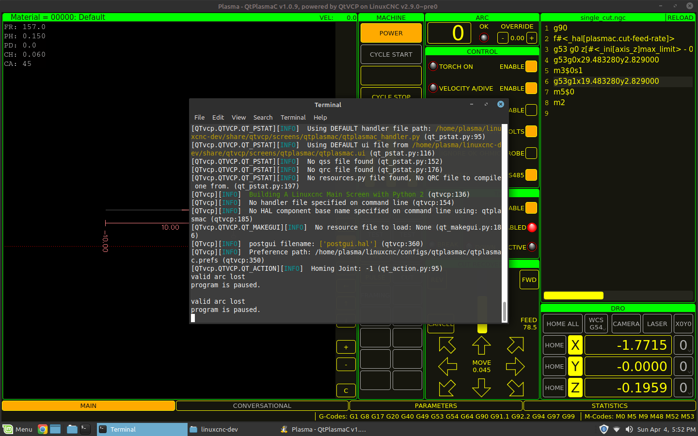

04 Apr 2021 18:00 #204793
by Nick7251
Replied by Nick7251 on topic QTPlasmaC Crashing bug report
Here is one of the terminal outputs when it crashed.

04 Apr 2021 20:39 #204809
by snowgoer540
Replied by snowgoer540 on topic QTPlasmaC Crashing bug report
I’m not seeing any errors in the terminal output. You lost the arc (which usually prints twice in terminal, not entirely sure why, but it’s normal), and then it looks like you closed (or the program closed itself) the program. But I’m not seeing what the qtvcp error is, and that’s what we would need to move forward.
As far as dropping the arcok during a cut by removing a wire... I’m willing to do that, but I think you could also set it false in halshow and achieve the same thing.
I may be able to do some testing after the Easter festivities are over.

04 Apr 2021 21:54 #204819
by snowgoer540
Lost the arc on a single cut by running it off the edge of the part.
It caused no problems. The error message is in the terminal, and it paused like it should. Caught the picture on a weird blink of CYCLE RESUME, but take my word for it, it was blinking
interesting, I am wondering if someone could remove the arcOK signal from their setup during a cut (pulling a wire) to replicate?

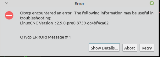

- Nick7251
- Posts: 57
- Thank you received: 10
05 Apr 2021 01:58 #204841
by Nick7251
Thanks all for your input, but please refrain from trying to fix the fact I am losing pilot arc. I have already resolved that problem. I am just reporting that when I was having the problem, instead of the software pausing like it should or like it does when I was on PlasmaC, it would throw an error, then any button I could click would close the software.
This time when I clicked show report, it actually showed the report instead of crashing. I guess I got lucky.
The error report says the following:
Then if I click abort, or retry LinuxCNC would close.
Also as far as being on the latest build. I am no linux guru, but I am pretty sure I am the most up to date I can be. I have seen this problem on builds starting with 1.0 to current. I just upgraded before duplicating the error for you all again tonight. Says I am on xxxx 3764 xxxxx QTPlasmaC v 1.09
I pretty much update anytime Linux tells me to.
File "/usr/share/qtvcp/screens/qtplasmac_4x3/qtplasmac_4x3_handler.py", line 933, in pause_changed
self.w[self.tpButton].setEnabled(True)
File "/usr/lib/python2.7/dist-packages/qtvcp/qt_makegui.py", line 345, in __getitem__
return getattr(self, item)
AttributeError: 'VCPWindow' object has no attribute ''Then if I click abort, or retry LinuxCNC would close.
