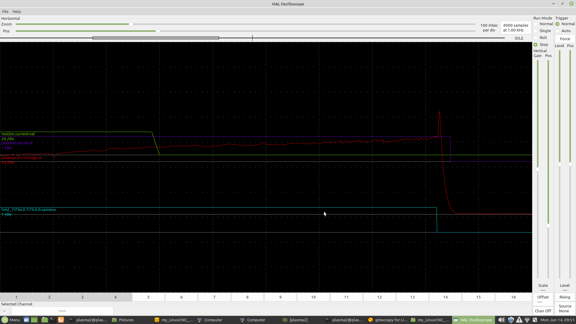

- Posts: 11970
- Thank you received: 4079
14 Jun 2021 00:12 #211979
Replied by rodw on topic Why is Plasmac and QTplasmac pausing at the end of a cut for no reason?
Well this is a plot of the end of a cut. There is a 0.5 sec delay from when motion stops until the torch enable (spinea) signal goes off.
A sample file is attached. If anyone has a pizza oven, here is your chance to make an ember scraper for it
I checked all the debounces and they are set to 5 so way less than what we see here.
This has not ben an issue before like this
Could it be the M67 before M5 causing the delay?
Using the Sheetcam post processor.
- Posts: 21681
- Thank you received: 7405
14 Jun 2021 00:27 #211980
Pretty sure it works in conjunction with motion, so if using it for torch on, i would change that promptly.
Or was it M68 ???
Replied by tommylight on topic Why is Plasmac and QTplasmac pausing at the end of a cut for no reason?
M67 ?Could it be the M67 before M5 causing the delay?
Or was it M68 ???
