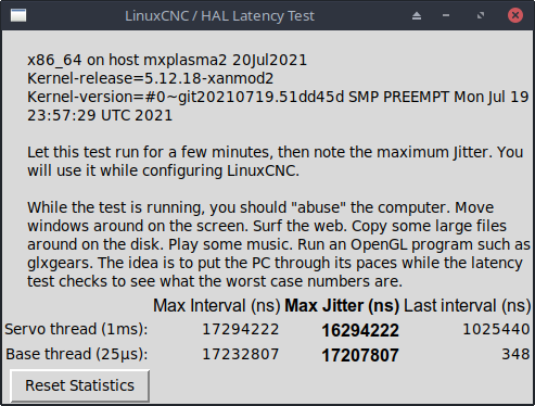

That doesn't look like the RT kernel.

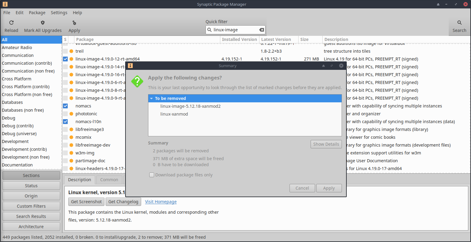

I think you are right
I wonder how I enable it after instalation?
$ uname -v
#0~git20210719.51dd45d SMP PREEMPT Mon Jul 19 23:57:29 UTC 2021I wonder how I enable it after instalation?

From the Grub menu pick advanced (I think) then select the corrcect Kernel. It will then remember which one used last.

NOw its worse
NOw its worse
uname -v
#1 SMP Debian 5.10.26-1~mx19+1 (2021-04-01)

Ok, had to use a wired keyboard to access the grub menu. Never been a problem before
around 20000 latency
If only I still had a wifi card that worked.... would isolcpus break that?
Not sure how to debug that. Its always just worked before.
