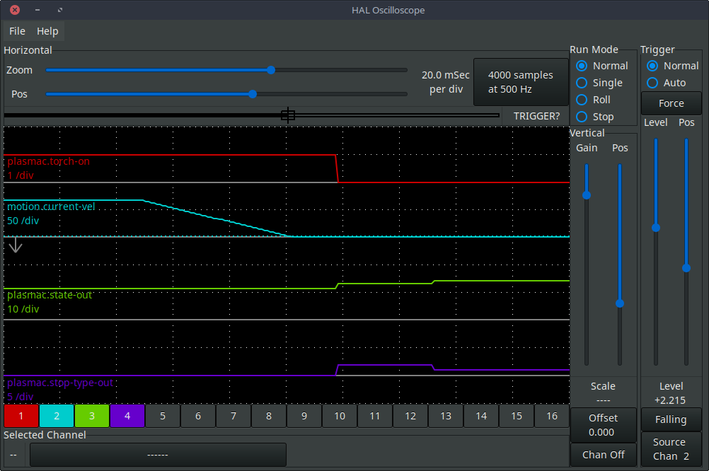

Why is Plasmac and QTplasmac pausing at the end of a cut for no reason?

14 Jun 2021 23:53 - 15 Jun 2021 01:23 #212072
by snowgoer540
Replied by snowgoer540 on topic Why is Plasmac and QTplasmac pausing at the end of a cut for no reason?
Just had a look at the cut file you posted.
Your temporary material line is this:
(o=0, ph=4.1, pd=0, ch=2, fr=2239, th=1, cv=99, pe=0.5, jh=0, jd=0)
pe = Sets the pause at end delay.
So your temporary material is set to have a pause at end delay of 0.5 seconds.
Perhaps it got set by accident, or there is an error in the post?

15 Jun 2021 10:56 #212110
Thanks for the eagle eyes. I must have the post set to use temp settings. It must be that way by default. I'll check that out. I would not have thought I had a pause in any of my Sheetcam tool settings.
There is still the issues that render QTplasmac unusable. Eg. cycle start issue mentioned earlier. To me thats a worry when the one that works for me is depreciated.
