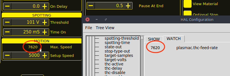

wrong scale thc of the z axis during cutting on qtplasmac
- snowgoer540
- Posts: 2561
- Thank you received: 891
22 Jul 2021 12:02 #215568
by snowgoer540
Replied by snowgoer540 on topic wrong scale thc of the z axis during cutting on qtplasmac
It's a pin, set by QtPlasmaC, it's just used to pass the value from the GUI to the PlasmaC component. It shouldnt appear in any hal file, it's "behind the scenes".
So you are saying that after you removed it from hal it shows as 0?

22 Jul 2021 12:09 #215569
by phillc54
Replied by phillc54 on topic wrong scale thc of the z axis during cutting on qtplasmac
- billykid
- Posts: 486
- Thank you received: 82
22 Jul 2021 12:11 #215570
by billykid
Replied by billykid on topic wrong scale thc of the z axis during cutting on qtplasmac
exact .. from gui I can set it to a maximum of 1000 but on hal meter it always remains at 0
- phillc54
- Posts: 5711
- Thank you received: 2100
22 Jul 2021 12:15 #215571
by phillc54
That is strange, did you run it from a terminal and see if there are any error messages.
- snowgoer540
- Posts: 2561
22 Jul 2021 12:18 #215573
by snowgoer540
This also doesnt make sense since your MAX_VELOCITY for [JOINT_2] is 25.0. This means that you should be able to set it to 1500mm/min. Unless you changed your .ini since you posted the backup...exact .. from gui I can set it to a maximum of 1000 but on hal meter it always remains at 0
The following user(s) said Thank You: billykid
- phillc54
- Posts: 5711
22 Jul 2021 12:21 #215574
by phillc54
Setup speed is NOT thc-feed-rate.
thc-feed-rate is always at the max velocity shown in the GUI.
- snowgoer540
- Posts: 2561
22 Jul 2021 12:23 #215575
by snowgoer540
But he said he can only set "it" to a max of 1000. From his .ini file I believe that max should be 1500.
Correct, that's what I'm tracking.Setup speed is NOT thc-feed-rate.
- phillc54
- Posts: 5711
22 Jul 2021 12:26 #215576
by phillc54
Yep, that is correct.But he said he can only set "it" to a max of 1000. From his .ini file I believe that max should be 1500.
- billykid
- Posts: 486
22 Jul 2021 12:30 #215577
by billykid
nothing has changed in ini file and max speed and setup speed are both at 1500
- phillc54
- Posts: 5711
22 Jul 2021 12:34 #215578
by phillc54
Have you run it from a terminal and checked for errors on startup?
