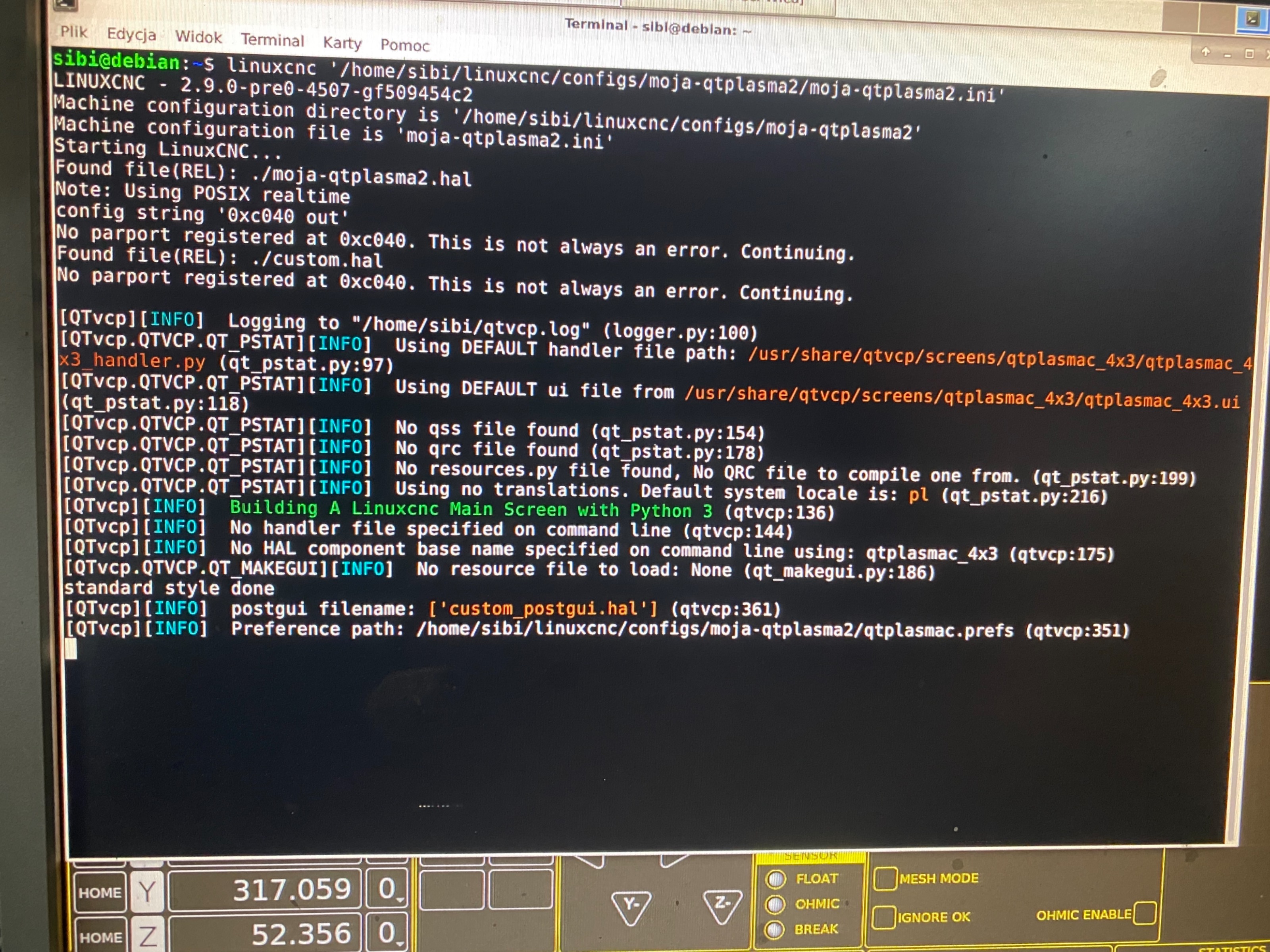

Hello . Yesterday updated to version 1.0.72 and the Z axis stopped responding to signals from thc. Up and down lights do not come on. the burner is kept at a constant height above the metal sheet. Today i installed 1.0.73 and it's the same effect.

26 Aug 2021 11:03 #218786
by snowgoer540
Any idea what version you were on before you upgraded?
Can you post a backup of your config please?
I assume you are using Mode 2 (external THC)?
Replied by snowgoer540 on topic wrong scale thc of the z axis during cutting on qtplasmac

26 Aug 2021 11:17 - 26 Aug 2021 11:24 #218789
by sibista
Replied by sibista on topic wrong scale thc of the z axis during cutting on qtplasmac
Version 1.0.56 fixed the thc scale problem and everything was fine. I'm using mode 2. I want to backup config but I get an error: Traceback (most recent call last):File "/usr/share/qtvcp/screens/qtplasmac_4x3/qtplasmac_4x3_handler.py", line 1352, in backup_clickedself.dialog_show_ok(QMessageBox.Information, head, '{}:\n{}\n\n{}:\n{}\n\n{}\n'.format(msg0, logname, msg1, bkpName, msg2))NameError: name 'logname' is not defined

26 Aug 2021 11:26 - 26 Aug 2021 22:34 #218790
by snowgoer540
V1.0.56 was prior to a change that was submitted to split Modes 0 and 1 from Mode 2 in the plasmac.comp. I'd guess there is a bug there. Phill will have a peek at it I'm sure.
The backup error will also be corrected shortly. A massive amount of work was done to internationalize QtPlasmaC, and probably a few slipped through the cracks. In the meantime, you could just make compressed file of your config folder and post it here.
I would guess that based on the timing of versions, there's a bug in the plasmac.comp file, however never hurts to see the config folder.
