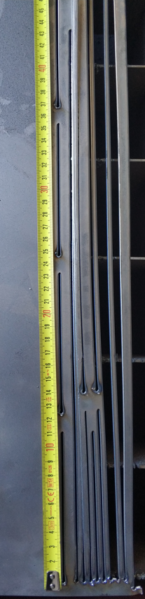

22 Feb 2022 11:38 #235512
by sharp_reaper
Testing a 1850mm line and it took 6 pierces to finish.
1 - 110mm
2 - 110mm
3 - 110mm
4 - 1110mm (10x longer)
5 - 110mm
6 - 230mm (end of line)
Replied by sharp_reaper on topic Valid arc lost & top limit is reached while THC moving up
Put the THC scale back to the calculated valued initialy and tested with THC Delay 0.5.I think it would be worthwhile just increasing the THC Delay to 0.5
Edit: Stay with Mode 1 as well.
1 - 110mm
2 - 110mm
3 - 110mm
5 - 110mm
