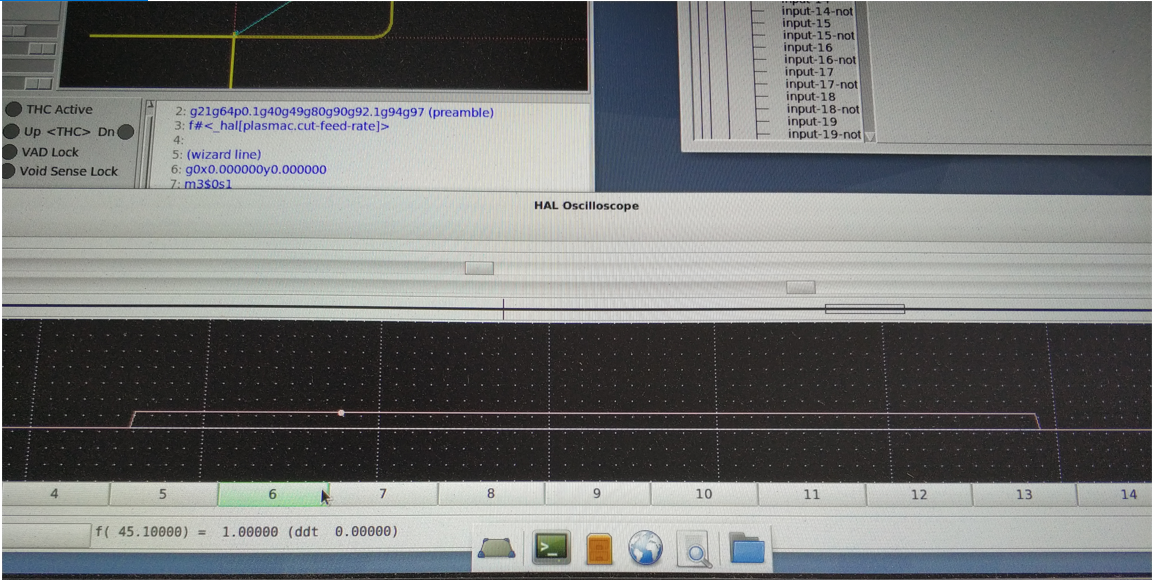

24 Feb 2022 15:40 - 24 Feb 2022 15:52 #235710 by sharp_reaper
Yes I'm in Mode 1.
Sorry I doesn't understand how it works hal scope very well here is a photo:
1 - I have tripled checked the Z axis scale and it's corret.
The commanded movement equals the distance movement of Z axis.
2 - Checked the connection of ArcOK and it's well tighten.
The ArcOK signal is a dry contact from Hypertherm cutter.
I have one cable in 24VDC and the other in the Input-15 of 7I76E.
From the cuts I think it cuts aproximadately the same amount when it shows the error.
3 - Changed to "setp db_arc-ok.delay 10" with THC enabled
EDIT: I've noticed that when Ignored ArcOK the voltage drops too much from 63 V.
I'm doing more test with Ignore ArcOK ON. It happened more frequently now the torch shuts off with almost the same lenght of cut but shows no error and continues to the end of the cut with the torch off (no stopping)

24 Feb 2022 15:57 #235713 by snowgoer540
hmm. Another thing I could suggest is double checking that your voltage is accurate.
Disconnect the torch voltage wires from the THCAD and take a known DC power source and hook to it (9v for example), verify that when 9 volts are supplied, 9 volts show on the GUI.
After that, it's silly questions, like does Page Up make the torch go up, and Page Down makes it go down.
I doubt anyone here has any experience with the new SYNC cartridges, but perhaps the THC delay needs to be longer for the voltage to settle with those. Try 1.0s, or 1.5s.
Otherwise, you could try changing the P value for the PID to 20, in case the reaction is too slow.

24 Feb 2022 20:03 #235739 by rodw
This is starting to sound awfully like intermittent behaviour due to oxidisation of the dry contacts  inside the plasma cutter because the high impedance circuit from the 7i76e input to ground (check the mesa manual). This results in a current less than the minimum spec passing through the contacts causing the oxidisation.
There are two ways to fix this, one is to use a pull down resistor between the 7i76e input and field power 0 volts to ensure the minimum current is exceeded. (What I do)
The other way is to add a capacitor to create a "spark" each time it operates to burn off the oxide.
Some others are vehmently opposed  to my views and I am not interested in creating an argument. All I can say I have personal experience of the frustration this causes. I am assuming that Hypertherm has used the same relay they have used in all their previous plasma cutters which is rated between 100 mA and 10 amps.
My recommendation is to use a HS10 100 Ohm 10 Watt resistor as the pull down. This will result in about double the minimum current. Expect a few cycles to burn off the oxide before reliable operation is restored.
If others propose  a different method or resistor value, just ask them if thy have any first hand experience with this particular issue before adopting their suggestions.
