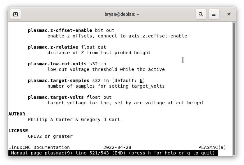

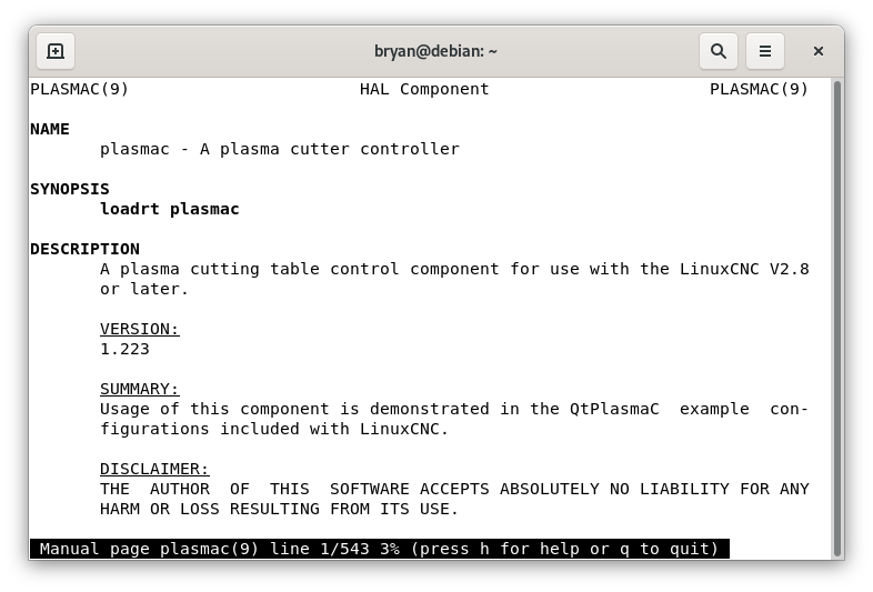

29 Apr 2022 19:36 - 29 Apr 2022 19:39 #241654
by Jalapeno56
"man plasmac" in terminal window yields what you see in attachment 1 and 2. A version listed as 1.223 and at the bottom is a date of 4/28/22. So I "think" its up to date, I just can't seem to find the post where someone was explaining why it doesn't show on my title bar. Also update 1.223.184 show hal pins put in alphabetical order per the update list from Phillc54, and mine are in alphabetical order. I think I'm going to take Rods advice and ride with my current software setup for now and try to focus on getting a THC that works.

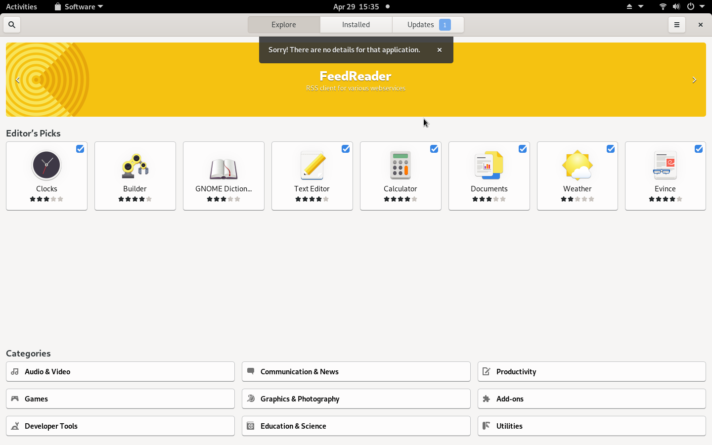

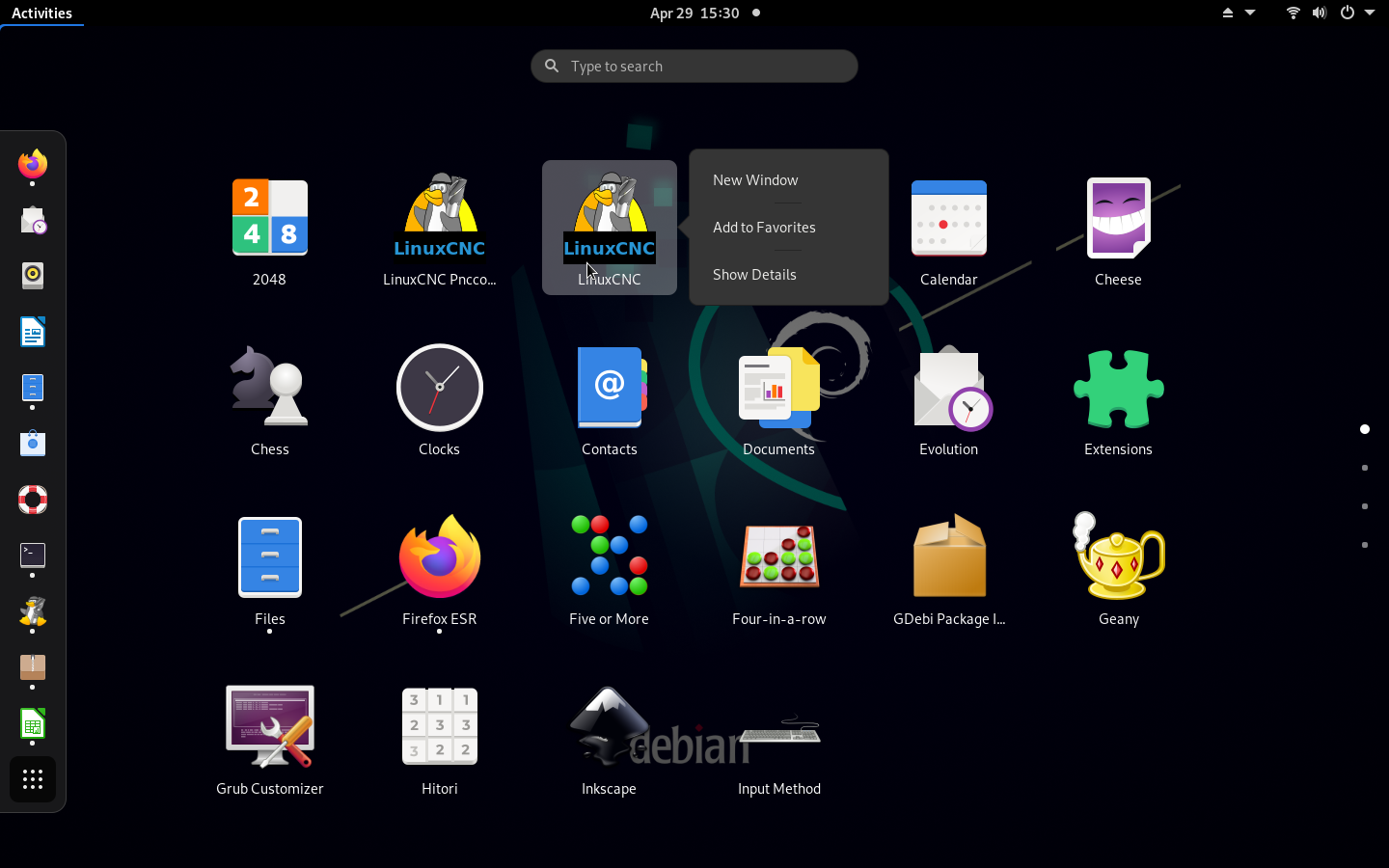

- Jalapeno56
- Posts: 101
- Thank you received: 17
29 Apr 2022 20:37 #241659
by Jalapeno56
Replied by Jalapeno56 on topic THC cannot keep up
I am using an icon to launch. It does not show properties, only "show details" as in attachment 1. Show details gives me a file explorer screen with a line at the top that says "Sorry! There are no details for that application" -Attachment 2

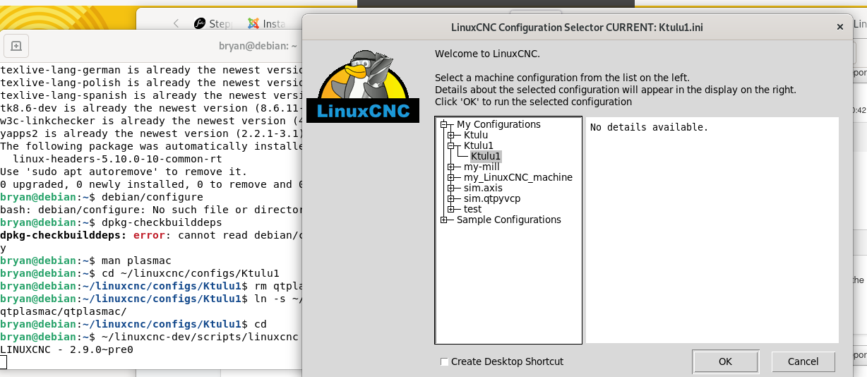

- snowgoer540
- Posts: 2580
- Thank you received: 907
29 Apr 2022 20:42 #241661
by snowgoer540
Replied by snowgoer540 on topic THC cannot keep up
I'm not on Debian 11, so I cant be of help to help you find the path it's pointed to.
But you could try this:
Open terminal and enter this:
If that works, you can pick your configuration from the "My Configurations" dropdown. Then see what your version says in the header.
~/linuxcnc-dev/scripts/linuxcncIf that works, you can pick your configuration from the "My Configurations" dropdown. Then see what your version says in the header.
- Jalapeno56
- Posts: 101
29 Apr 2022 20:49 #241662
by Jalapeno56
Probably not what you were hoping for....see attachment
It started Lcnc and just gave "LINUXCNC - 2.9.0~pre0" as an output on the terminal window
- snowgoer540
- Posts: 2580
29 Apr 2022 20:49 - 29 Apr 2022 20:50 #241663
by snowgoer540
you need to select your configuration and click ok to launch qtplasmac (with your config)
