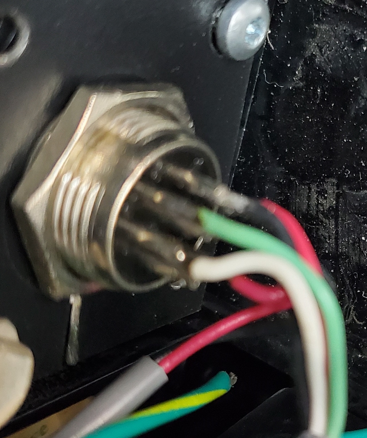

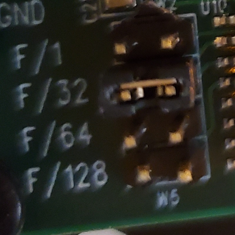

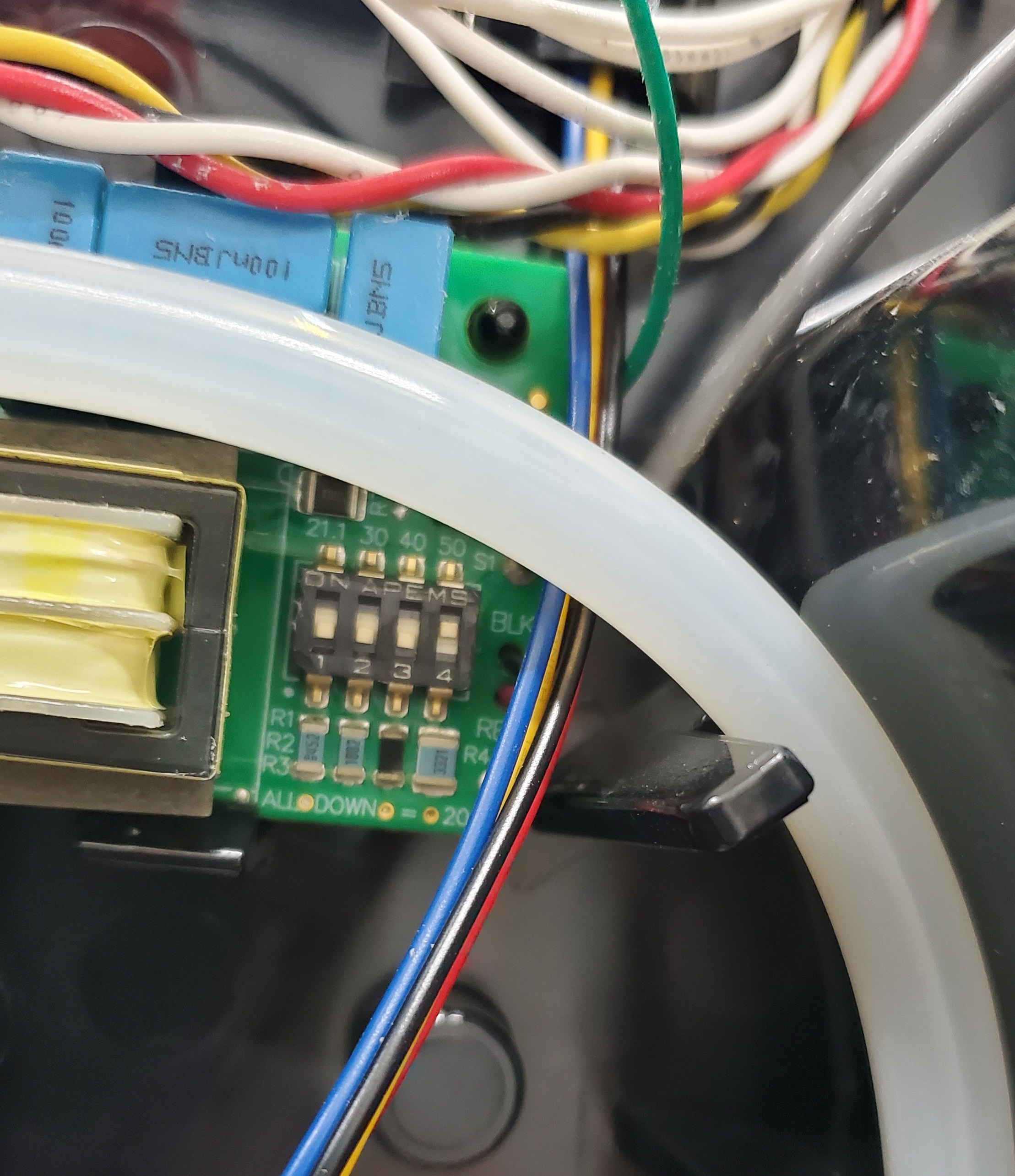

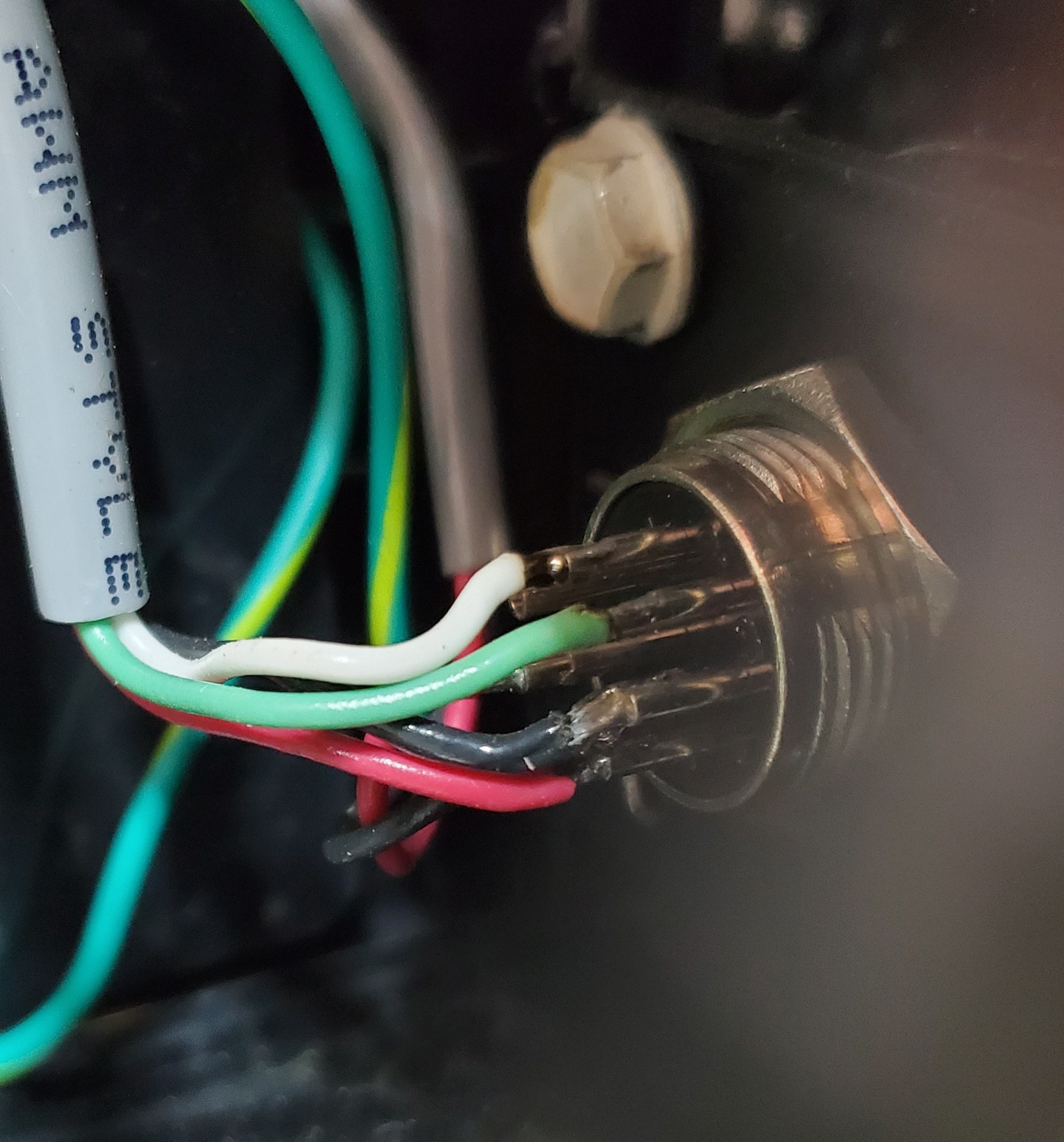

After re-flowing the solder joints on the board that holds the divider switches in the HT, I now have a working voltage divider. It took some re-tuning to get it to cut again, although the cut is not pretty. My encoder velocity is ranging from 10200 to 11800 during a cut. Maybe it will be more stable when I get the THC to behave. It raises and dives too much during a cut and finding the happy medium is eluding me again!
Edit: Maybe I spoke too soon on the voltage divider....
I had a VOM hooked up on the input of the THCAD_10, it showed ~2.6v during a cut which is about right for 40:1 @ 110v.
Putting a 9v battery on the input shows 361v. I am very confused now.....

Ok, I'm not confused anymore. A 9v battery test would be for using raw arc voltage. I am using a divider, so 361v with a 9v battery is correct.

I found another issue with my connection of the ground clamp from the HT (my fault). 1276 ohm resistance from clamp to work piece causes a lot of problems! I feel like the king of strange issues and doing things the wrong way! It cuts like a dream now, minus a bit of fine tuning.... My sincerest apologies to the HT team!
And, Yes, it is a new power source. I guess I am one of those people that look to fix the problem myself rather than wait a week for resolution.. I also am not sure if they would warranty it after I wired in my own cpc port....
