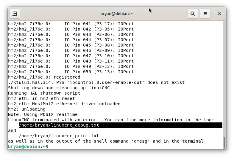

In other words, it would help if I followed instructions!
Failed with error about io control
see attachments
see attachments

Replied by snowgoer540 on topic THC cannot keep up
Well, at least this tells me that you likely running a package install from your icon on the desktop, and as such why the version is not up to date.
As for the error message, the specific error is this:
I am now curious about the directions you followed to build from source? And are you sure you followed all of the steps?
../Ktulu1.hal:314: Pin 'iocontrol.0.user-enable-out' does not existI am now curious about the directions you followed to build from source? And are you sure you followed all of the steps?

No worries, before we go too far down the rabbit hole, probably some things you can try before you start over:
1. In the synaptic package manager, uninstall the linuxcnc items. That will help absolve some of the "which did I launch?" confusion. Dont worry, it wont blow away your config folder.
2. it's fairly easy to start over with run in place and doesnt hurt anything. In a terminal do this:
After all of that is done, linuxcnc should be build from source correctly.
Then this command will run linuxcnc for you from terminal from now on:
Then try to run your configuration from the config picker again. We can go from there.
I would be willing to bet that your second question is my problem. I tried many different options, as one worked, I went with it and moved to the next. I didn't know about all the requirements and dependencies when I started. I chased rabbit hole after rabbit hole until I had a running machine. I have been working on the software side of this since last November... I have learned more in the past month or so about keeping all of my ducks in a row with Linux, but I may have already shot myself in the foot. I will be very disheartened if I have to start over, but I also understand it has to be right!
cd
rm -rf linuxcnc-dev
git clone https://github.com/linuxcnc/linuxcnc.git linuxcnc-dev
cd linuxcnc-dev/src
./autogen.sh
./configure
make
sudo make setuidAfter all of that is done, linuxcnc should be build from source correctly.
~/linuxcnc-dev/scripts/linuxcncThen try to run your configuration from the config picker again. We can go from there.
