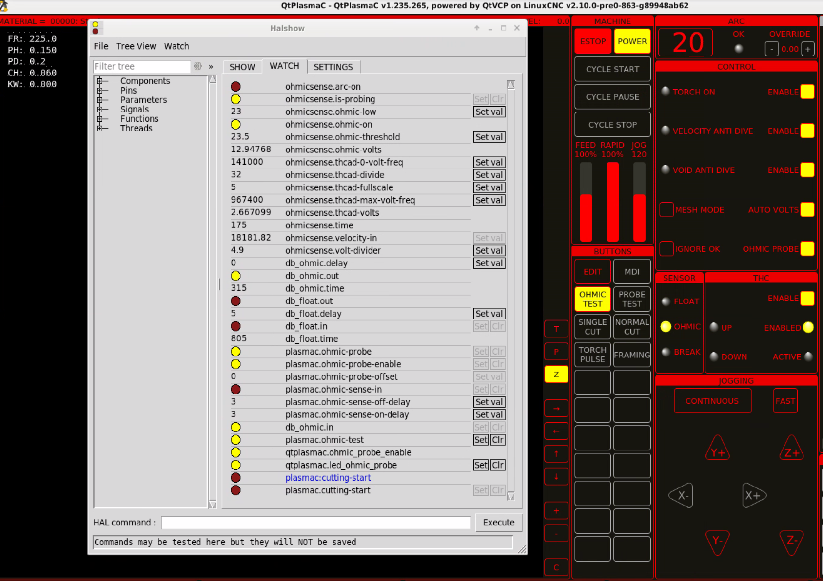

26 Feb 2023 10:04 #265400
by jimmyrig
So I may have found why you were having issues.
Below is a screenshot of an ohmic test with a slightly shorted torch. The torch is off of the table/material as noted by the 20ish volts of arc.
I am seeing a ohmic voltage of 13ish...... should be zero. not sure why this is, may play around with resistor values to see if it changes. Turning on or off the plasma doesnt change the values. regardless it shouldnt be tripping the ohmic at 13 volts but it is....... any idea why that could be?
Might be related to seeing some arc voltage and that's why you flipped polarity to avoid this issue?

26 Feb 2023 10:54 #265404
Replied by rodw on topic qtplasmac 2.10 arc ok, thcad thc, and Thcad Ohmic troubleshooting help needed.
The issue some had previously was on water tables and water got in the torch. In these circumstances, the voltage variation between on and off was closer to 0.5 to 0.2 volts. At the same time PCW suggested the 24k resistor to extend the voltage hysterisis.
Ohmic3 incldes a moving average algorithm so instead of using a simple low voltage threshold to sense an off condition (ohmic-low), it delares an off codition as soon as it sees a confirmed downward trend in voltage.
If your off is 13 volts, you might like to consider changing ohmic-low to say 18-20 volts.
This is where ohmic sensing gives you flexibility vs a relay. You have flaxibility to alter the on/off hysteresis to cover differing conditions. A relay might turn off at between 5 & 8 volts which would not work for your table.

26 Feb 2023 11:10 #265408
by phillc54
Replied by phillc54 on topic qtplasmac 2.10 arc ok, thcad thc, and Thcad Ohmic troubleshooting help needed.
If the torch is not touching the material then the voltage should be zero. If that is not the case then you should be trying to fix that issue rather than trying to work around it.
