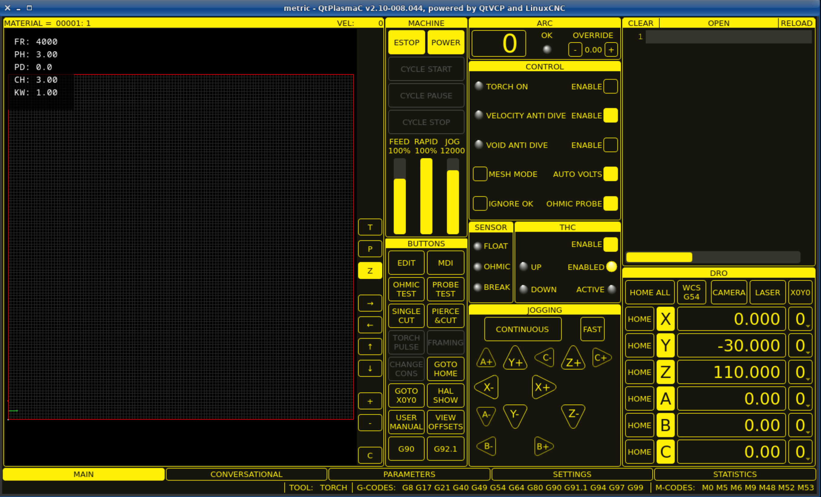

22 May 2024 06:58 - 22 May 2024 07:01 #301135 by phillc54
On another note what's the process for editing the UI? seems like the files are under the /lib folder. load them up in qt, edit and restart? I'm sure its more involved than that but not sure where to begin.
looking at adding an axis for the rotary (A) and bar feed (U) and need corresponding home buttons and read outs.
The A axis dro and buttons will appear if it is a valid axis in the config, currently XYZABC axes are catered for.
Warning: Spoiler!
For customising the UI, it is best to do it with a USER_COMMAND_FILE in python if possible as this will not get overwritten by any future updates. If the update issue doesn't bother you then the UI is a Qt Designer file and the handler file is a python file.
linuxcnc.org/docs/devel/html/plasma/qtpl...#_custom_python_code
was also thinking of playing around with blue line thickness that shows torch travel between cuts. Sometimes they can be hard to find if needing to restart.
The preview uses the QtVCP GCodeGraphics widget, I think you can change the colours but not the thickness. You may need to dig deeper for that.
linuxcnc.org/docs/devel/html/gui/qtvcp-w...idgets:gcodegraphics

23 May 2024 19:07 - 23 May 2024 19:08 #301247 by jimmyrig
Thanks, will look qt over the next few weeks as i dial things in. I got the latest code running on debian 10 and the A axis installed and wired up. (debian 12 was giving me latency issues ryzen 3600)
Went to run a file generated from sheetcam and got "g92 offsets are not allowed" error. Documentation seems to want a g38 instead of a g92.
Including the test file and sheetcam post, sent Les a link to this as well. Not sure which side this lies (should g92 be enabled when tube cutting is 1 or should sheetcam probe with g38)
