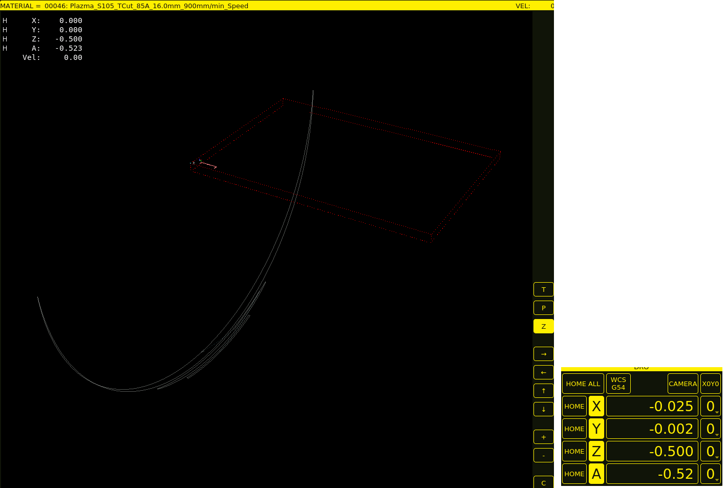

You asked: if you jog Y to something like 20mm then jog A around 360 degrees, do you see a circle?
No, I only see a line along the Y axis.
I've added two screenshots, before and after the move, as well as the coordinates.
Regards, Dmitry.

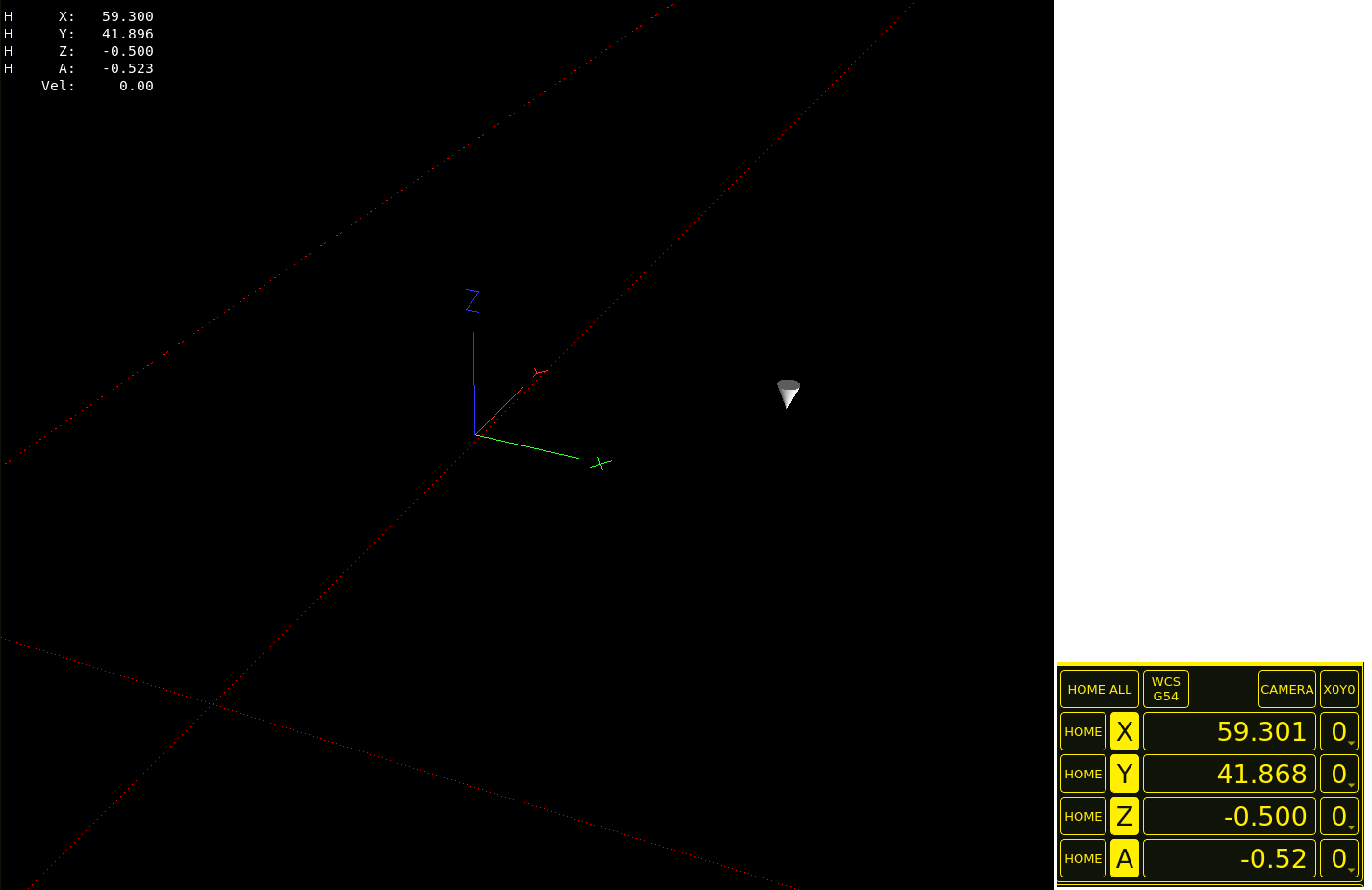

28 Sep 2023 05:44 #281769 by cmorley
Ok can you now do the same in Z (jog Z up and then jog A all around)

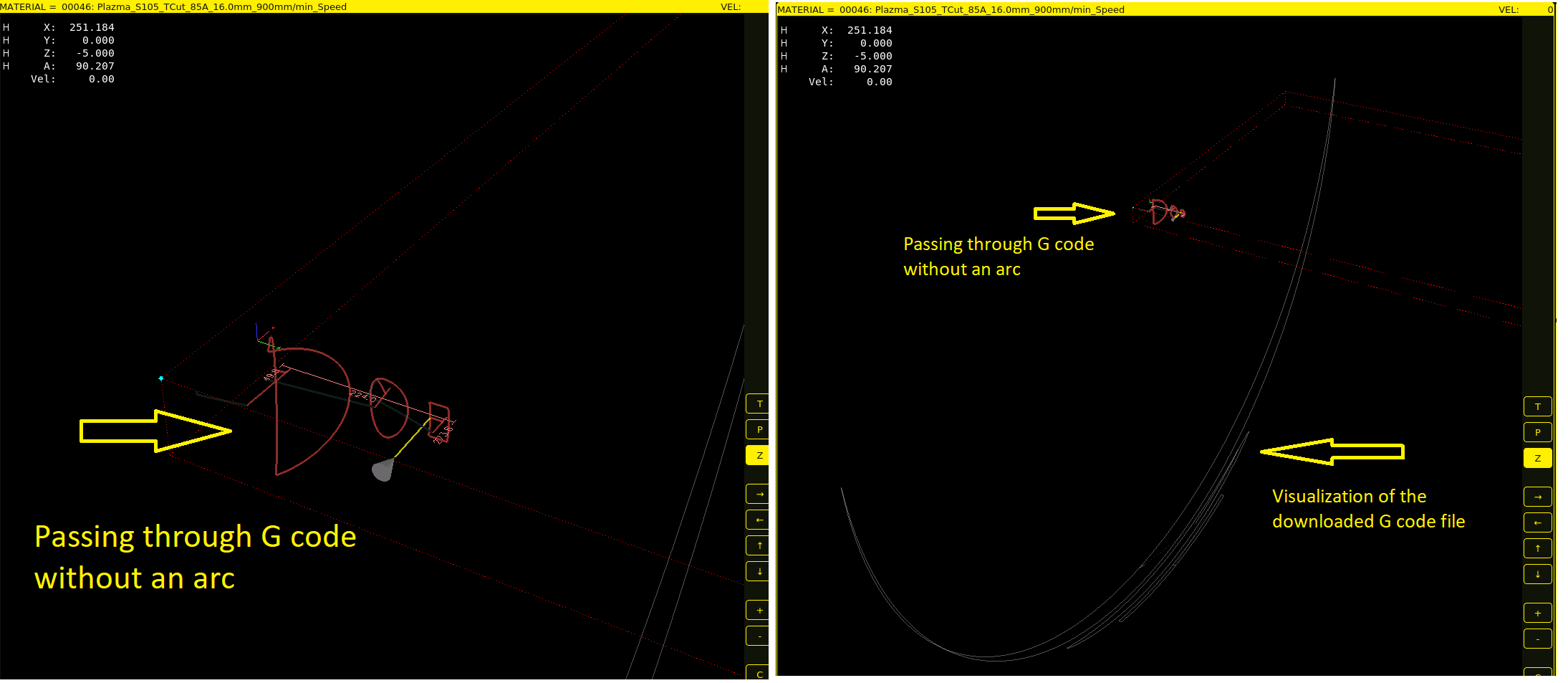

03 Oct 2023 10:22 #282148 by DmitryKV
Hello.
Sorry, I got caught up in routine and couldn’t answer right away.
I took several screenshots, they are in the archive.
Regards, Dmitry.

03 Oct 2023 13:31 #282159 by scotth
Dmitry
This may be the problem I described in Axis.
forum.linuxcnc.org/38-general-linuxcnc-q...-9-part-display-axis
Scott
04 Oct 2023 09:58 #282261 by DmitryKV
Hello.
Scott, thank you very much. Your advice helped reflect the G-code and this is what happened.
I added the line GEOMETRY = A!XYZ to the INI file.
This is a screenshot after I load the G-code. The drawing is very large in relation to the size of the table.
Tell me, what could be the reason for this difference in scale?
Regards, Dmitry.

04 Oct 2023 13:49 #282285 by scotth
I have no idea on the scale problem. I see it in AXIS and also QT Dragon.
04 Oct 2023 15:23 #282293 by Aciera
From the documentation:
This provision applies for liveplots only — G-code previews should be done with zero G5x, G92 offsets. This can be facilitated by setting offsets in programs only when task is running as indicated by #<_task> == 1. If nonzero offsets exist at startup due to persistence, offsets should be zeroed and preview reloaded.
So in order to see the preview correctly you need to set your work offsets to zero and reload the gcode or switch to a different work offset that is set to zero and reload.
