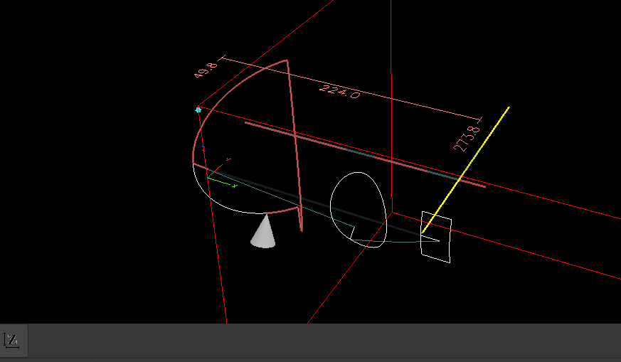

Hello.
You asked for a G-code file. I am attaching the file.
You mentioned offsets that need to be set to zero. This is also stated in the documentation.
Could you tell me more about this, I have never worked with offsets before. And I can’t quite imagine how and where to do this. What is written in the documentation is a little florid for me. Is it possible to say this in simpler terms?
Regards, Dmitry.

Replied by Aciera on topic Is it possible to display the cutting path in 3D in QTPlasmac?
Not sure how things work regarding the Z-hight in plasma so I'm not sure this is a valid solution for you:
Presuming a pipe diameter of 150mm you would need to change the cutting hight from Z0 to Z75 in the gcode then you load the gcode with work offset in y,z= 0 (MDI: g10 l2 p0 y0 z0)
this should give you a correct preview of the path.
Then to get a proper live plot you need to set the work offset for z = half the pipe diameter (MDI: g10 l2 p0 x0 z-75) Note you could also have an offset in X here if you wanted.
This is the result I get:
I'm afraid that is the best solution I can come up with for the moment.

Also for future reference:
Currently there seems to be a bug in the A! rotation code in the sense that the z work offset is only interpreted in inches. Users working in inches can load gcode with Z height set to zero (Z0) and get a proper preview and liveplot by setting the z workoffset to 1/2 of the pipe diameter.
