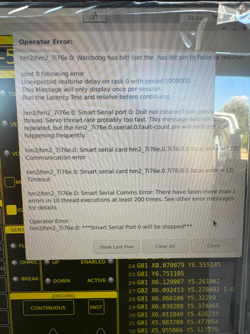

qtplasmac (Operation Error: hm2/hm2_7i76e.0:) in middle of cut

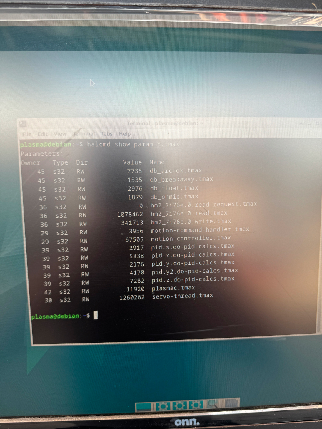

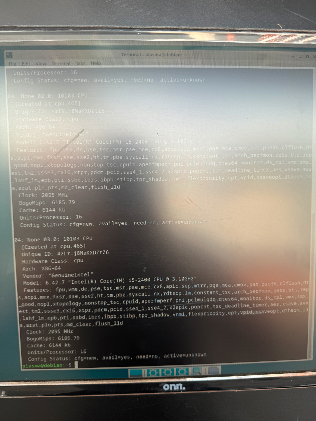

29 Jun 2024 02:43 - 29 Jun 2024 02:53 #303998
Replied by PCW on topic qtplasmac (Operation Error: hm2/hm2_7i76e.0:) in middle of cut
"Watchdog has bit" usually means really bad latency (>5 ms)
Running
halcmd show param *.tmax
in a terminal when LinuxCNC is running
will give more information
What is the host hardware and clock speed?
Also do you have all power management/turbo modes/speedstep
etc disable in the BIOS? Really bad latency is quite often related
to CPU power management.

29 Jun 2024 20:15 #304054
by RMJ fabrication
Replied by RMJ fabrication on topic qtplasmac (Operation Error: hm2/hm2_7i76e.0:) in middle of cut
- Posts: 18105
- Thank you received: 5328
29 Jun 2024 20:22 #304055
You need to disable turbo boost, C states > C1 and speed-step

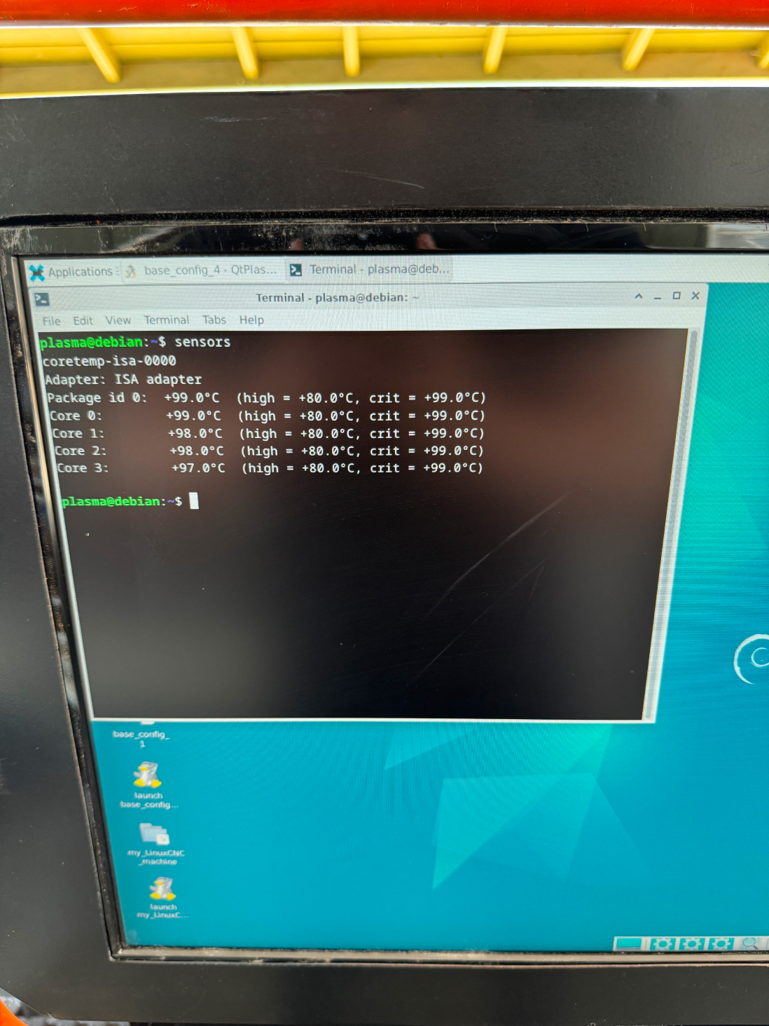

- Posts: 21985
- Thank you received: 7485
03 Jul 2024 22:12 #304344
Replied by tommylight on topic qtplasmac (Operation Error: hm2/hm2_7i76e.0:) in middle of cut
open a terminal and type
sensors
see what temperature the CPU is at while LinuxCNC is running, anything above 60 degree C should be mitigated by re-pasting the cooler or replacing the fan or with better cooling.
Some processors will handle over 90 degree, some Intel Xeons will throttle badly at 63 degree only!
sensors

08 Jul 2024 20:32 #304696
by RMJ fabrication
- Posts: 21985
08 Jul 2024 21:51 #304706
DAMN!!!!
That is 99 degree C all cores all the time, no wonder the PC is giving up it's ghosts, slowly and painfully!
The good thing is, you have it easy to remove the CPU cooler and clean both the CPU and cooler, then find some thermal paste and apply some to the CPU and mount the cooler back.
Tooth paste works instead of thermal paste, albeit for a day or two only.
