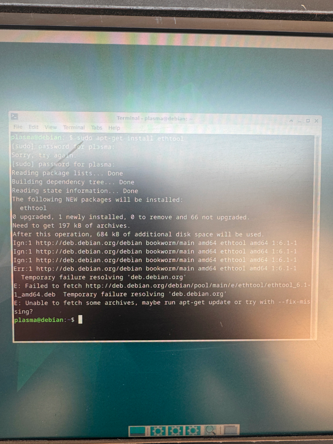

OK so ethtool is not installed
sudo apt-get install ethtool

14 Aug 2024 17:05 #307721
by RMJ fabrication
Replied by RMJ fabrication on topic qtplasmac (Operation Error: hm2/hm2_7i76e.0:) in middle of cut
- Posts: 21985
- Thank you received: 7485
14 Aug 2024 17:45 #307723
Replied by tommylight on topic qtplasmac (Operation Error: hm2/hm2_7i76e.0:) in middle of cut
On your screenshot, it clearly states to do
sudo apt-get update
and try again
Although, this being a networking issue, i have to ask:
-how is the PC wired to internet?
-If wired through cable, did you revert back the network settings?
sudo apt-get update
and try again

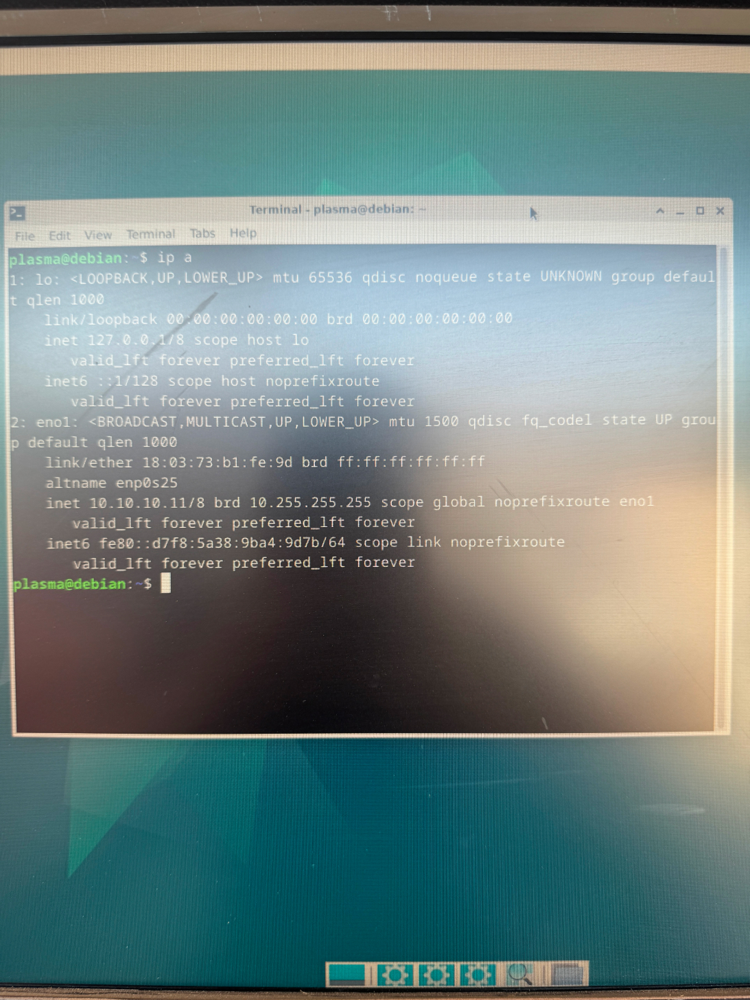

- Posts: 18105
- Thank you received: 5328
14 Aug 2024 17:58 #307725
Replied by PCW on topic qtplasmac (Operation Error: hm2/hm2_7i76e.0:) in middle of cut
Yes, looks like you have no network connectivity.
What does
ip a
report
What does
ip a
report
- RMJ fabrication
- Posts: 59
- Thank you received: 4
14 Aug 2024 18:27 - 14 Aug 2024 18:29 #307727
by RMJ fabrication
My computer is not connected to the internet and has no wifi should I connect to the internet and try again? I used a cable to do the installation and then I disconnected it to connect the 7i76e.
Last edit: 14 Aug 2024 18:29 by RMJ fabrication.

14 Aug 2024 19:13 #307732
by RMJ fabrication
- Posts: 21985
14 Aug 2024 19:16 #307734
Find a USB-wireless dongle and connect to internet.
