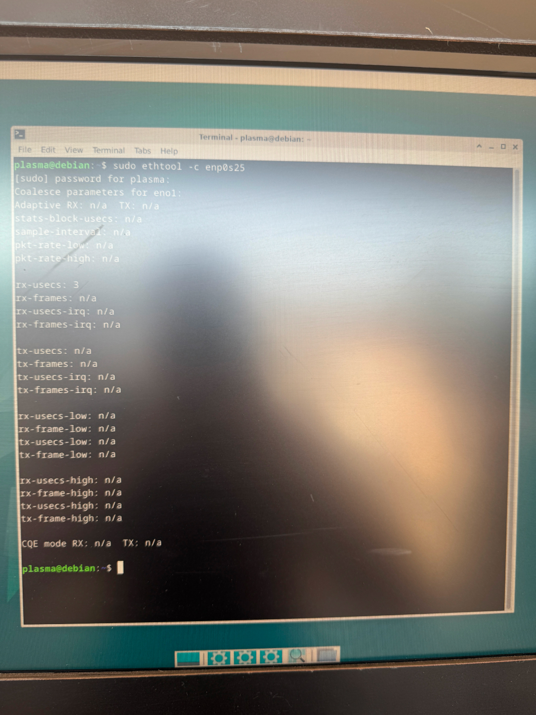

OK so it either did not work or you rebooted between
running:
sudo ethtool -C enp0s25 rx-usecs 0
and
sudo ethtool -c enp0s25
running:
and

I am a bit confused am I not supposed to turn off my computer ever or do I need to wait longer for sudo ethtool -C enp0s25 rx-usecs 0 to work?
- Posts: 18105
- Thank you received: 5328
20 Aug 2024 21:25 #308246
Replied by PCW on topic qtplasmac (Operation Error: hm2/hm2_7i76e.0:) in middle of cut
Will only work until you power cycle/reboot
but it should allow you to see if it fixes the problem
So I would try that, followed by a ping test
and then running the machine.
There are two ways to make the change permanent
1. Setup the Ethernet connection in the interfaces file
(and remove the setup created by the network manager GUI)

I cut a bunch of parts out using "sudo ethtool -C enp0s25 rx-usecs 0" and I did not get a single error when cutting this time. Everything worked how it was supposed to now I just need it to be permanent.
