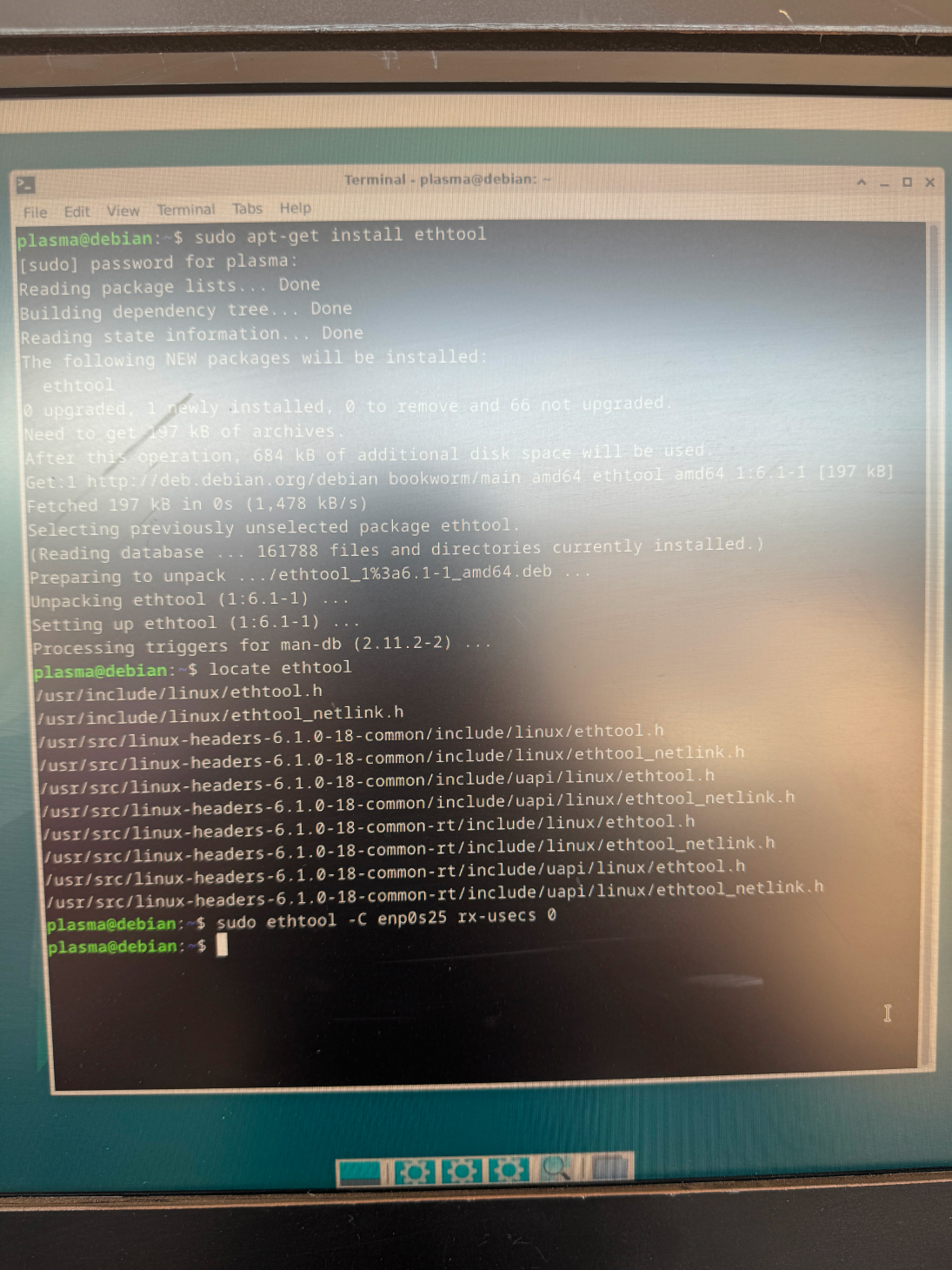

16 Aug 2024 17:27 #307946 by RMJ fabrication
Did I do these steps correctly? Do I have IRQ coalescing disabled now?
16 Aug 2024 18:27 #307951 by PCW
That should do it (until you reboot)
you can verify with
ethtool -c enp0s25
You might retry the ping test

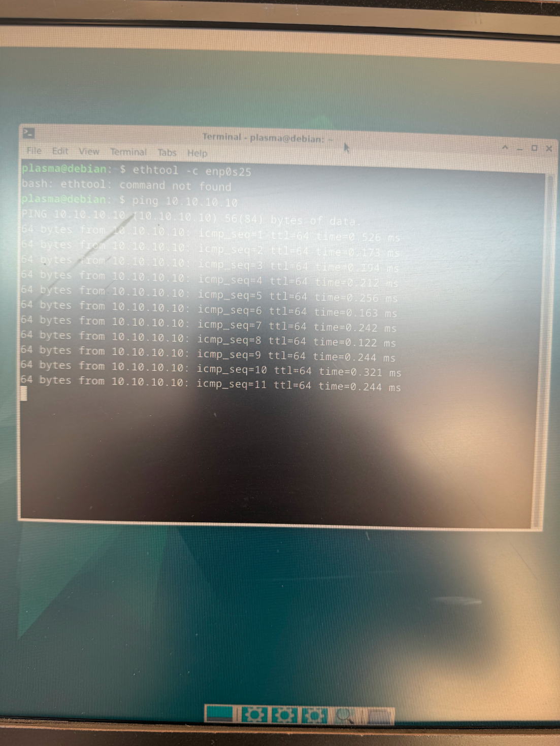

20 Aug 2024 15:39 #308223 by RMJ fabrication
I dont think IRQ coalescing is disabled I still get the error every time. How do I disable IRQ coalescing permanently?
20 Aug 2024 16:16 #308226 by PCW
Possibly the executable path is different for root so ethtool is not found unless you use sudo
so maybe try:
sudo ethtool -c enp0s25
to see if IRQ coalescing is disabled
